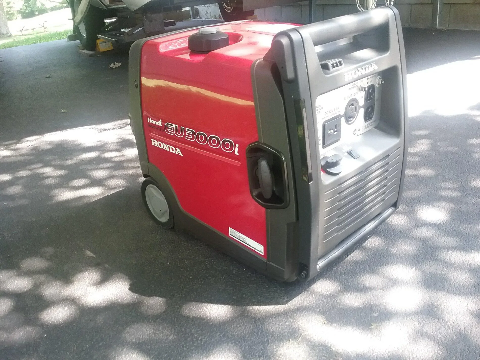

Jeep Gladiator What generator for a travel trailer and dry camping? Resized_20200810_114118_6707
I have the Honda Handi EU3000i. If your AC is 13500 BTU this is a great unit. When I got it new I filled the oil reservoir added gas and then pulled slow to prime it, you know to get the gas to circulate and it started!
It wasn't cheap.
It wasn't cheap.
This. Same one we have for our camper.
THE gold standard.
THE gold standard.
That one only has the 1.6 gallon tank that lasts about 7-8 hours, the 3000is has 3.4 gallons and last all day or night no problem, much better for dry camp and not having to get up in middle of night if running a 1500 watt heater. Having factory wheel kit is nice though depending where it needs to sit.
