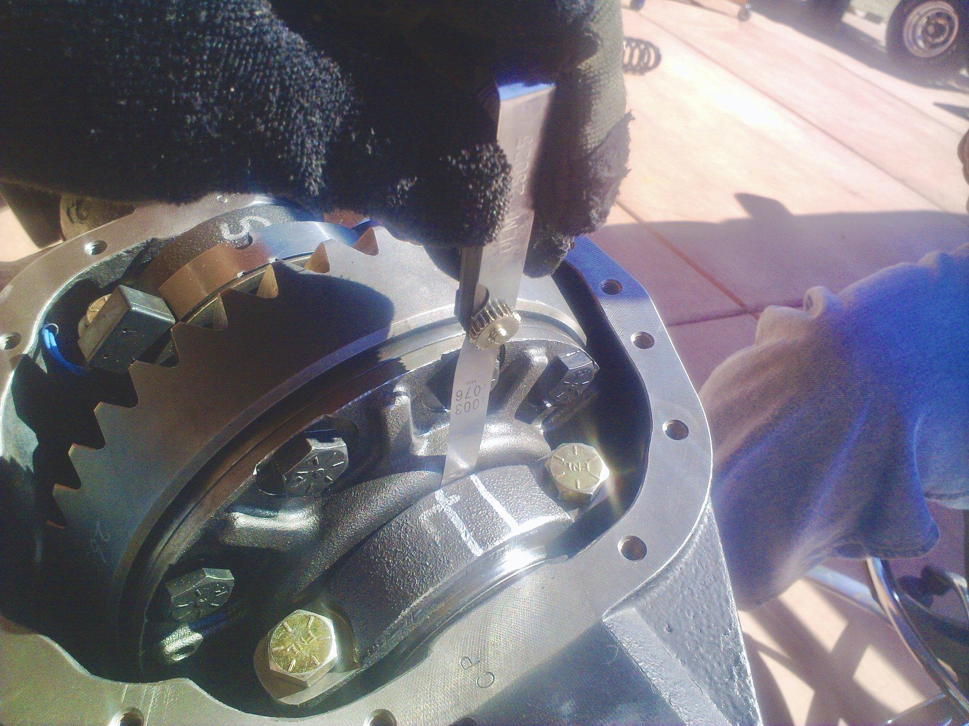

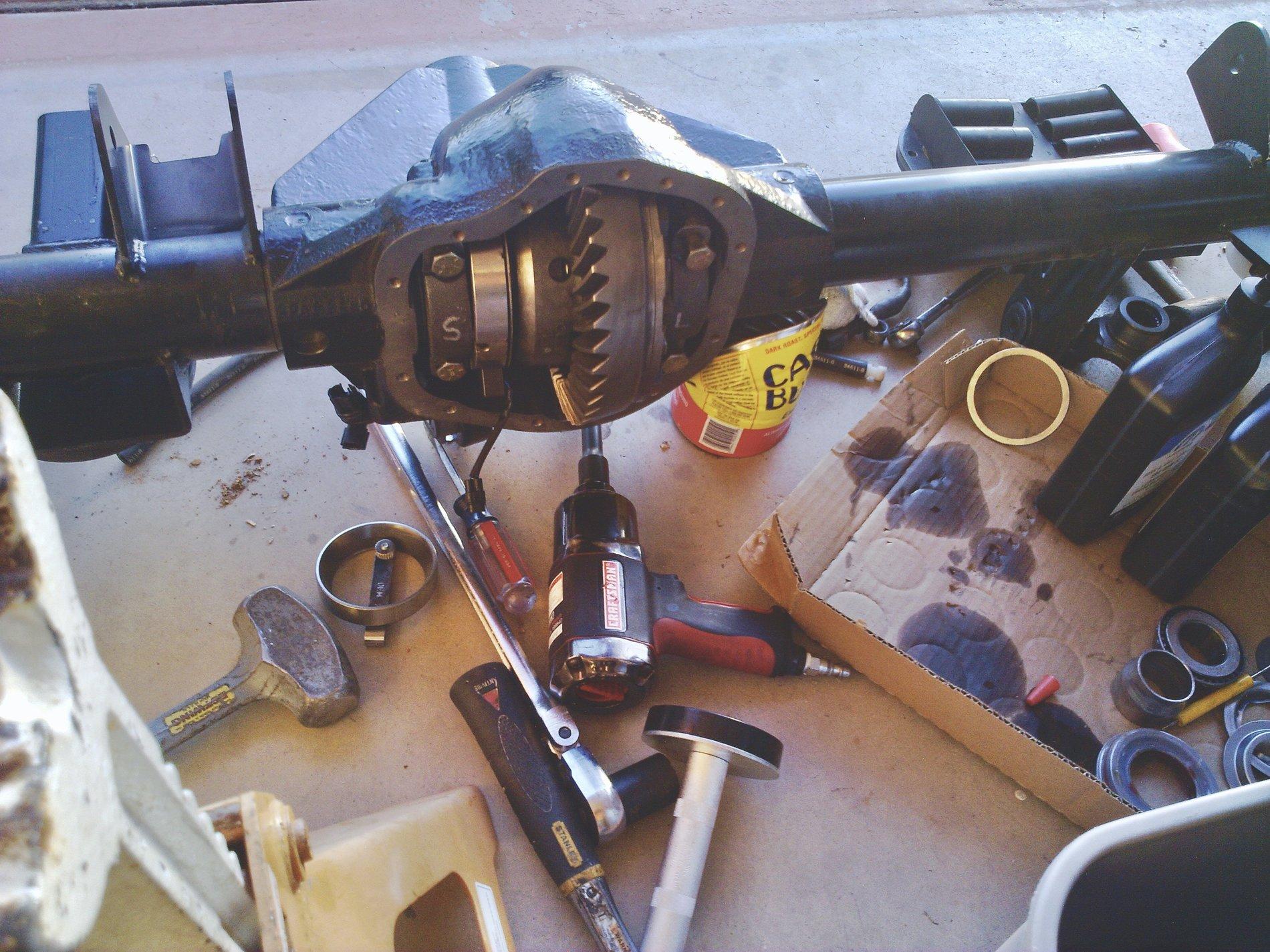

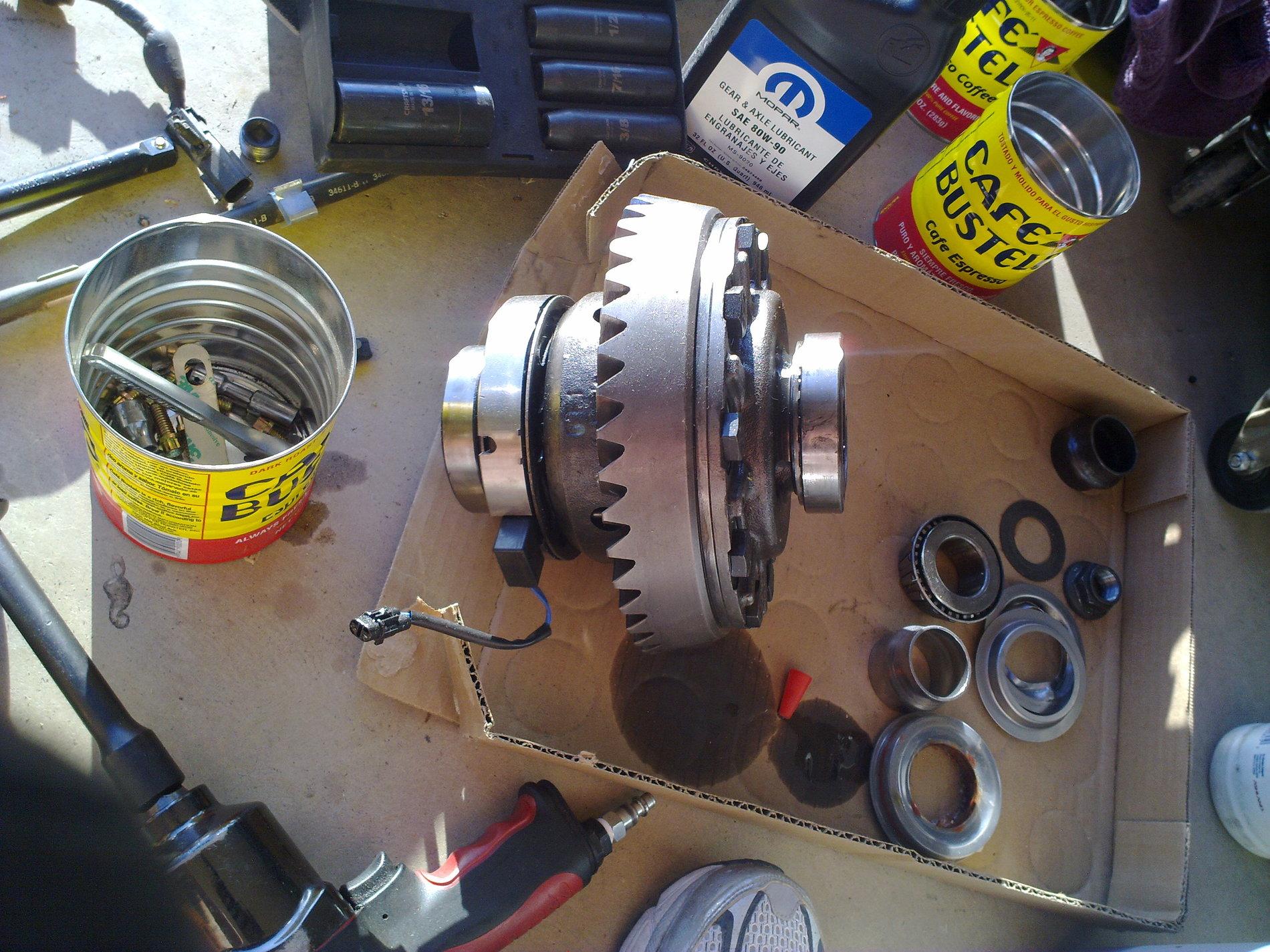

TO address your "HOW": This is a gear install on a JK Rubicon that wanted to run 37's so he made the jump to 4:88's.
