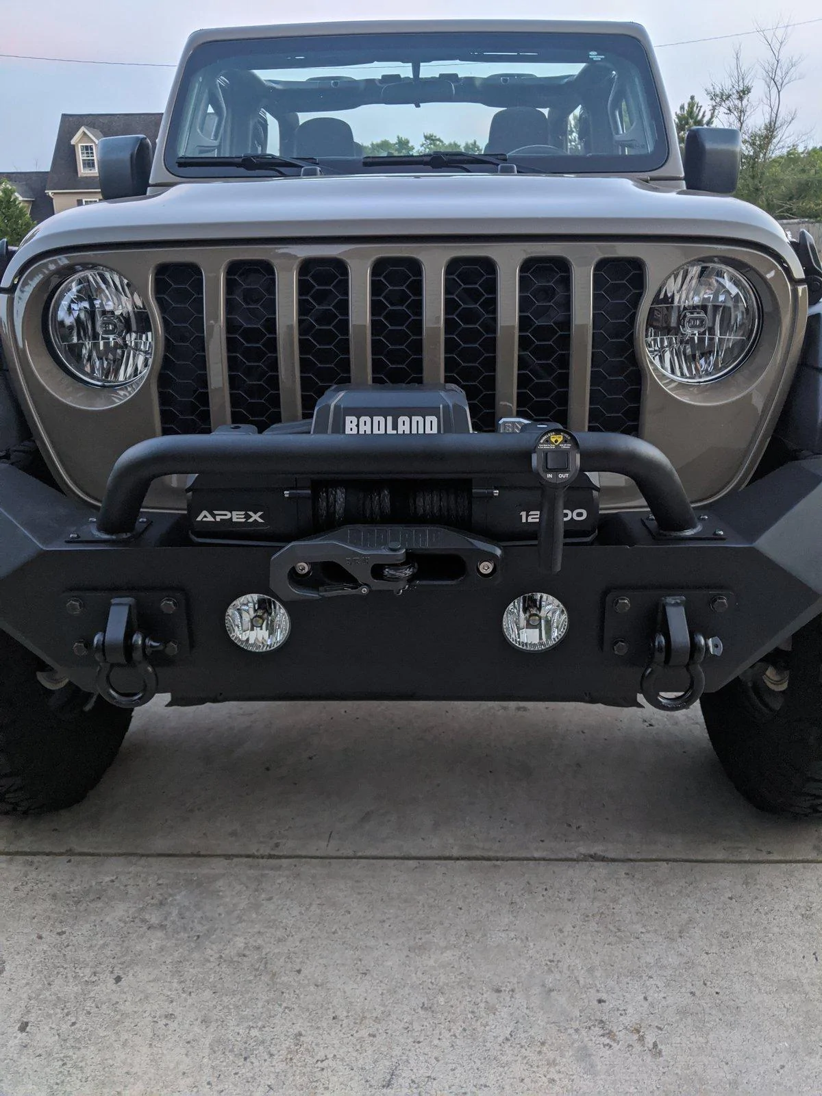

I vote for the Badlands Apex 12000lb winch. You can purchase the 2yr no questions asked warranty from harbor freight. It was easy to install and I love how it looks. I got mine for $400 bit it's normally $523 out the door with a wireless remote and it's submersible. Here is a picture, it's probably the best bang for your buck IMO. Synthetic line and weighs around 68lbs

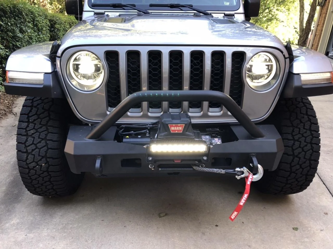

Warn 9.5XP is hard to beat for something the size of our JT’s...
