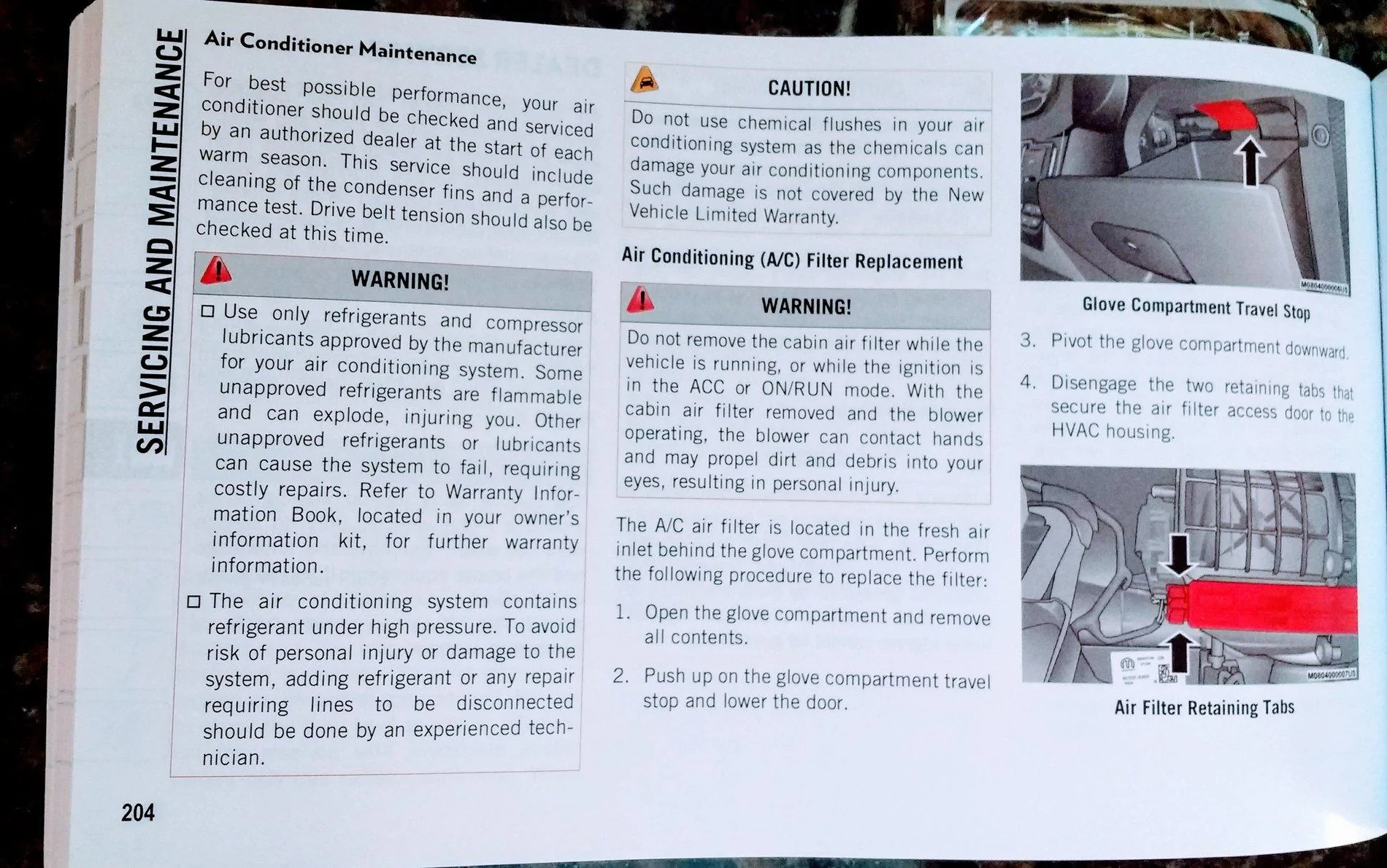

Selec Speed Control (SSC) for 4L. pg 204 in the owners manual.
So here's page 204 of my manual. It deals with the AC. I'd really like to read about it's function.

So can anyone post a pic of the section of the manual dealing with the function of the switch, since evidently it was not in the manual that came with the vehicle?

So my special order built to specs one week old vehicle evidently came with an old manual. But what the hell, I didn't even get a pigtail for the trailer brake plug in (which had always came with other trucks that I have ordered), so I guess they are just cutting costs and maybe customer service in the process.

Mine only came with booklet overview manual in print. The full manual is an app on the 8.4 Uconnect screen. The pdf on my iPad saved to iBooks is updated and easier to read in my living room.......
How many pages is your paper book?
