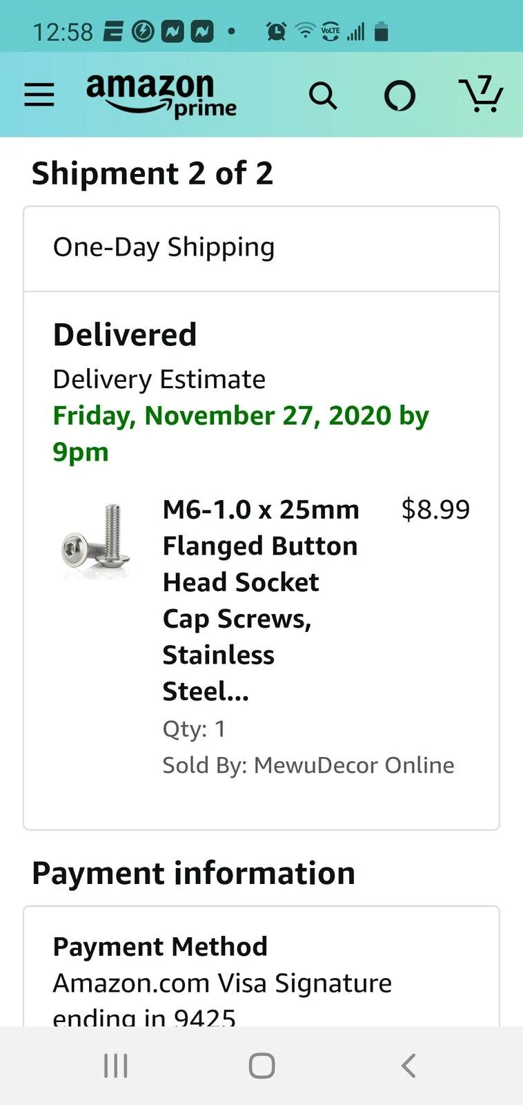

Do you have any pics of what you installed there? I was looking to install some add'l anchor points instead of putting in the entire trail rail system...
I just installed some stainless eye bolts I purchased on amazon.

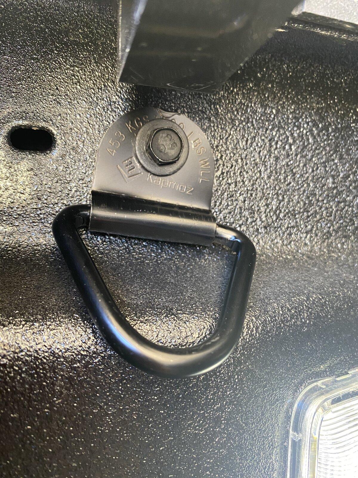

Trail Rail system bolts are M6x1.0 (4 per side and 4 along the front) this does not include the nut certs on the sides near the top of the tailgate. The front corner bolts use by the factory tonneau cover are M8x1.25. Hope this helps, length of bolts depends on your project.
Thanks!! I installed a couple tie down points and needed this exact information.
