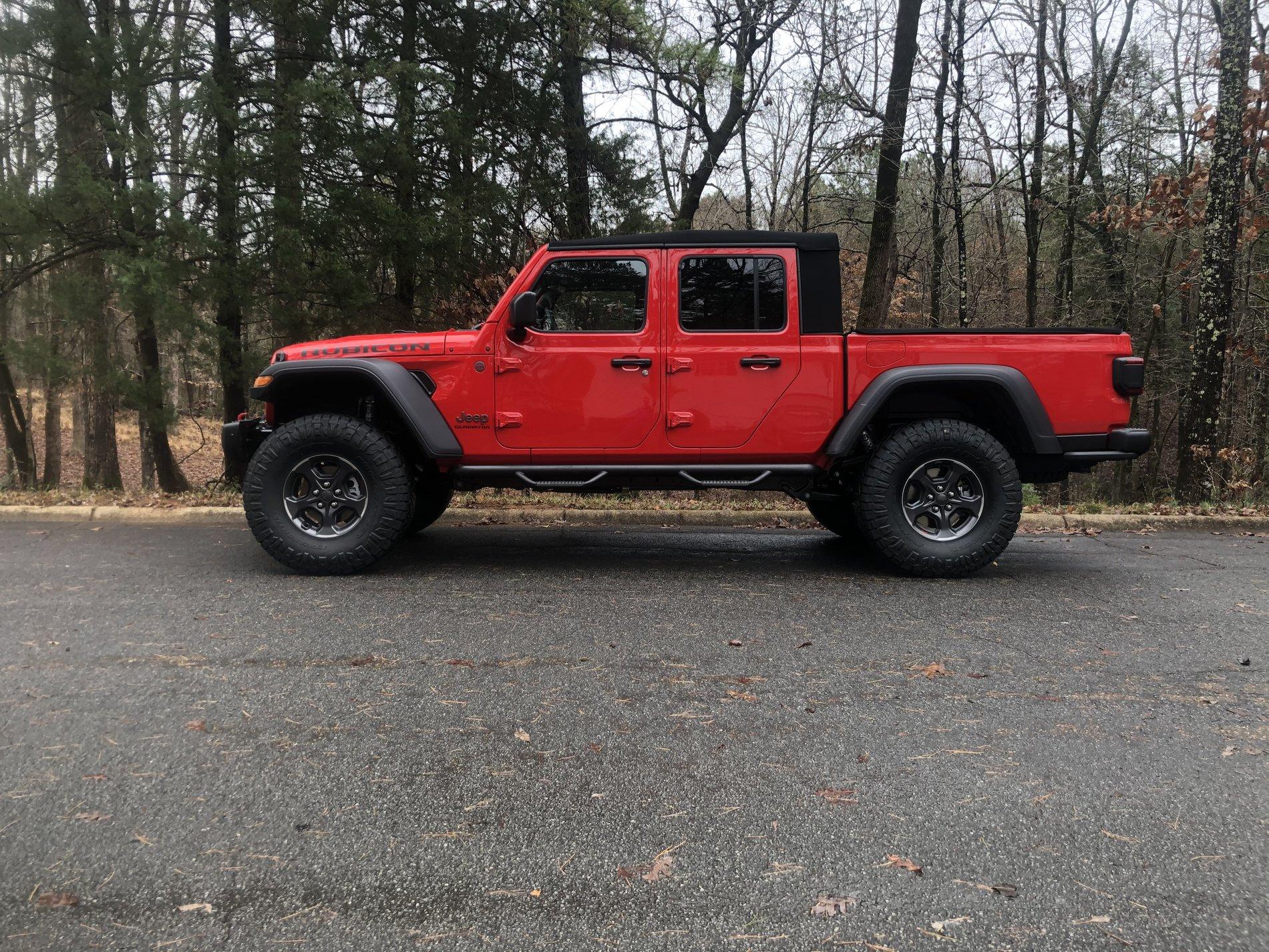

Armyman247
Oct 25, 2019
119
76
New Hampshire
Gladiator overland
I did the daystar 3/4” all around and I think it looks perfect gained 3.5” in front so once I add my bumper and winch and should drop to right where I wanted it

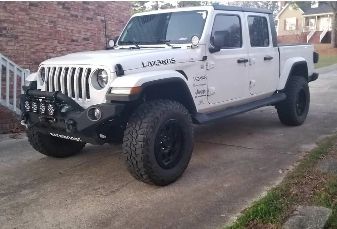

tysongladiator
Tyson
Jun 8, 2019
36
623
806
Florida
youtube.com
Jeep Gladiator, Jeep Wrangler
Learner
Added a 3/4" spacer up front because of the winch and heavier bumper. Changed out the cable from steel to synthetic to shed a few pounds.
