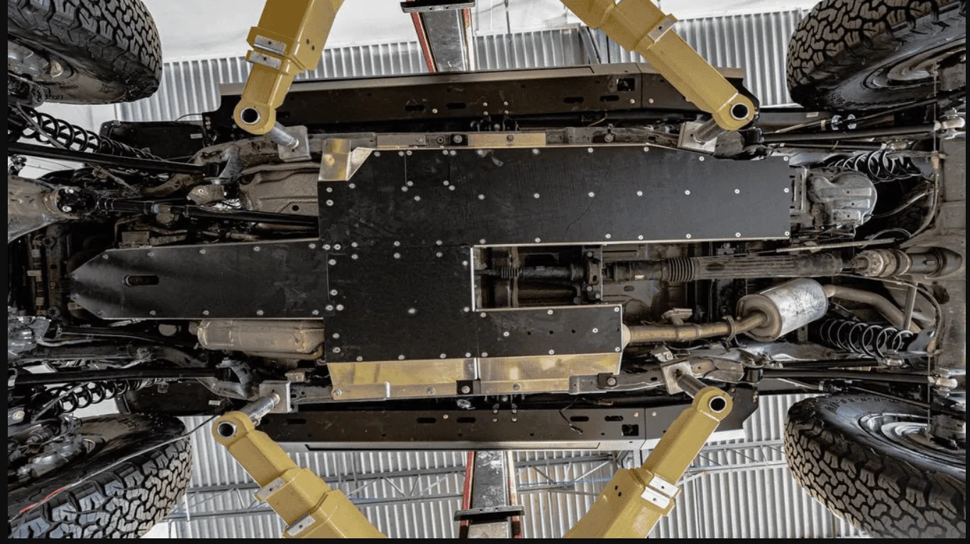

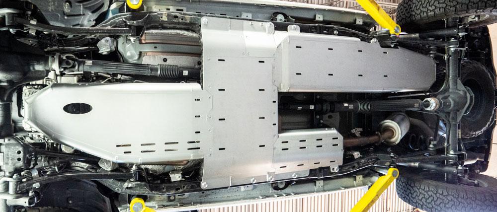

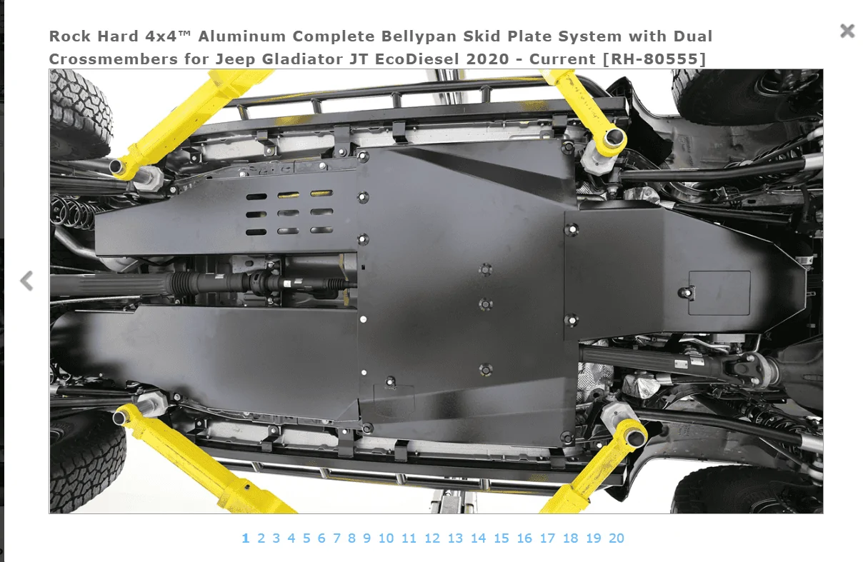

Here's Artec (Diesel):
NextVenture:
RockHard:
While mostly the same the Rock Hard/Next Venture offer a wider skid over the transmission/transfer case near the front. Rock Hard also offers more exhaust coverage.

No experience with their skids, however they are highly regarded I know. I looked at their setup for my 3.6 and it really came down to coverage for me, so here's the diesel bellypan's lined up:
NextVenture:
RockHard:
Rock hard is definitely the best exhaust coverage. But I’m guessing it’s a pretty hefty weight gain with rock hard. Are those aluminum or steel?
