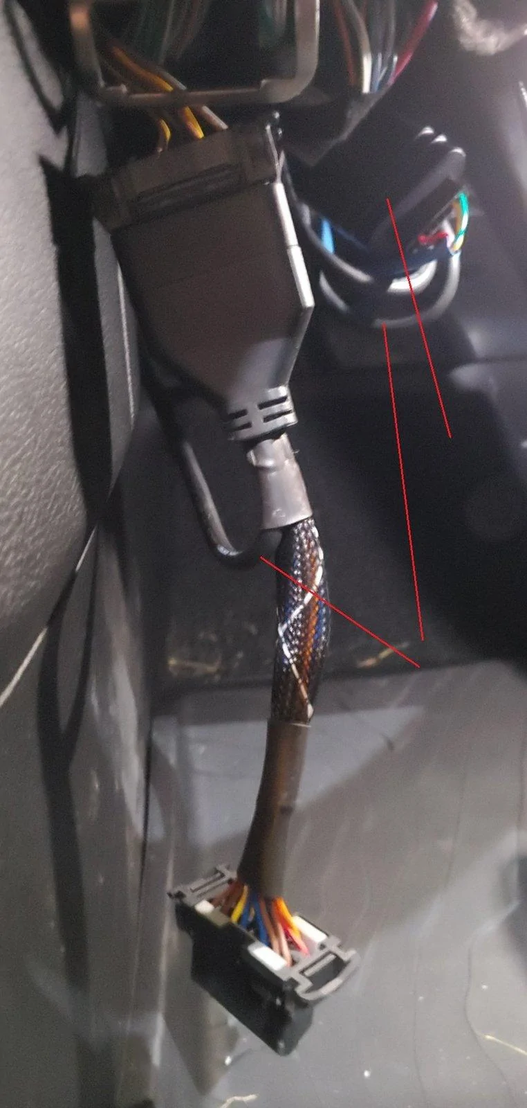

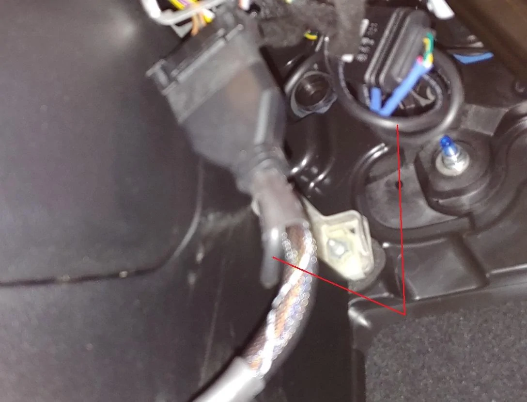

I posted in another thread that I had a sort of "rattle" and found it to be a hanging electrical connector. It looks like it should be in a bracket or holder, seen in the pics below. BUT, there's too much wire - it's awfully long and wouldn't be NEAT. It also doesn't look factory to me. I suspect the connector itself is a diagnostic connection since it's so handy............ but I'm suspect for other reasons -
First, the plastic connector end that looks like it would go into that bracket has a short pigtail plugged into it that extends that connection out and ADDS another small set of wires. The other wires are folded up and go to a small black plastic device that says "this end down" on one end. Then it's held up to another wire bundle with a black plastic tie strap that is not cut off neatly like the factory would do.
So there's a short extension with another wire that's folded up and strapped up with a plastic box.
It looks like they used some existing connector to plug in or connect another device, and also leave access to the original connection if that makes sense. Something has been plugged into this truck that I do not believe is factory.
I strongly doubt they'd wad up 18" of cable and strap it and a small device to another wire bundle under the dash. It's clumsy looking.
I am suspect it's some sort of add-in the dealer or someone did.
Please look very closely - if this ain't factory, it's getting unplugged pronto!
Further, I hate that wire hanging - yeah, I could just put the extra connector in the bracket, but there's still a whole wad of wire, and the extra length due to the piggybacked connection that doesn't have a good home.

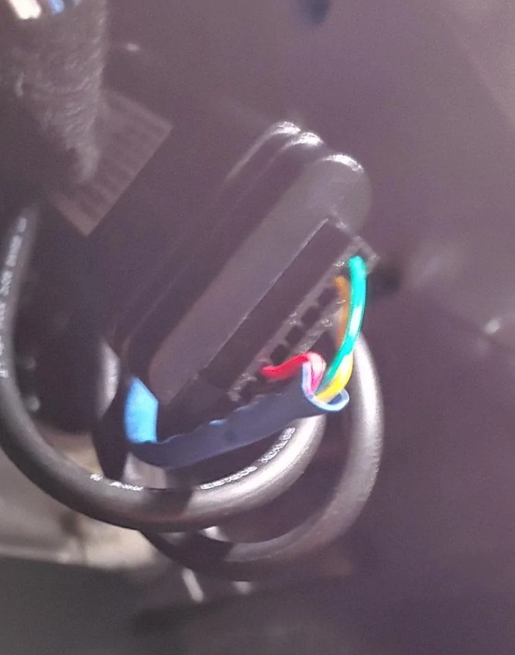

The extra added wire that goes from the extension up to the mystery device -

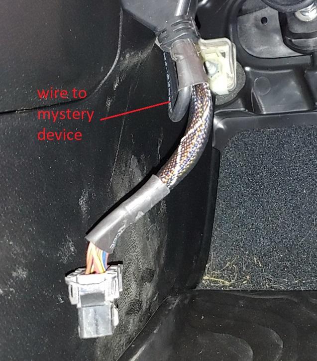

You may see here this is an EXTENSION to the original connector, with a wire branched off to that wad of wire and mystery device -
Jeep Gladiator What the heck is this mystery device? piggyback-4

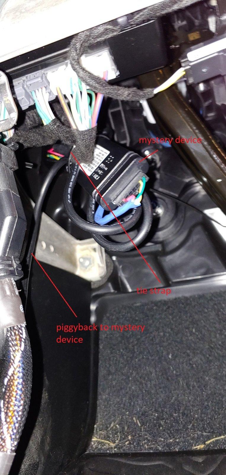

Better pic of the extension and piggy backed wire leading to the mystery device that's simply tie-wrapped up to another wire bundle, and it's wires all rolled up under the strap. Definitely not factory, IMO.
Jeep Gladiator What the heck is this mystery device? piggyback-5

Mystery device seems to have some labelling. Any chance you could get a clear picture of what's on the label? Perhaps there's a UPC, model number or such that would help ID it.
The phrase "this end down" makes me think of trailer brake controllers. More than one manufacturer makes controllers where you mount the button, knob, whatever, on the dash, and the rest of the guts out of sight. In the old days, brake controllers required secific oreintation to work. Just a stab in the dark...

I found discussion about this thing on the Wrangler side - it's a dealer installed GPS tracker!
Now WHY in the XXXX would the dealer put a GPS tracker on this truck?
I PAID CASH. There was never any loan on it for any reason. I took them a check for the full amount, paid for by selling my other truck, one of my cars and some I inherited from my father. Cash. No lease, no contract, no bank, no Chrysler Credit.
There's no brake controller as FCA still doesn't have their act together on that.
I found it's inline with the OBD port - I thought I recognized the connector.
OK, questions now are -
Why would a dealer put this in the truck?
Why was it NOT MENTIONED?
Is there any reason to leave it ? The wires are clunky and in the way and the connector doesn't stay nice in the bracket with all that extra BULK.
Will the FCA GPS cops come for me?
Am I correct in that this is a dealer installed GPS tracking device?

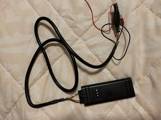

Here's one that someone removed from their Wrangler -

That sir is an ELOS GPS tracking device installed by your dealer and probably listed in your addendum. It hooks inline with the obd2 port. Some dealerships install them for tracking their inventory and for recovery in some cases if they pander to high risk buyers. You can and should disconnect it in my opinion.

Here is the one I removed from mine. It was not the OBD2 model it was hardwired into the hot lead but you can see it is the same thing.

I disconnected mine after the first night it came home. No GPS police yet because there is nothing in my finance agreement that states they are going to track my vehicle or did I agree to it. But many dealerships do install them for the tracking purposes previously mentioned.
