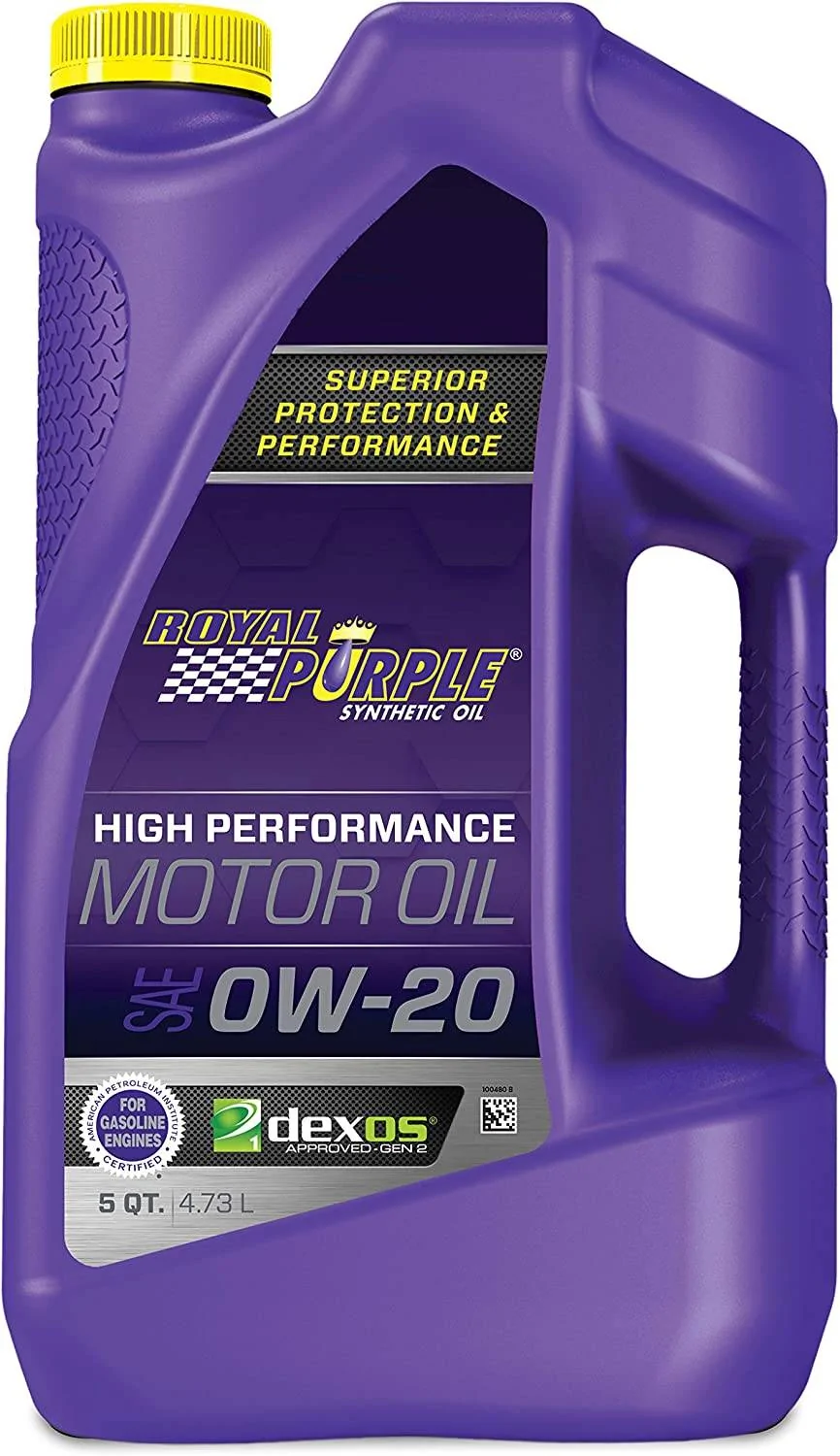

Before I did an oil change in my JT my running oil temp was 295°F-334°F. Previous owner used regular oil in this JT.
At 44,000 miles I changed to 0w-20 Royal Purple premium full synthetic oil. Running oil temp now 170°F-204°F. My coolant and transmission temps are running cooler also. I have noticed a 3-5 mpg increase from this.
I have been using Royal Purple in other vehicle's for years now and have had the same results.

It's a pretty low rated oil for longevity, though.
What do you mean "used regular oil". He can't have used non-synthetic and still matched the viscosity needs. The oil used in these only comes in synthetic or partial synthetic, not in non-synthetic.
I can't see running oil at that temperature and not having trouble. I've not seen these ever even coming close. If I saw oil temps over 250 I'd be looking really hard at a reason.
That's WAAAAAY over oil that's too hot! That's more than 100 degrees too hot.
With the oil the dealer uses, mine runs in the 180-220 range, that's just normal.
Royal purple ain't responsible to lowering oil temperature by more than 100 degrees.
I ain't buying what you are selling, sorry. No way in hell a different brand oil will drop oil temps 100 degrees, just ain 't happening. It's laughable. It's plain not possible. And if you saw oil temperatures that bloody high, why didn't you find and fix the trouble?
Even changing viscosity a notch or two will only make about 10-20 degrees difference.
(and after my research, that's an oil I won't use)
Unless the prior owner was running 5w30 or similar, he wasn't using "regular oil" whatever that is.
Even at that - it won't cause oil that hot.

Yeah, sorry - that's an oil waaaaay down on my list of what I'd run. It just doesn't have the high temp abilities or the ability to stand extreme pressures, making me concerned about using it on flat lifter engines, or our 3.6 because at high lift mode, it's the same thing as a flat tappet sliding on a standard cam. It's a lot of pressure and wiping action.
The rubbing follower when not on the rollers is actually, IMO, worse than the lifters rubbing on a cam in one of my cars.
Pennzoil or Mobil 1 or AMSOIL (not necessarily in that order) would be my top choices, Quaker State is up in the top for handling pressures and wear resistance.
Everyone has their favorites, sometimes what was best years ago just hasn't kept up, and what people disliked in the 1990s is a top oil now. Things have changed.
