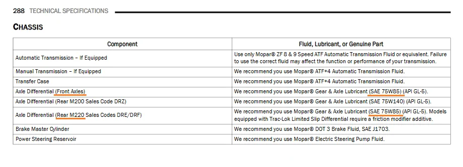

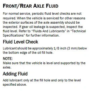

The oil weight information you are looking for is in the Owner's Manual. It is 75W85 synthetic for the front axle & M220 rear axle. If you search around a little on the forum, you will also find the listed capacities for the M210 and M220 differentials on the Rubicon. IIRC, it's 1.53Q rear and 1.09Q front. Regardless of the quantity, per the Owner's Manual, make sure to fill to approximately 1/8" below the bottom edge of the fill hole with the vehicle on a level surface. Always fill to the proper level regardless of capacity listed.
There is typically no issue using a 75W90 synthetic gear oil in place of the listed 75W85. After all, the 75W85 is listed as a "recommend" and not "require". The 75W90 will maintain a higher viscosity at high temperatures, which (IMO) is only a good thing. However, changing from the recommended 75W85 is a decision for you to make.
This is from the on-line version of your 2020 Gladiator Owner's Manual:
