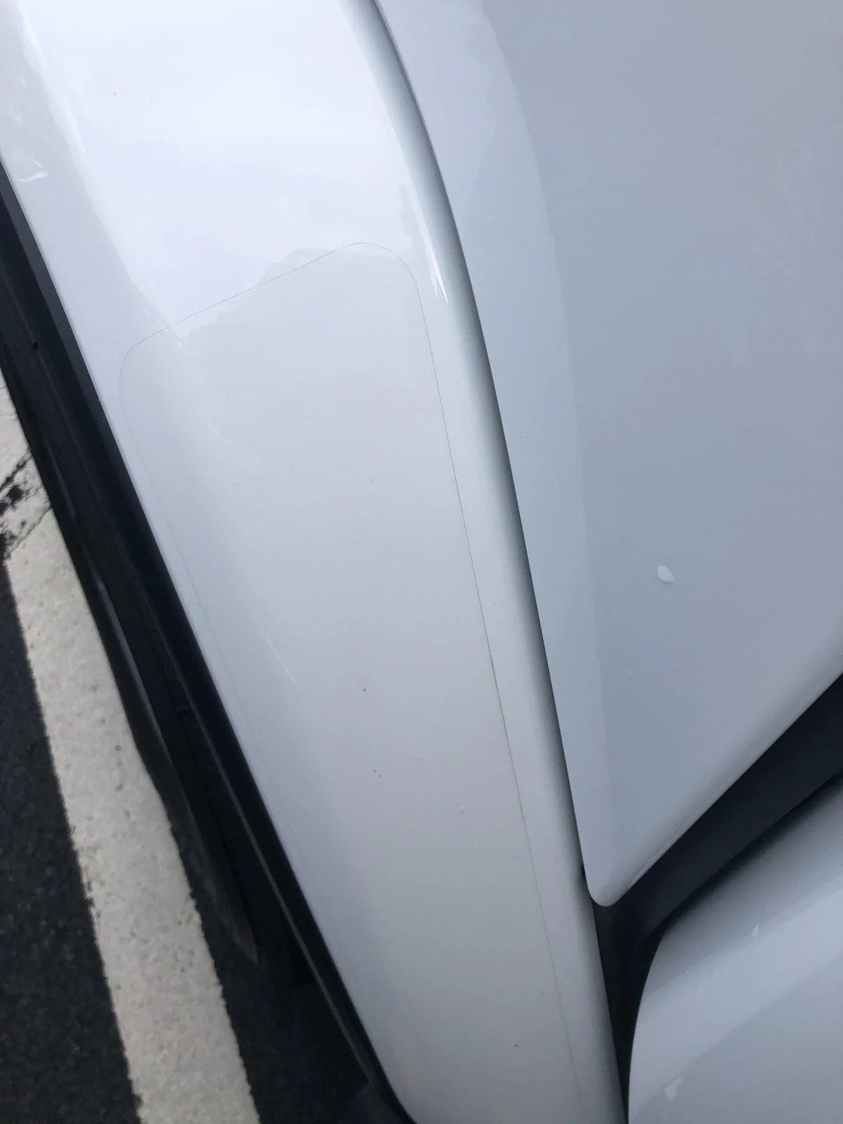

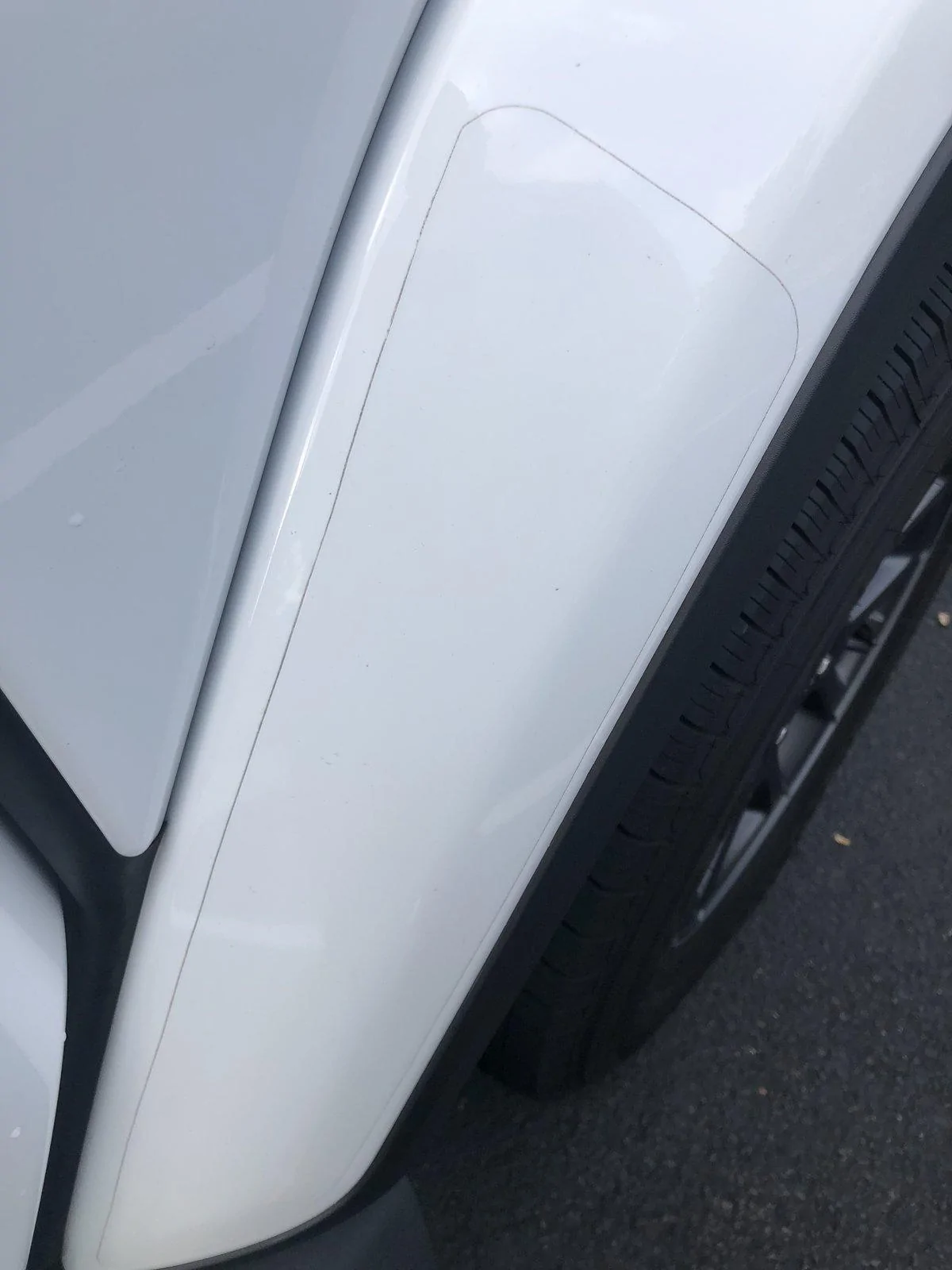

So I bought my JT mid in May, and there was some minor damage in transport to the back wheel well.
The dealership fixed it, and did a so so painting it, and I’m almost positive they didn’t use replace the clear wheel well protective with one from the factory.
The original one on my passenger side feels thicker and doesn’t pick up any dirt on the edges at all.. The new one is getting a ton of dirt on the edges.
The dealer is like 2 hours from me, so I’m not sure I want to go there to bitch about it picking up dirt and make them fix it...but aggravated out of principle.
Can I fix it myself? Would you make them fix it?

Buy come clear chip tape, available from amazon, cut to shape, remove old chip tape, clean the area with some alcohol, using alcohol water mix wet the area well, remove the chip tape from top towards the bottom using a plastic application took slowly apply the chip tape while slowly removing the tape backing make sure you do not get an air bubble by keeping the area moist you can slight adjust the tape
postion.

I agree if you want to replace it but try the alcohol and water solution with an old soft toothbrush to gently wet and brush around the edges to remove the dirt and excess adhesive...that is what is catching and holding the dirt there...should not be a problem after that...
make sure you put a light coat of synthetic wax on it as the alcohol will strip any protectant (wax) off of the paint

What I would do is peel all the clear tape off both sides and rub with alcohol to eliminate goo. Drive the truck. When the body-color flares eventually chip, replace them with black ones.

Painted fenders are gonna get wrecked by rocks. Just leave that there till they do and then paint and replace it

I wouldn't worry about it since even the thicker 3M product will chip if you plan on going off road. If it does concern you go over to Amazon and buy a roll of 3M for less than $20. You can also use it for your door sills, foot wells, and other exposed areas too.
