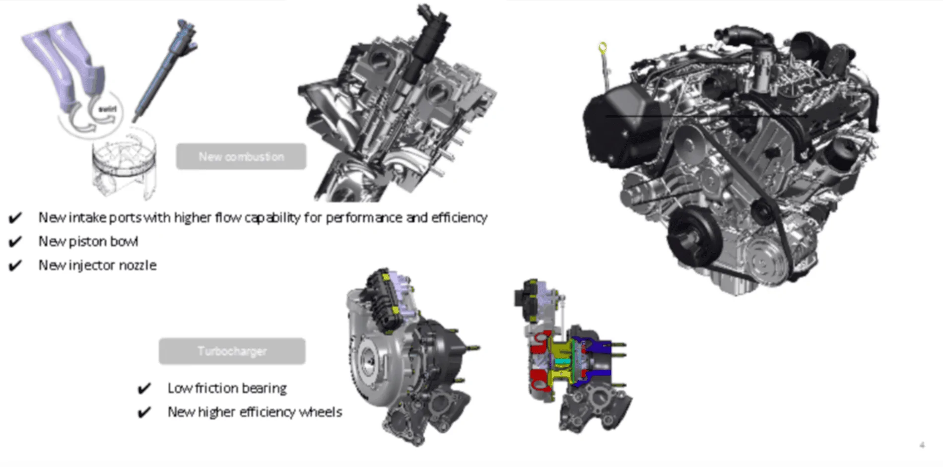

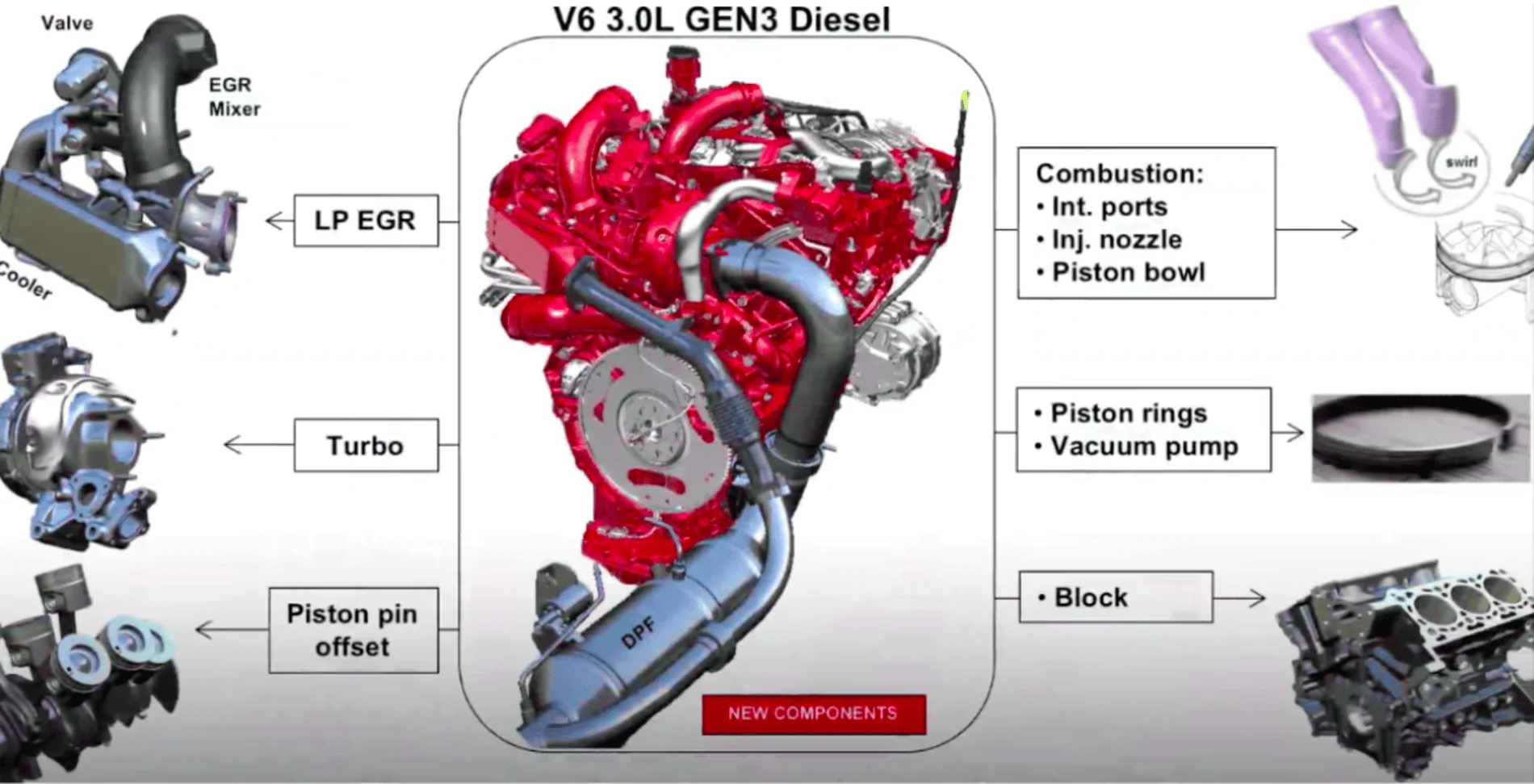

Compared to the last-generation 3.0-liter 60-degree V6 diesel, Ram says 80 percent of the latest millā€™s parts are new, with the motorā€™s chief engineer Mauro Puglia highlighting a few major changes for 2020. The most important one involves exhaust gas recirculation, or EGR, which is a system that reduces NOx emissions by sending mostly-inert exhaust gas into the combustion chamber, reducing combustion temperatures.

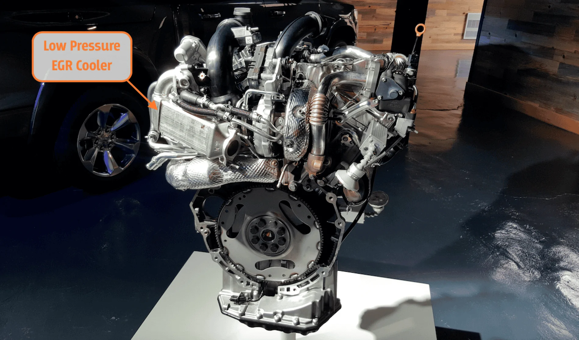

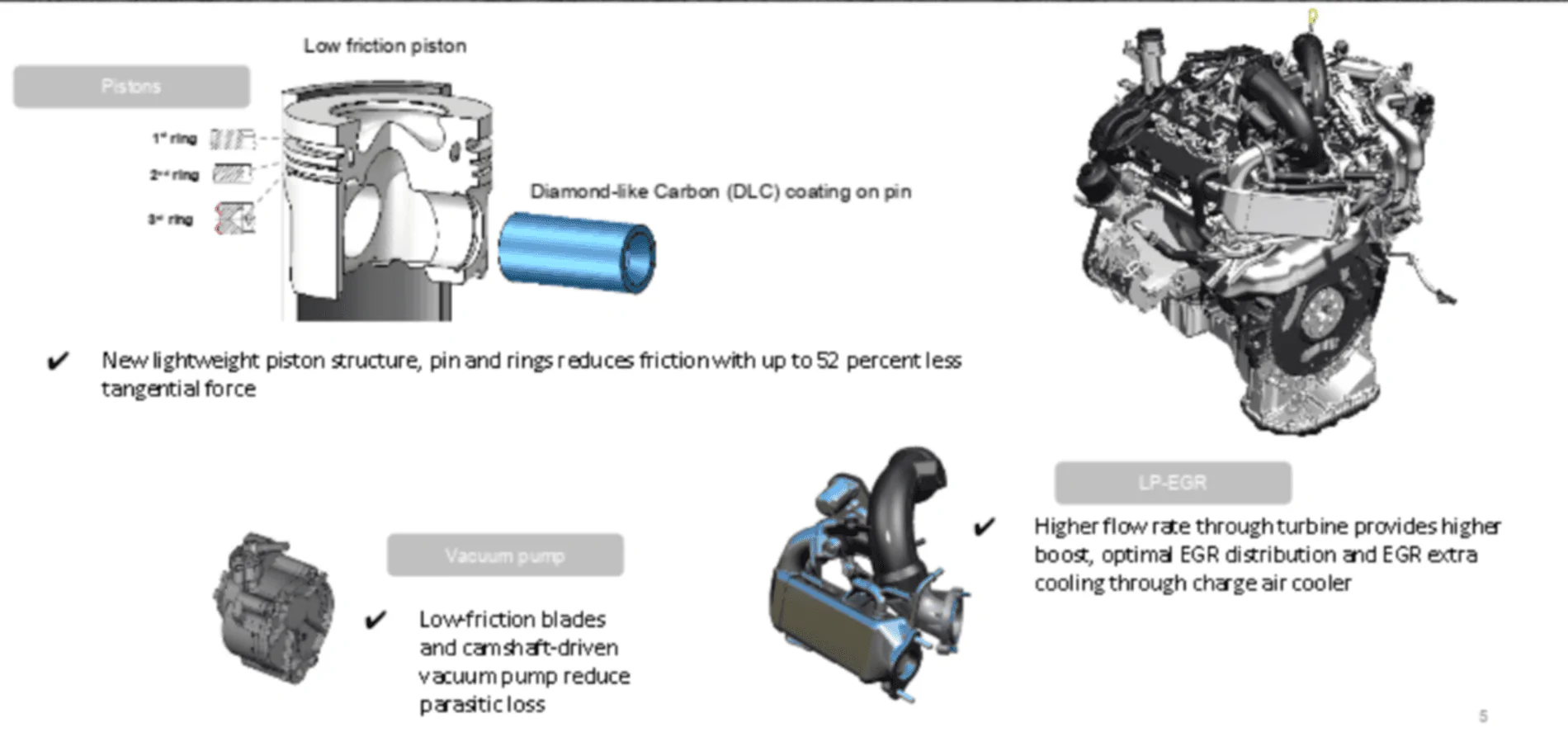

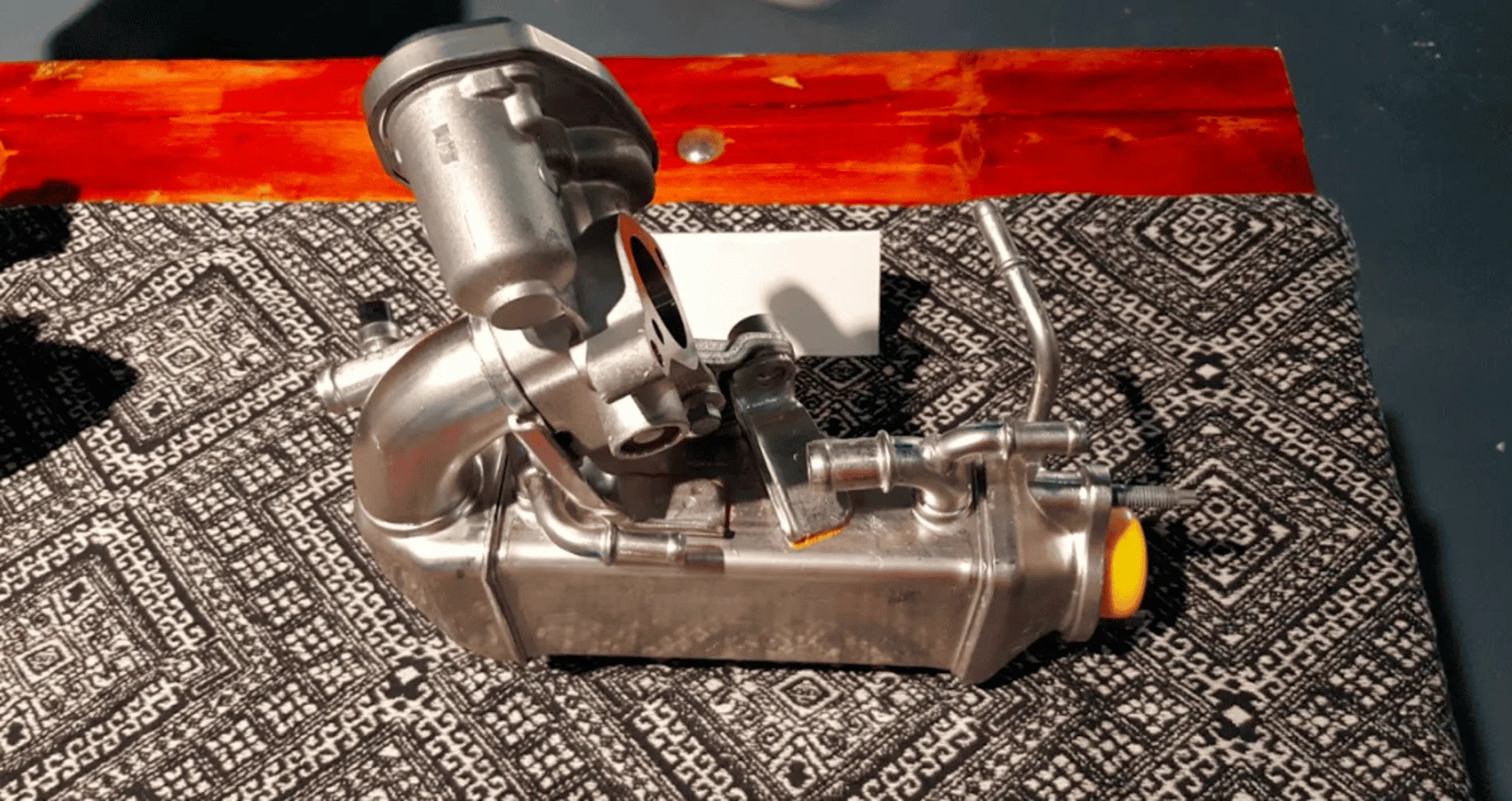

For the new Ram, the third-generation EcoDiesel engine gets a low-pressure exhaust gas recirculation system. So, in addition to taking exhaust manifold gases and feeding them through a cooler and into the intake, as in the high pressure system, the new Ram pulls exhaust from after the diesel particulate filter and sends it through a cooler to the intake. The point, Ram says, is that instead of having to rob exhaust gases used to spool the turbocharger, the engine can snag exhaust post-turbo turbineā€”a setup that Ram says yields ā€œimproved fuel economy and lower oxides of nitrogen (NOx).ā€
Hereā€™s a look at the low-pressure EGR cooler that reduces the temperature of exhaust gases prior to sending them to the intake:
Other changes to the diesel engine include a new generation variable geometry turbocharger with allegedly lower friction bearings, promising better efficiency and response; redesigned intake ports for better airflow; a lower 16.0:1 compression ratio from 16:5, which Ram says helps reduce NOx; redesigned fuel injector nozzles; and updated bowls on the aluminum pistons, which have thinner rings and specially coated side skirts and wrist pins for reduced friction.
On the noise, vibration, and harshness front, Ram mentions that offsetting the wrist pin from the connecting rod centerline by a bit made a difference in reducing piston-slap, and the brand also says a two-piece sandwich material of polymer and metal for the oil sump apparently also helps with NVH.
Other changes include a larger selective catalytic reduction system, less friction in the brake vacuum pump, and a change from a charge air cooler (or intercooler) that used to be mounted in front of the radiator to a ā€œlow slung CAC,ā€ as the chief engineer Rod Romain put it. This means the air meant to cool the water in the radiator doesnā€™t have to pick up heat from the intercooler first, thus theoretically improving engine cooling performance.

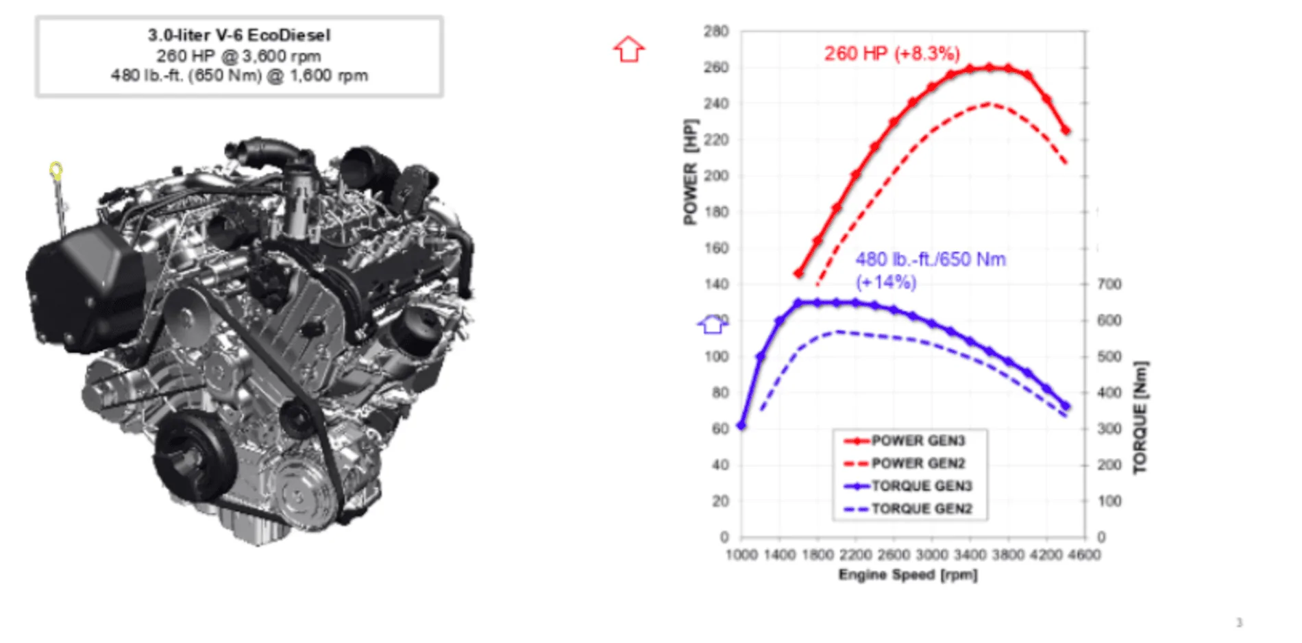

The Ferrara, Italy-built engineā€”which, like the outgoing model, contains a forged crank and rods, as well as a bed-plate to help handle stressesā€”now has a block that is reportedly 15 pounds lighter, though most importantly, the engine is more powerful and makes more torque across the rev range, per the output plot above.
