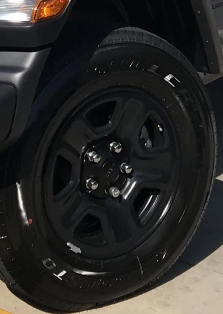

Rubicon Launch Edition wheels are different than Moab wheels. Different spokes and design.
All JT wheels are alloy, with the exception of the very base model Sport which are steel. All alloy wheels are 7.5" width and +44.45 offset.
The load rating is "proprietary or not known" according to FCA customer service.
180
29,544
35,144
That's where I got the steel wheel thought then - the base Sport. I knew there was a steel wheel in there somewhere.
Thanks

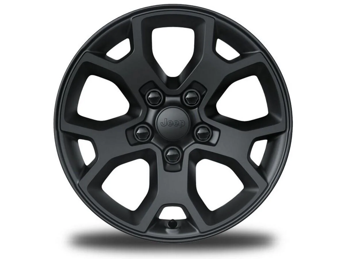

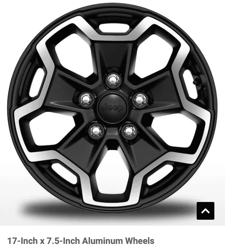

I thought the LE wheels were the same as the other wheels, they are very close. They look very close to the upgraded Rubicon wheel in gloss black.
Moab Wheel:
LE Wheel:
Rubicon Upgrade Wheel:
Renegade
Zac
Sep 11, 2017
3,562
4,694
Signal Mountain, TN
2020 JT
Moab Wheel:
LE Wheel:
They are similar, but not identical. Look at the casting of the center spokes.

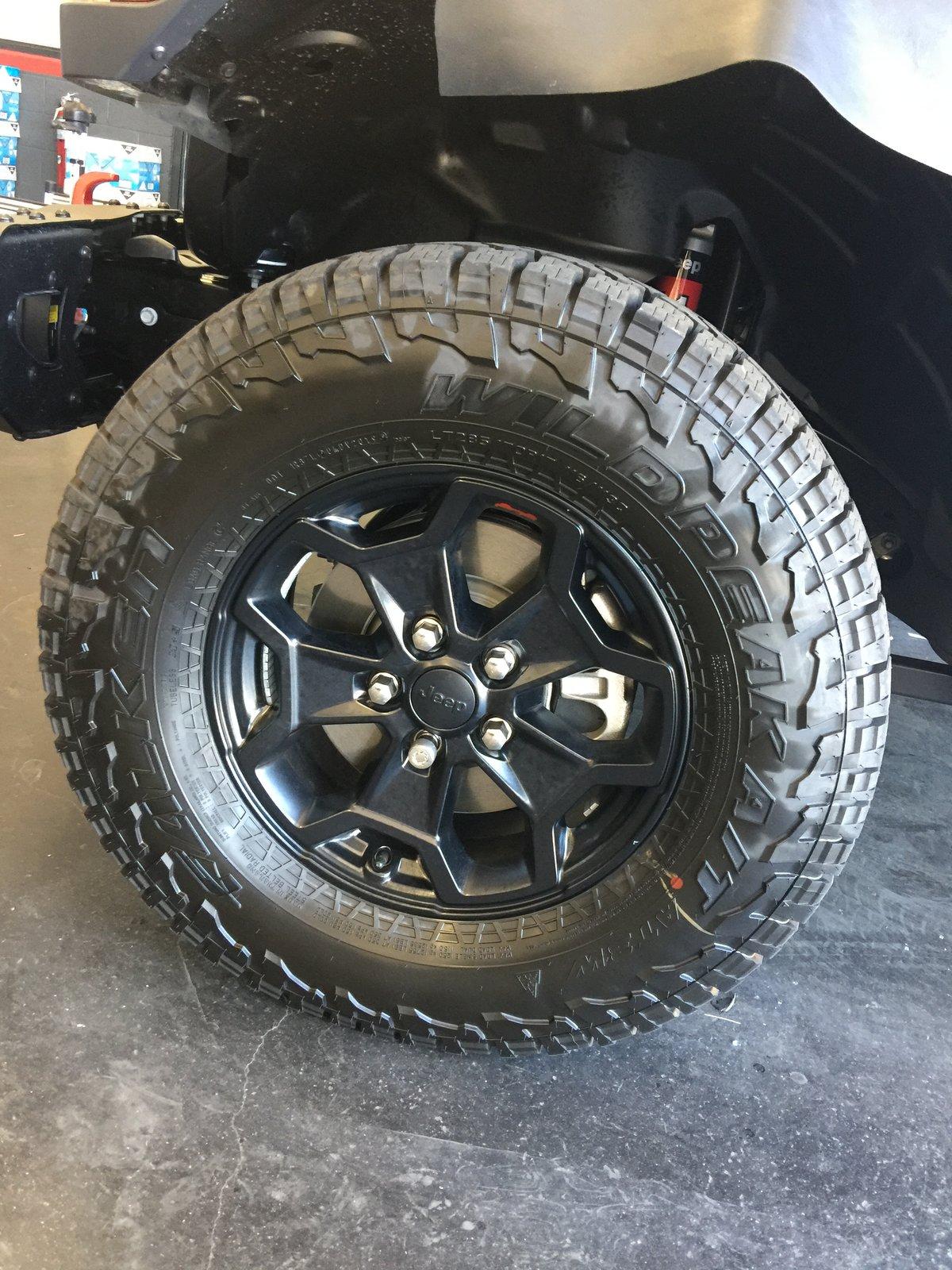

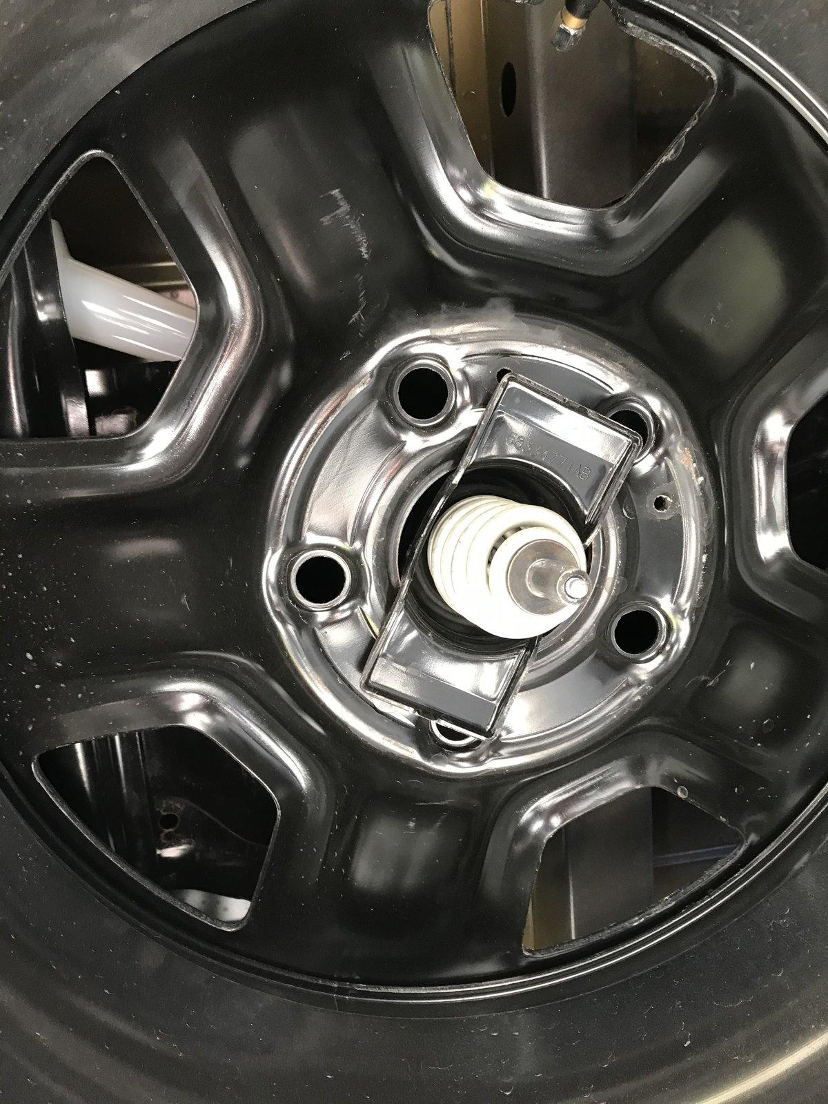

Just trying to get all the JT wheel options in one place...
the LE wheels look very close to the upgraded Rubicon wheel in gloss black.
Moab Wheel:
LE Wheel:
Granite Crystal Stock Rubicon
Overland Wheels and Tires
245/75-17 “31” Bridgestone Dueler AT’s on
Sport S wheels
base Sport JT standard black steel wheels.
base Sport steel spare mounted outside up.
steel spare provided with all trim levels
