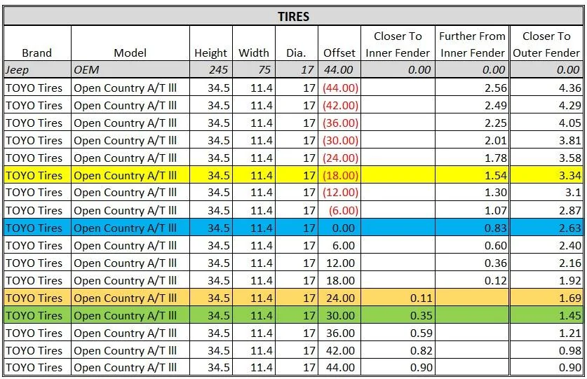

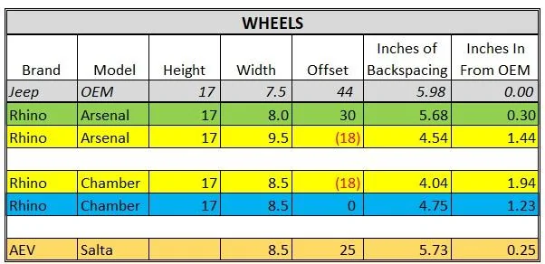

So I have been trying to wrap my head around tire & wheel sizing and have either got an idea or am totally lost. I used a wheel & tire calculator to get the measurements then put it into a chart based on the tire & wheels I am looking at. I am looking at TOYO 35x11.5-17 tires and various wheels. Tire chart shows measurements but the "closer to outer fender" is the main one. Wheel chart shows measurements but the "inches in from OEM" is the main one (that is the distance closer to the inner side of wheel compared to OEM). Last is the combined and is the total inches that wheel tire combo would come out toward outer fender over stock wheels. I am open to any input that will help me figure this out.
Jeep Gladiator Wheel & Tire Chart Tire Chart Jeep Gladiator Wheel & Tire Chart Wheel Chart
