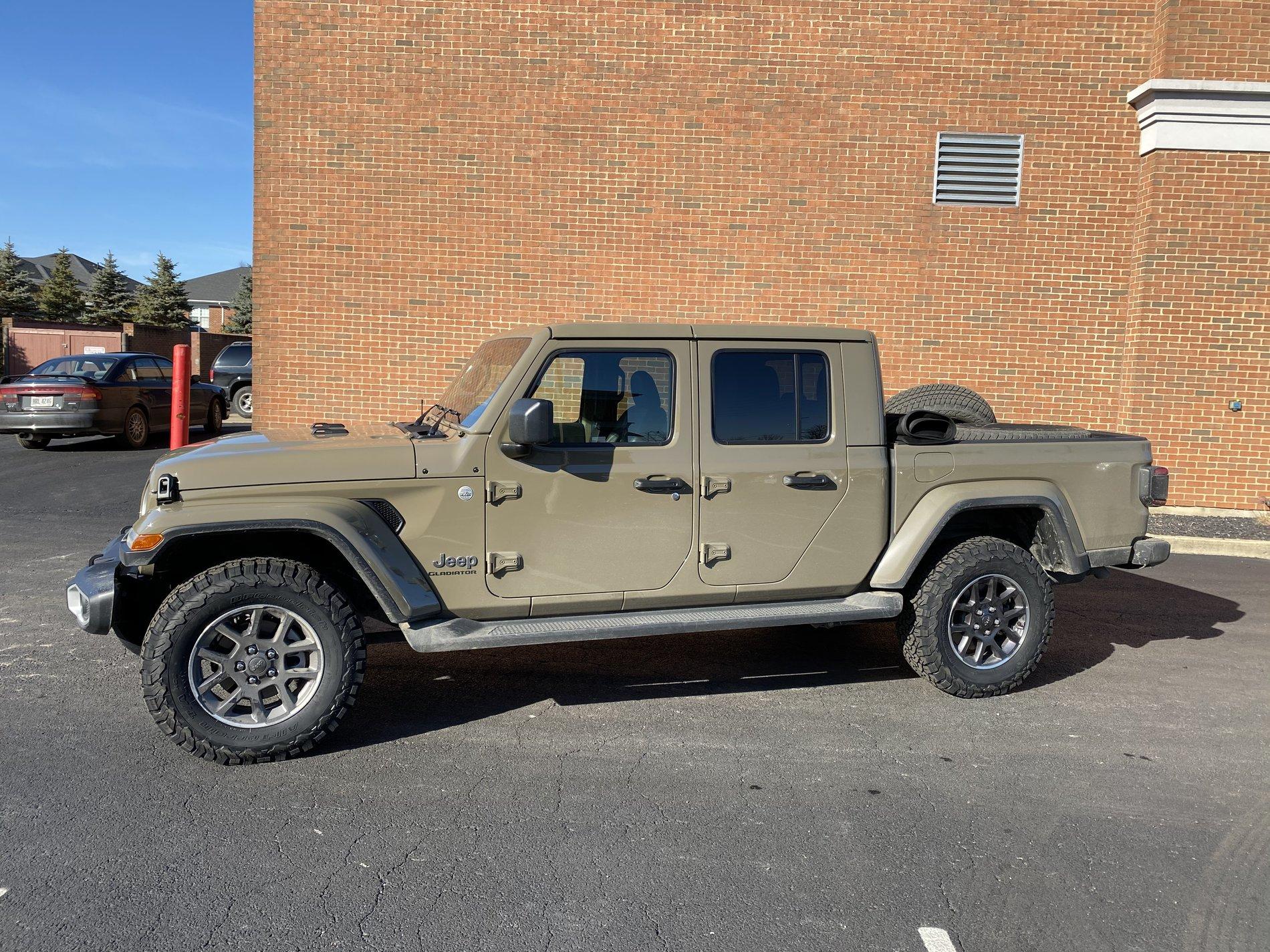

OK, quick question, why is it this hard to decide on a new wheel setup? What size rim, what size tire, what offset, etc.??? It was literally easier to name our children than picking out a new wheel setup. I have information overload from looking through all the threads here, and that's made this decision even harder! haha.
I have a Bright White Overland and just want that meatier/more aggressive look. Would I regret only moving up to 33" tires on 17's? Should I go 35" tires with 18's? Should I cross over to what some consider the "dark side" and run 35" tires with 20's?
Here's what I'm working with:
Jeep Gladiator Wheels?! Wheels?! Wheels?! IMG_2409
I know this has been discussed over and over and over...so sorry to clutter up the forum with yet another wheel question. I just had to get that off my chest (ha).
Thanks,
Ken

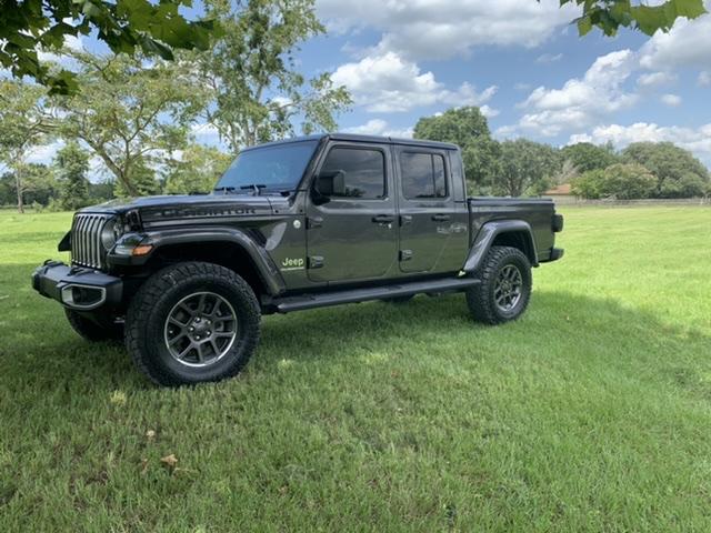

37x13.50 Kumho Road Venture M/T KL71 tires, wrapped around 20x10 MotoMetal MO970 wheels.
Wheels are 20x10 4.56" backspacing, -24mm offset.
