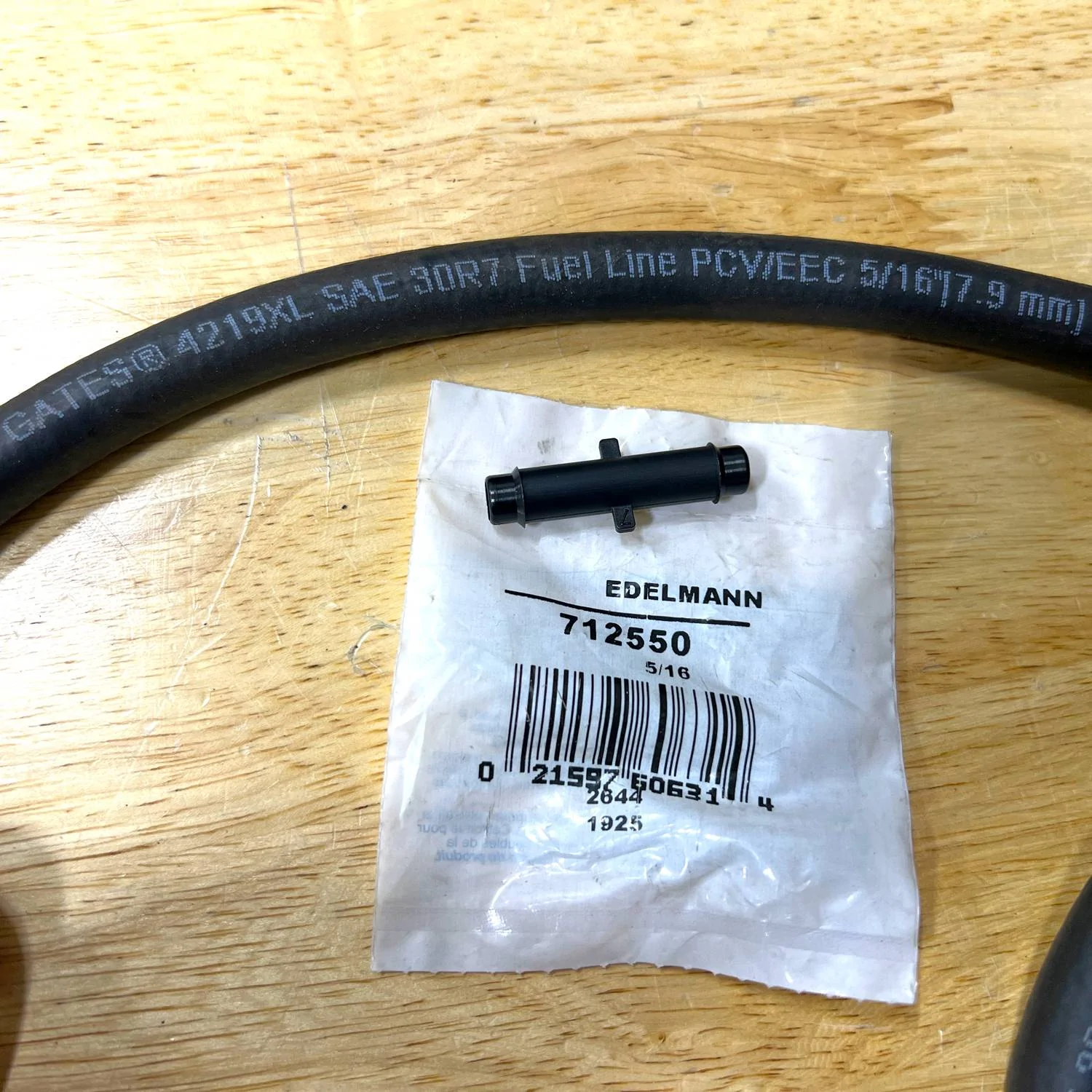

Do you offer the proper hose size/type on your site?
Tech Tim
Summit Sponsor (Level 3)
Tim
Jan 17, 2018
109
197
Poulsbo, WA
4x4 of all kinds
Sorry, we don't have them listed on our website.
In the shop and studio we use 5/16" fuel line and a 5/16" Edelman plastic coupler. We have the fuel line in a bulk roll and cut it to an inch or so over our lift height. Lift it 4", use a 5" piece.
You typically don't need an extension for a 2" lift or lower.
Jeep Gladiator When brake lines needed and bleeding process Vent-Extension
If you didn't want to use an extension, you could just pull the whole vent line and replace the whole thing a little longer than your lift.
