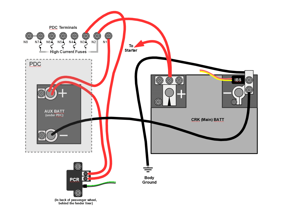

JT/JL/JLU is a whole different animal... What you know in regard to your lifelong vehicle battery related experiences, will only serve to help you try to get a handle on.. to try to understand the dual battery system, 12v battery related issues, etc. in regard to a JT/JL/JL.
Talk from about how the battery behaved in my VW, JK, Chevy, and is almost laughable. YES, there is such a major difference in comparison to your JT/JL/JLU.
Spend a few hours reading, researching at the JL Wrangler forum.. JL/JLU owner's have been doing this dance so to speak, for 3 years. You could read there for hours and still not get a grasp on this battery ... dual battery thing.
In my opinion the two different size/type of batteries always hooked up in parallel (except during a Start Stop Event) is detrimental to long term battery life. So I keep the ESS turned off with a forum sponsor SmartStopStart memory module and the and basically the aux battery ground disconnected, I independently charge the aux battery occasionally to extend its life. I may later just remove the aux battery because my lawn mower needs a replacement battery this spring, may as well put it to good use (yes, I know I have wacky ideas.)
This image of the Jeep JT/JL dual battery schematic by @jebiruph
The PCR relay only opens the NC contacts during a Start Stop Event and both batteries at that moment are not hooked up in parallel, each battery then powers independent circuits in the Jeep.

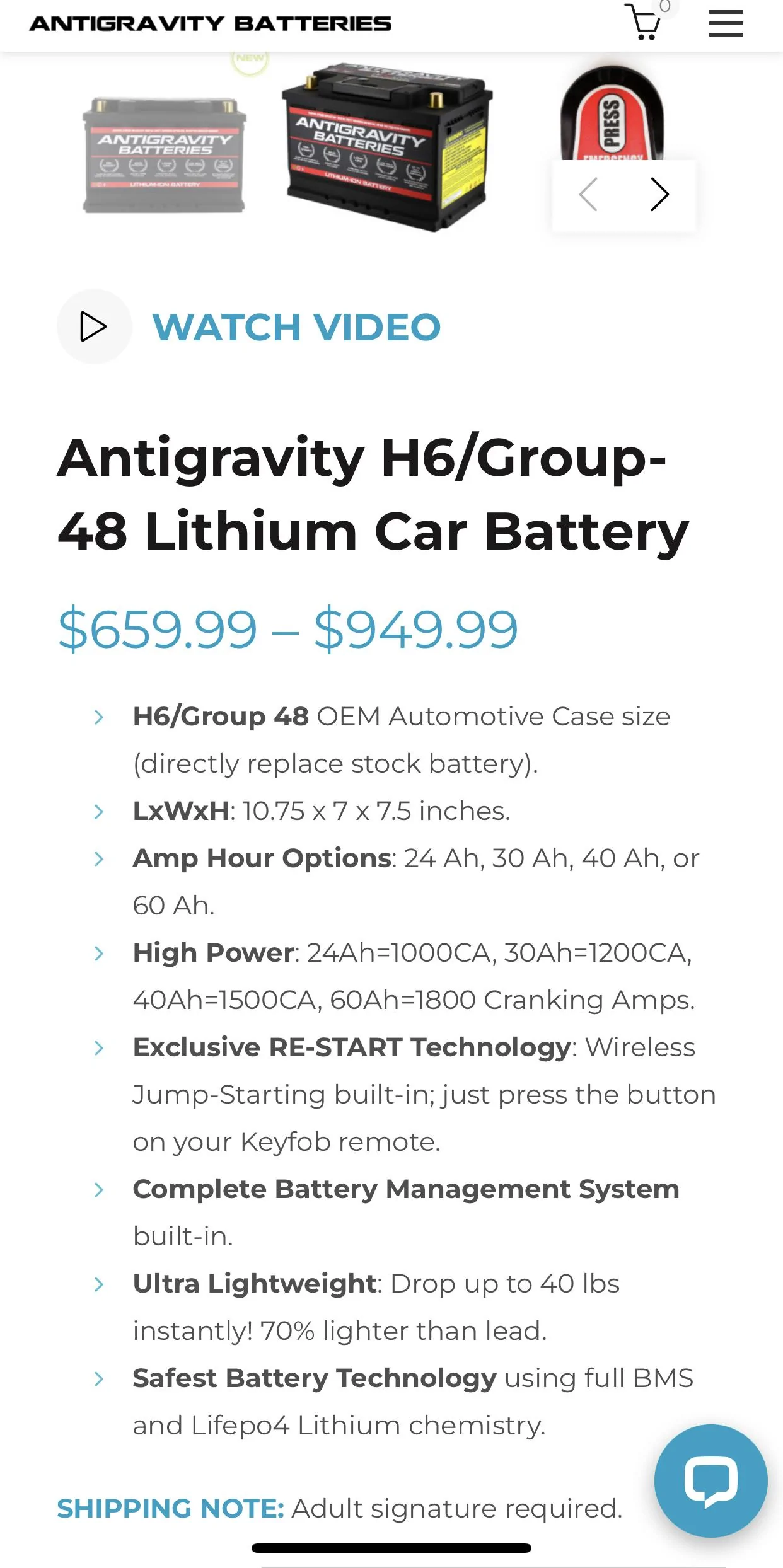

no advise yet, but I am starting the search as well. I want to go Lithium for both the main and aux batt. And although there are no jeep specific batteries out there yet, they are coming. Antigravity, Relion are a couple to keep an eye on. Lithium batteries are smaller, a fraction of the weight, can be mounted in any position, more powerful and last longer. This is the direction you want to be looking.😎

Anyone replace the main battery with a lithium? I'm hoping that there is a battery available with the same dimensions which would result in more capacity vs. Same capacity but smaller size. All I've seen so far is Dakota lithium, but they note max alternator current is 80amp. I'm guessing having a 240amp/h alternator won't be compatible
Not a good idea
  • The alternator is not designed to charge lithium - you really need a DC/DC or a special charge controller
  • lithium does not do well in cold unless heated
  • equally it has issues when getting hot such as under hood summer temps
  • the vehicle systems are probably not designed to work with lithium as it and AGM has some different operational situations in relation to usage and voltage drop
Not the best idea. The pcm controls charging and is expecting agm batteries. Lithium and agm charge differently. No way I'd go that route.

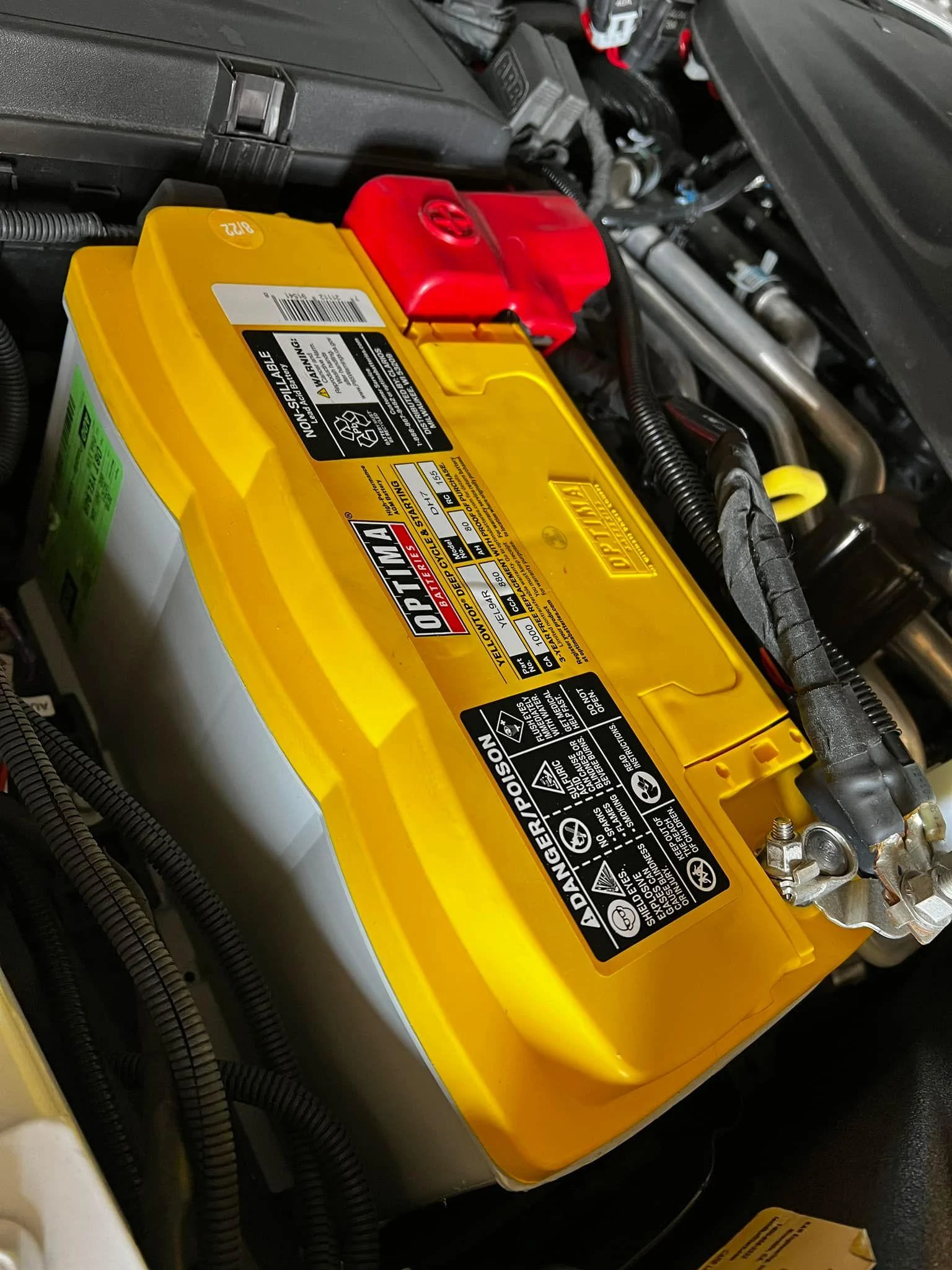

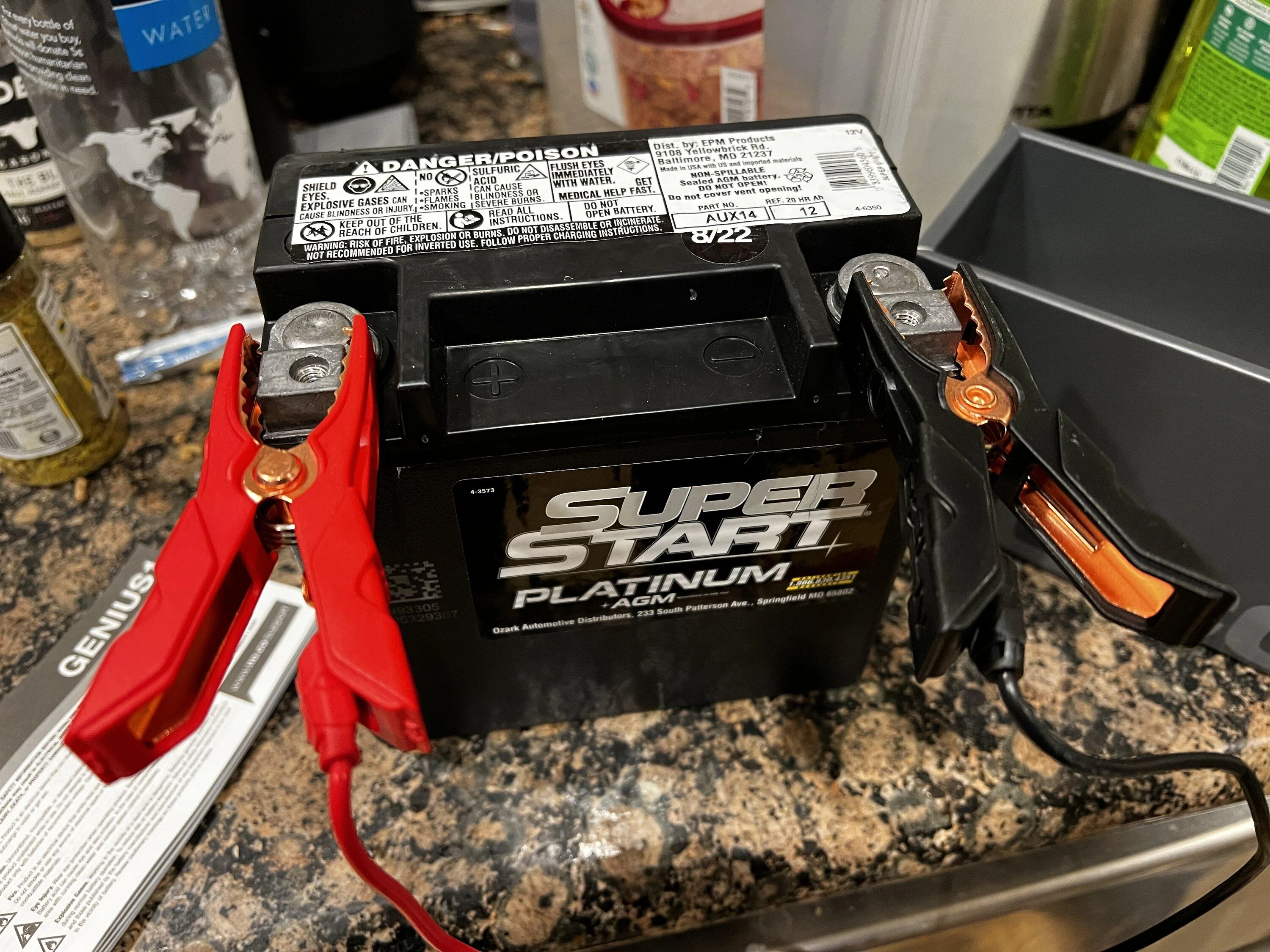

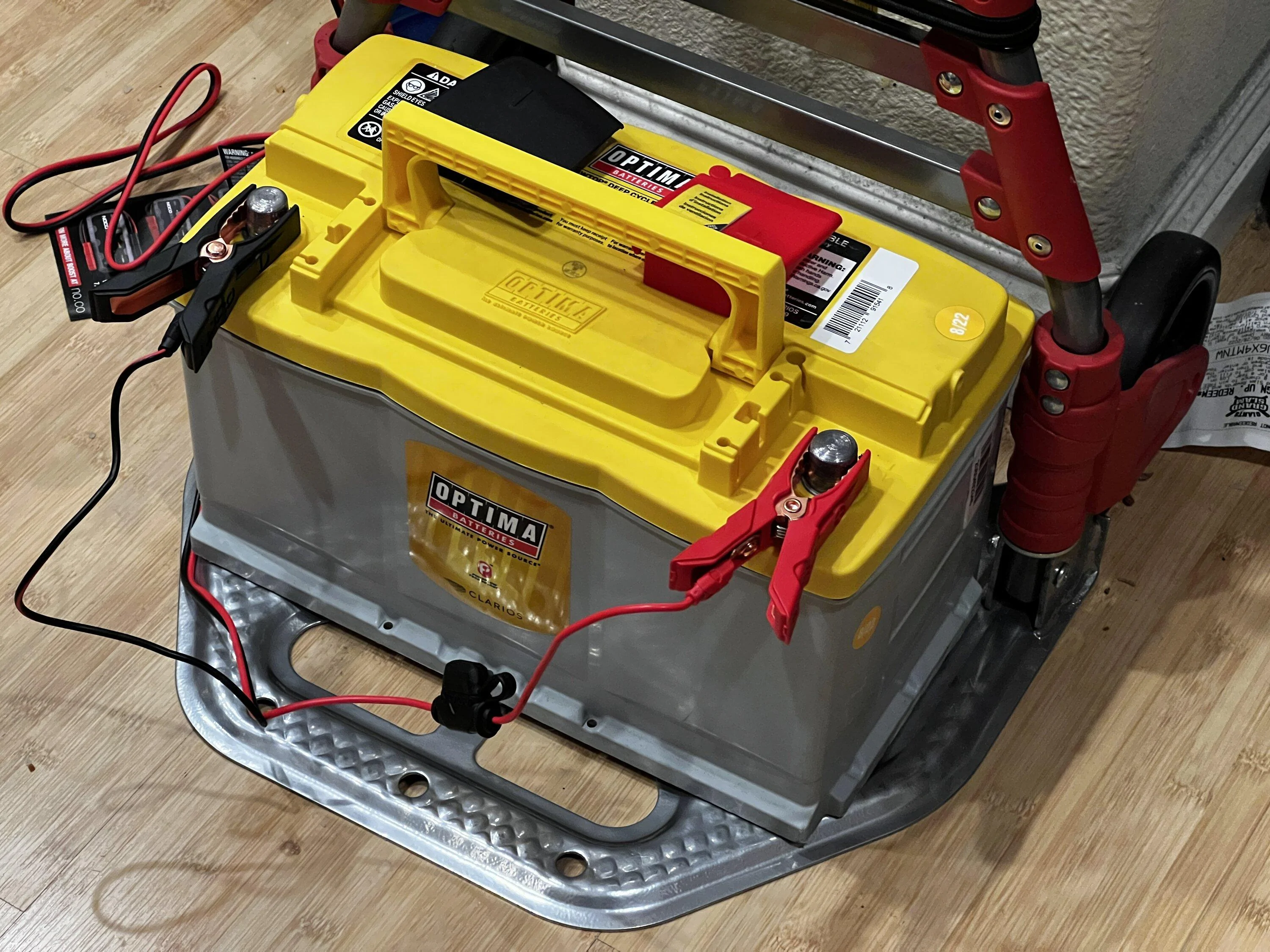

I was getting the tell tail signs that the AUX battery was about to go so I went ahead and just replace both batteries. I have no inclinations to do the AUX battery delete or installing a Genesis dual battery set up.
Jeep Gladiator When it's battery replacement time what are you choosing? 062c10db-30df-430a-abe3-dac04a8b9b60-jpe
Jeep Gladiator When it's battery replacement time what are you choosing? 717c374d-5ff8-4d31-9cb0-75c8e5a7f21b-jpe

Appreciate the insight guys. I do have a separate 2nd lithium battery that I use a dc to DC charge and that works great, was hoping to increase capacity on the main battery, but I seen to quickly forget how many systems and controls are in place through the pcm that would make it problematic. Will just keep things as is now now. Cheers

Good luck. The pcm is programmed for the charging rates etc of agm. Lithium charges differently. May work but sure won't be ideal for health or life of batteries. Each type requires different charging scenarios.
