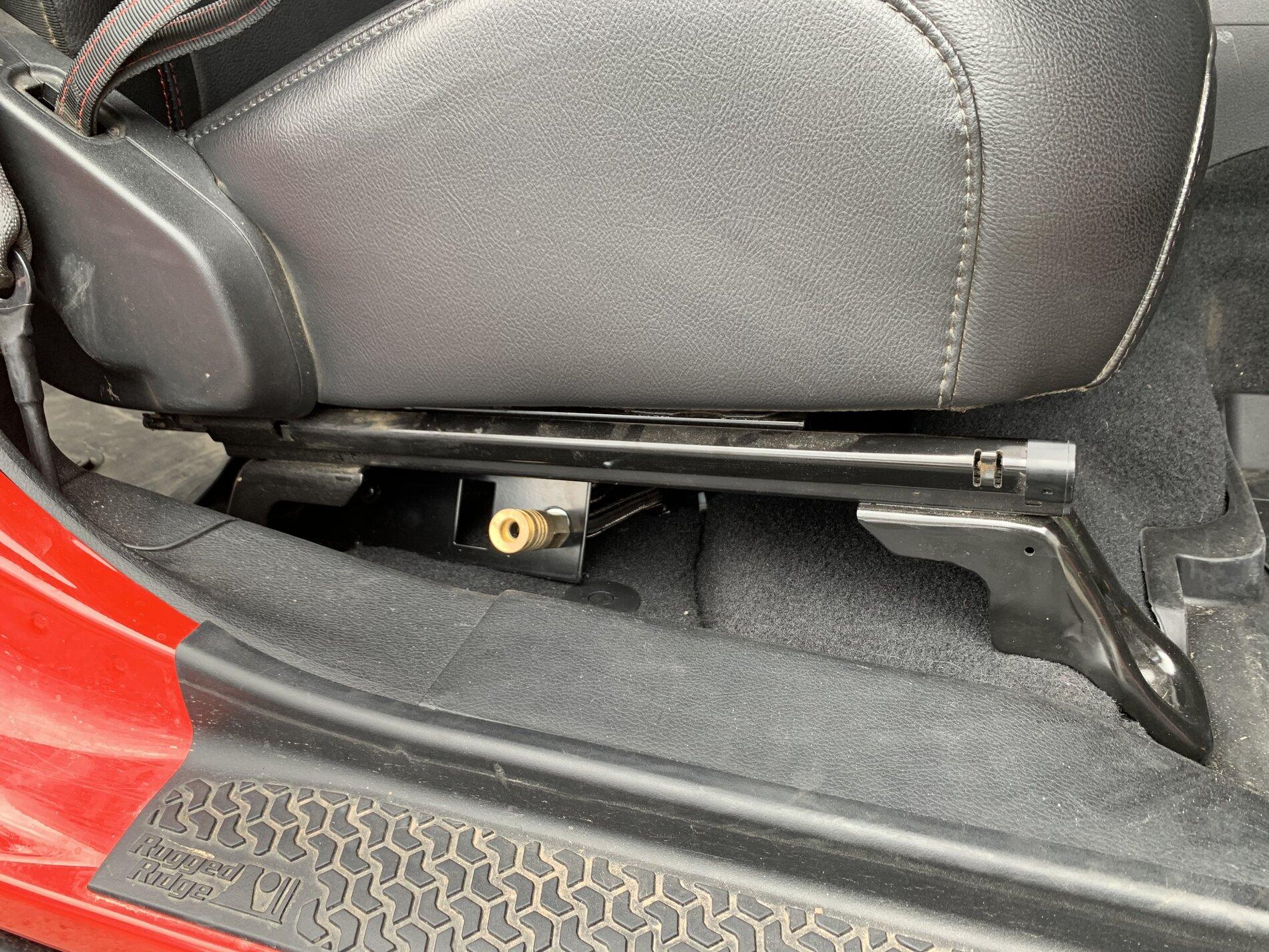

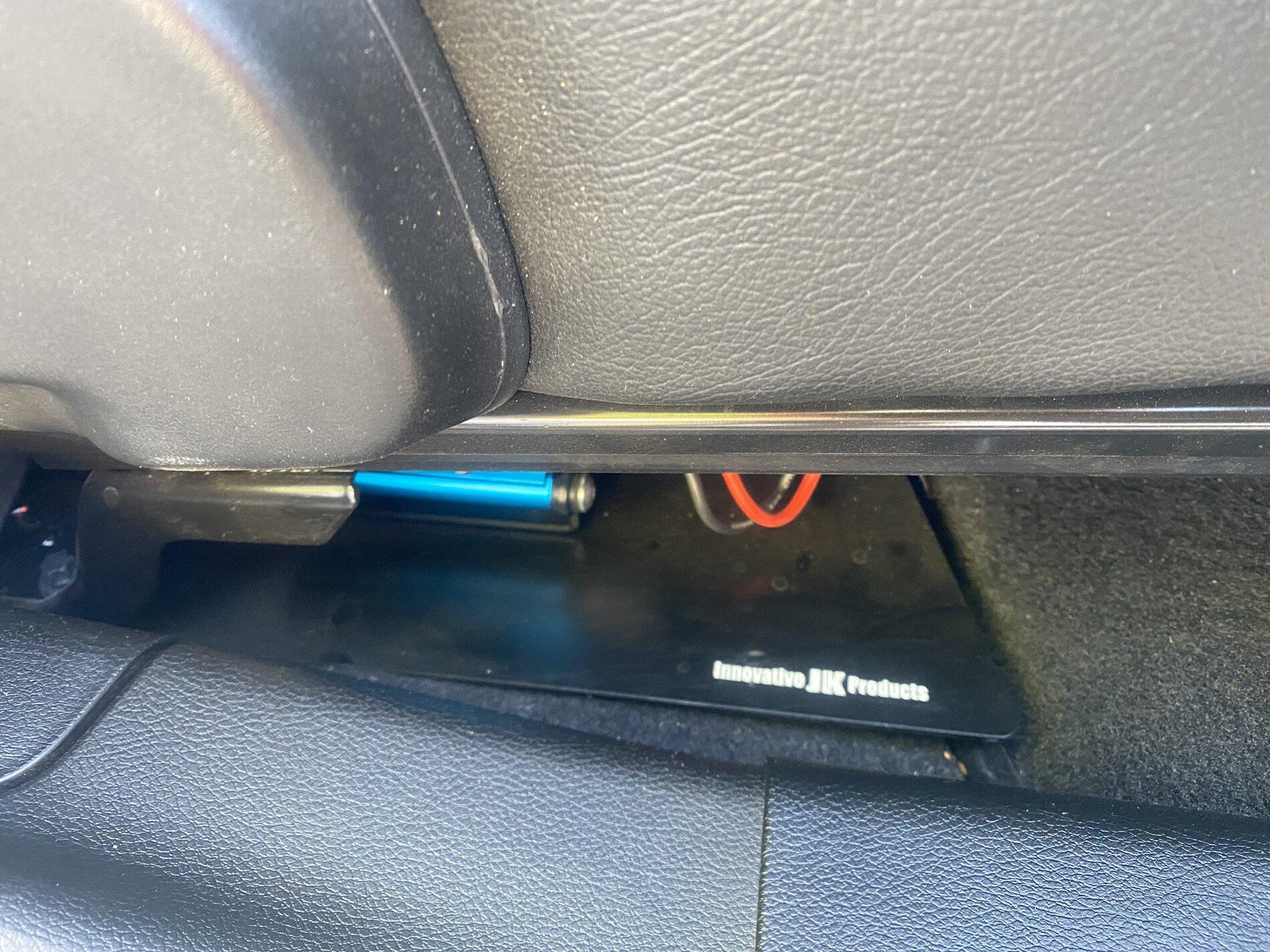

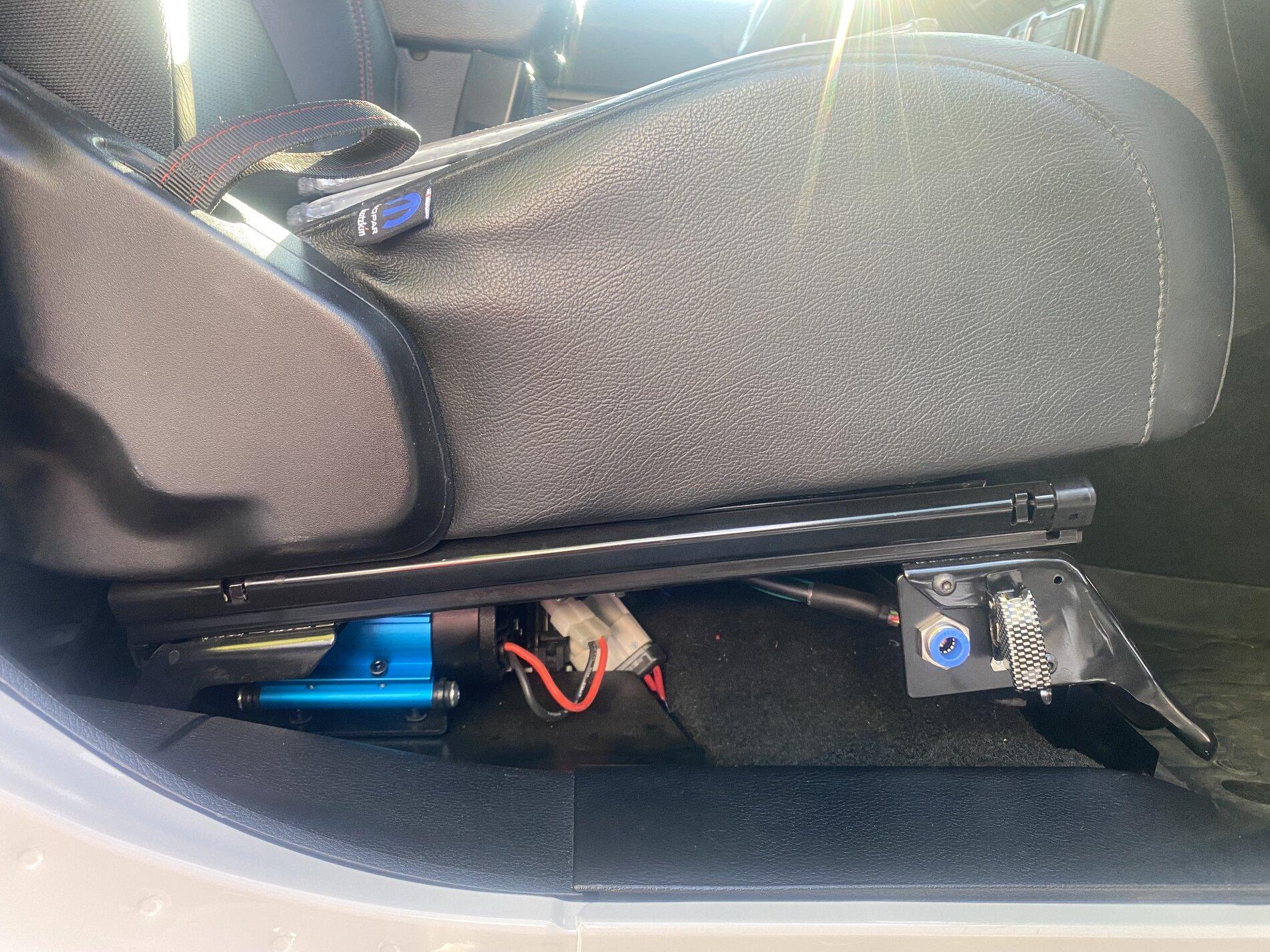

I run the entire air system that airs up and down my 37's with no problem. Not as fast as my portable Power Tank but much more convenient than having to find a place to fill the tank while traveling.

How is the noise in that spot and was wiring a bear?

Wiring was a piece of cake and noise is tolerable for those that choose to stay in the vehicle while airing back up.

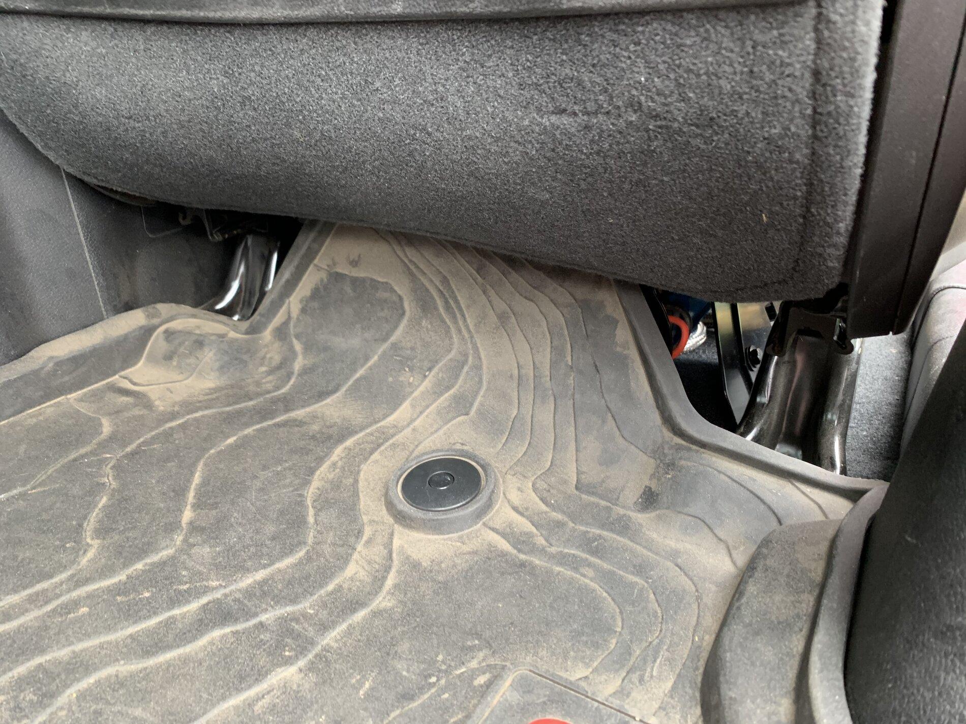

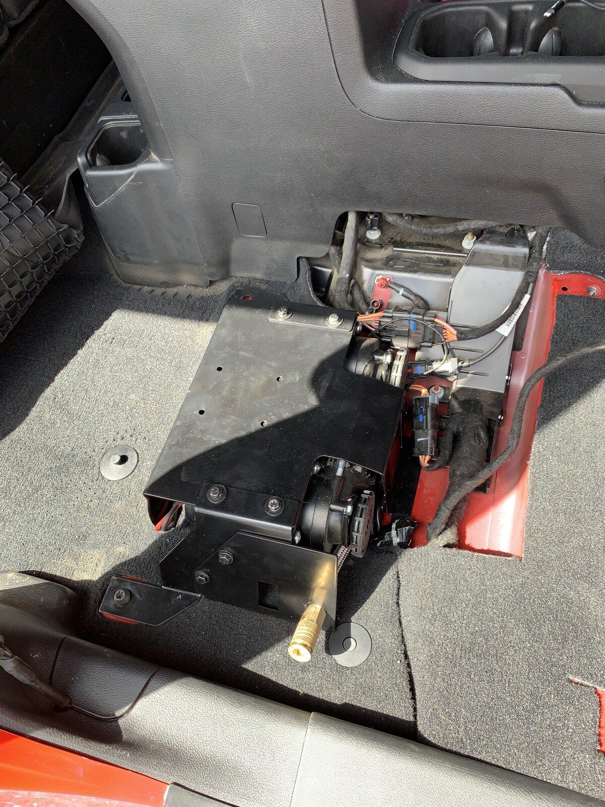

Sweet! Which mounting bracket are you using?

I would likely rather lose the space under the passenger seat than the back seat due to access restrictions with passengers, pets, etc.
Looks like I'll likely end up with the passenger seat setup.
