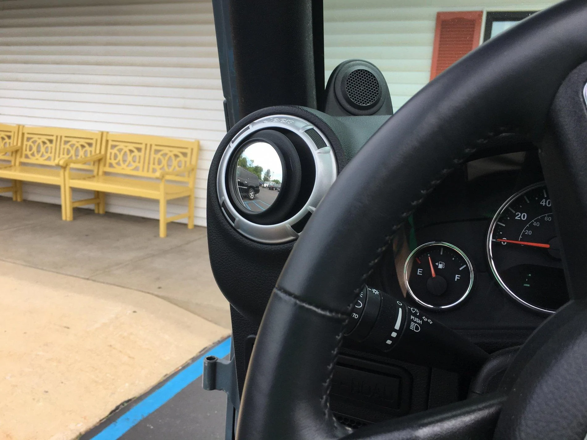

Personally the vent mirrors along with two long rectangular 'blind spot' mirrors lengthwise down the A-pillar works well enough for me.

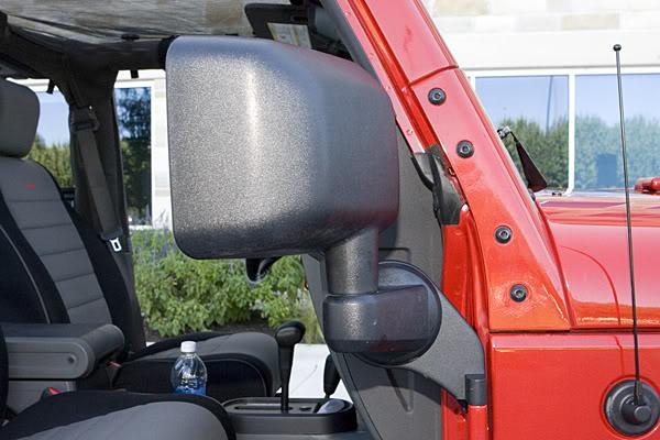

Pic of a current hinge relocation bracket.

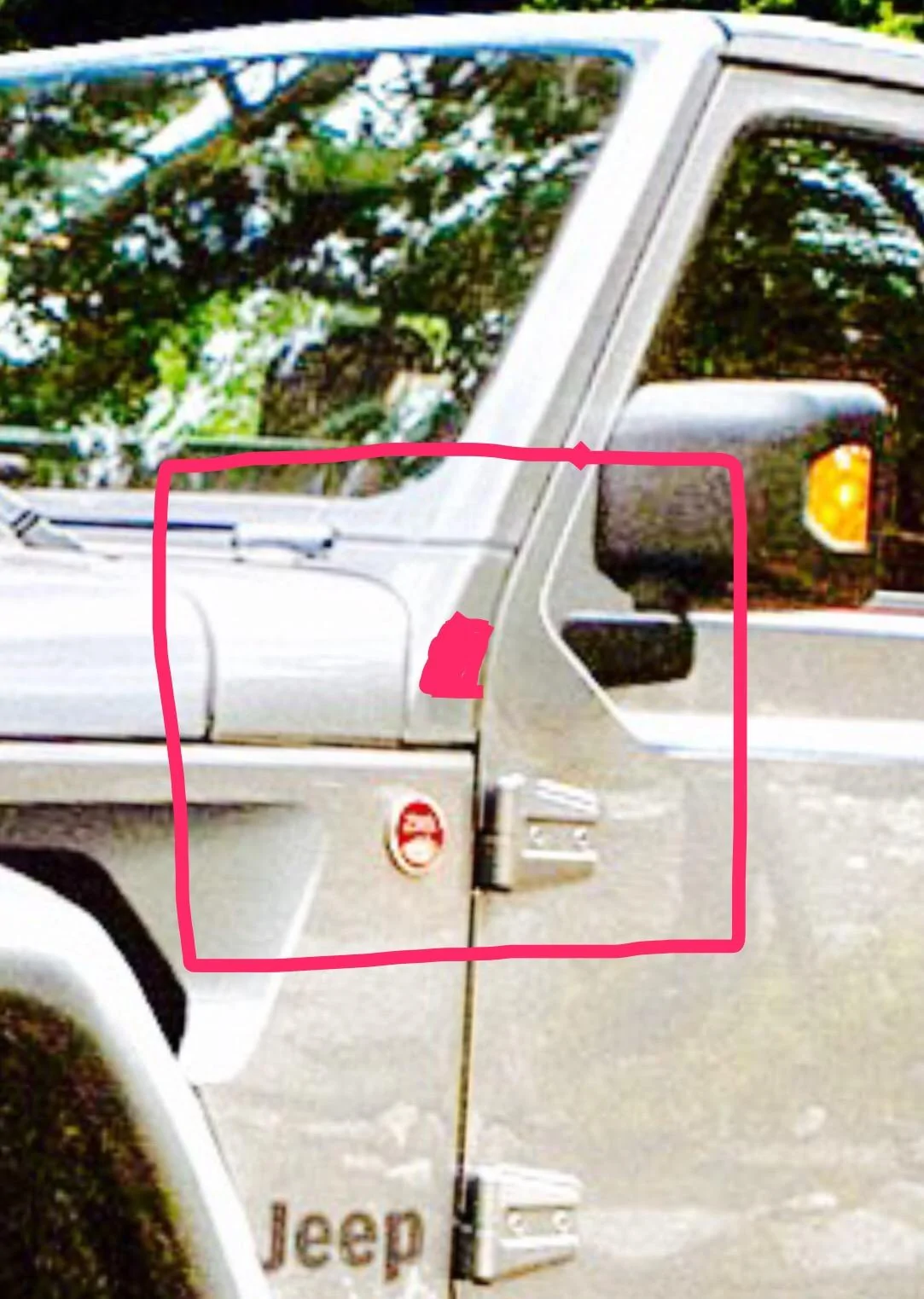

Perhaps these do not give enough of a view for those needing to backup hundreds of times per day to deliver payload onto raised platform or something of the sort ?
That's were I have mine, same place I had them on my JKU.

The JKU mirror and hinge bracket is a nice solution for going doorless.
