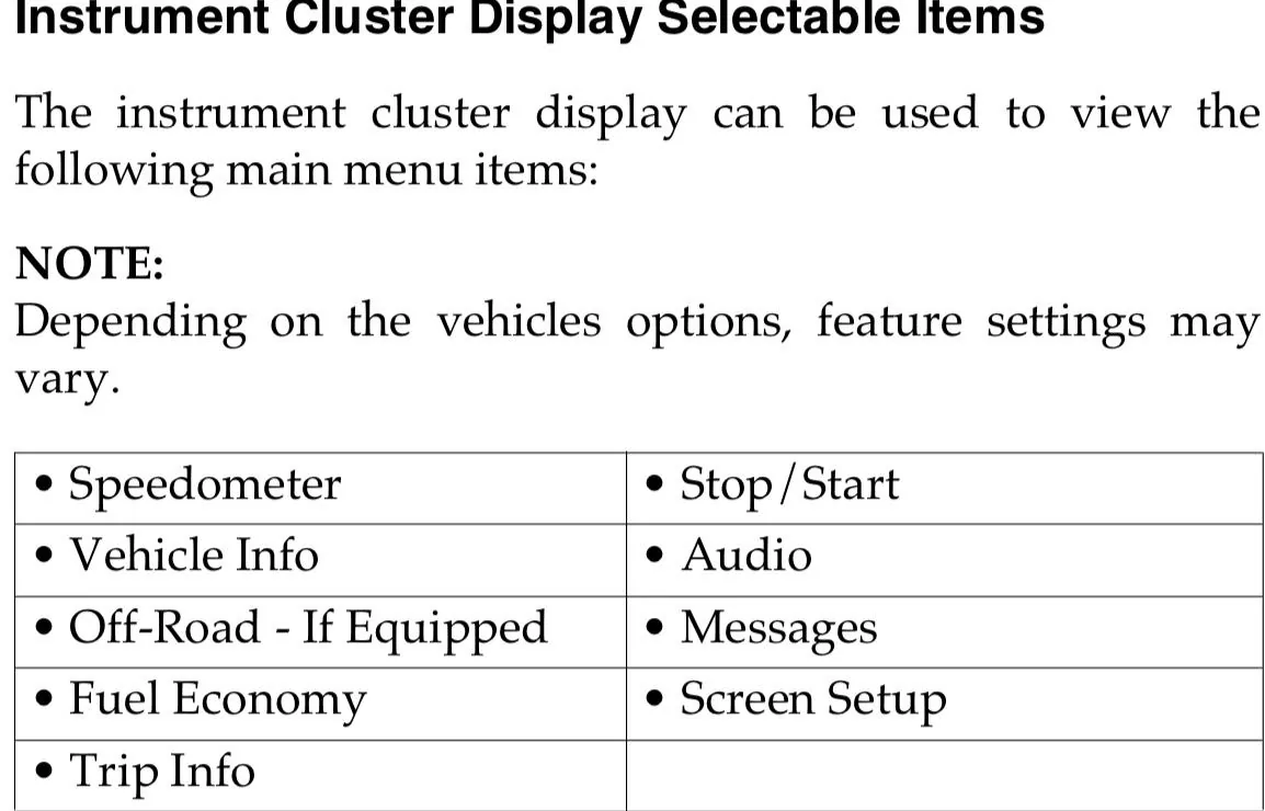

This feels like a ridiculously stupid question to ask, and I'm shocked that it's this hard for me to figure out, but I've searched the users manual and the forum and every single page of every app I can find in my UConnect display, and so far I've got nothing....
Since the TPMS sensors are reporting the pressure to the Gladiator, is there anywhere I can see the reported tire pressures, or do I have to manually walk from tire to tire to test each with a handheld device?

Man, I really feel like I've already searched every screen available for that. The left-hand Up/Down switch on the steering wheel switches between a bunch of different screens (speedometer, audio, gauges, mpg, etc). I really thought I tried left/right to look at every page on every screen and never found it. Any idea which of the screens has that page hidden away in it? (When I turn my JT on it defaults to the last screen I used, so just hitting "down" would only change to the next screen for me, which would be different that the next screen for you). Like I said, I sure it's supposed to be easy to find, and maybe I'm just blind or missed a screen by accident, but I can NOT seem to find this. I guess I'll go back out and try to search all those screens for a sixth time...
It’s in the "Vehicle Info" screen between the "Speedometer" screen and "Off-Road" or "Fuel economy" screen. You’ll see temperature or voltage gauges if it’s not in the tire pressure section. Just scroll through the gauges with left and right arrows buttons and you will see small dots at the bottom of the screen showing how many sub-menus are available... If you go to the screen "Screen setup" you can select the pressure as the gauge to be shown by default on the "Vehicle Info" screen.
