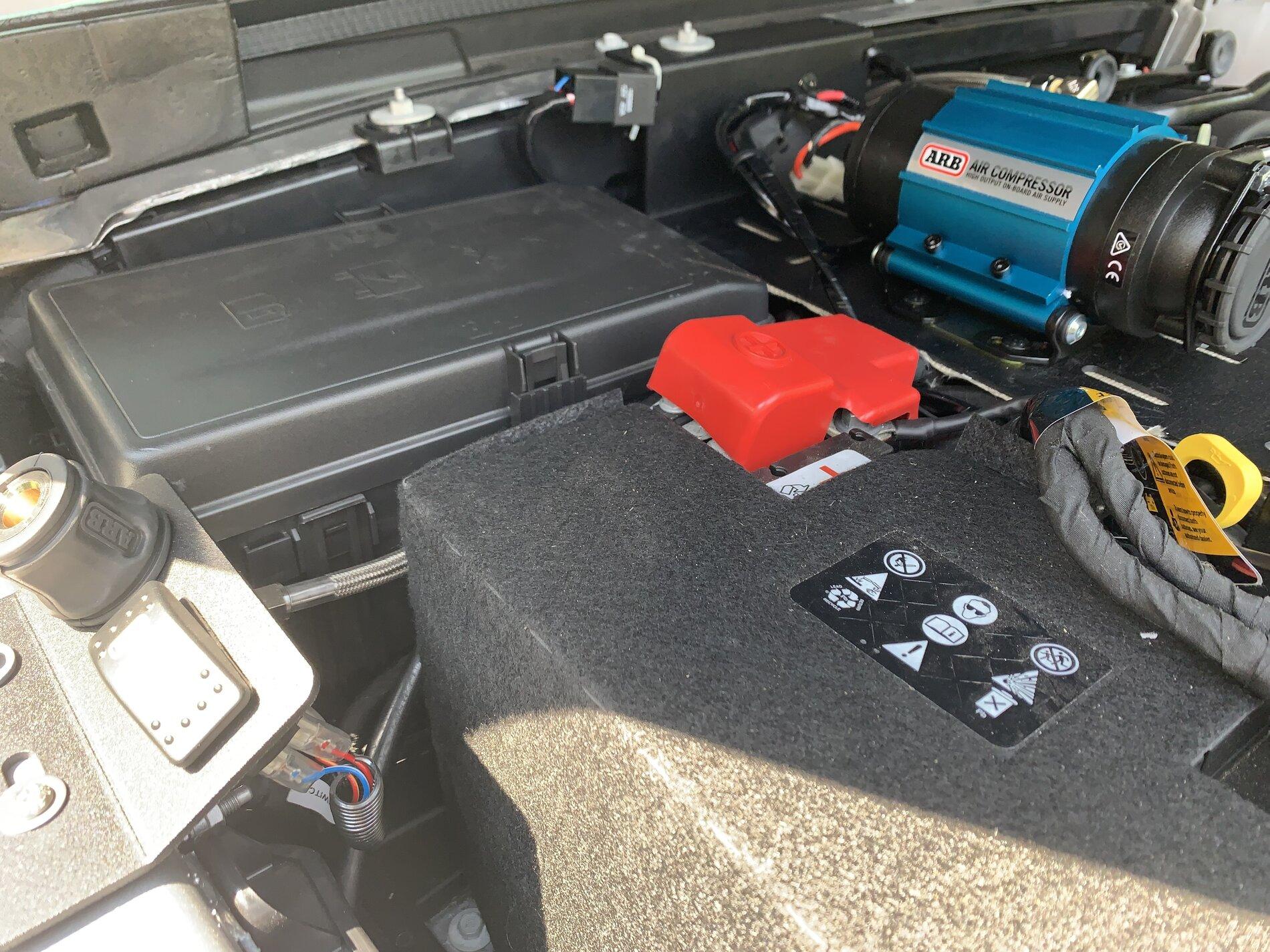

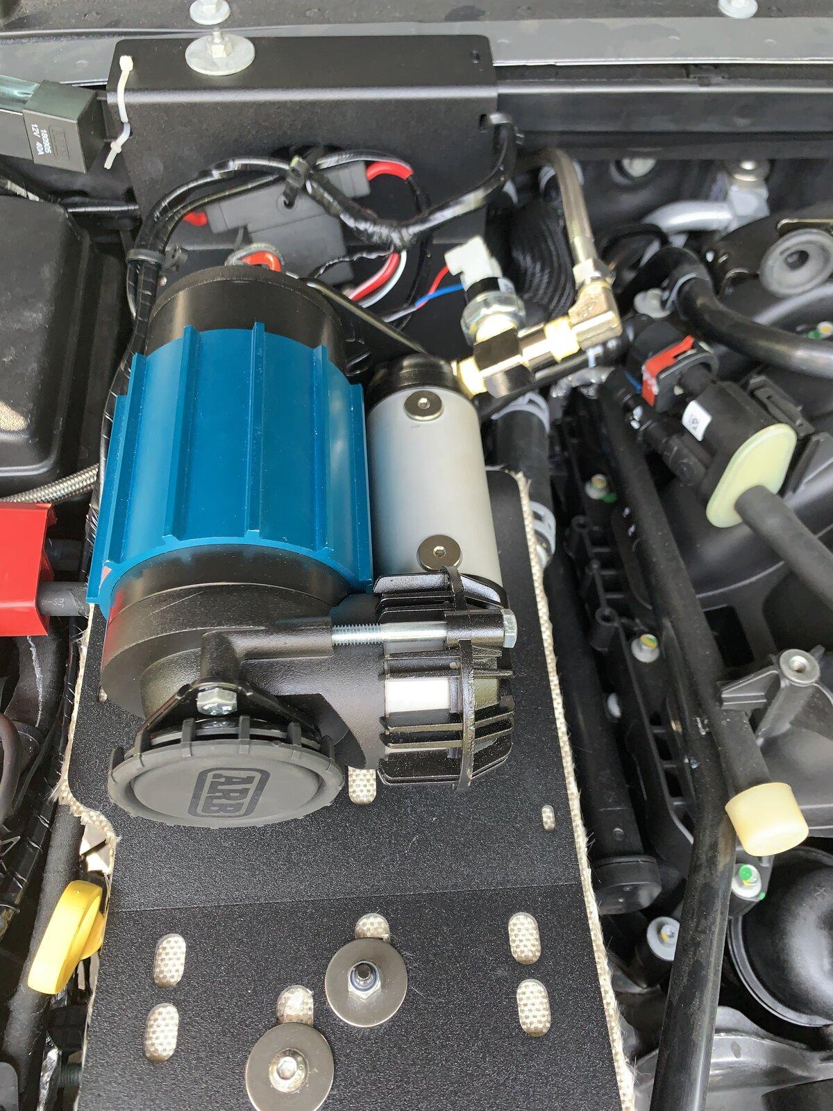

Finally got mine done. I ended up using a fuse tap for the switch and hooked it into the cigar lighter fuse. Stripped out all of the unnecessary wiring that was there for the lockers and it made the cabling a lot more manageable. I’m happy with it.

Looks great!!
