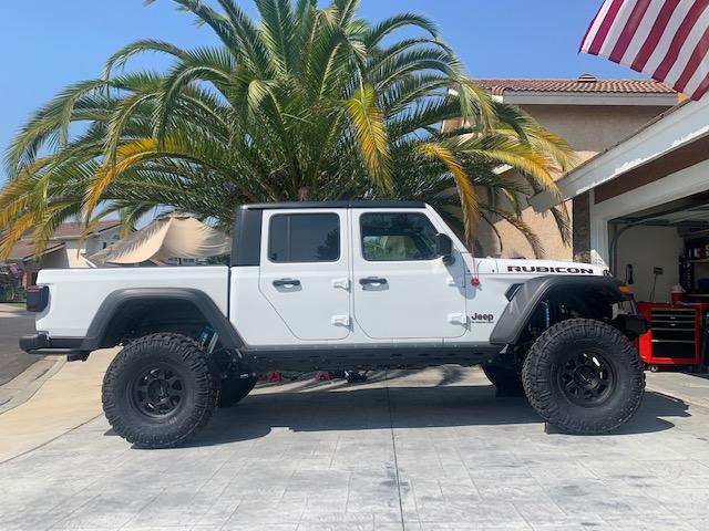

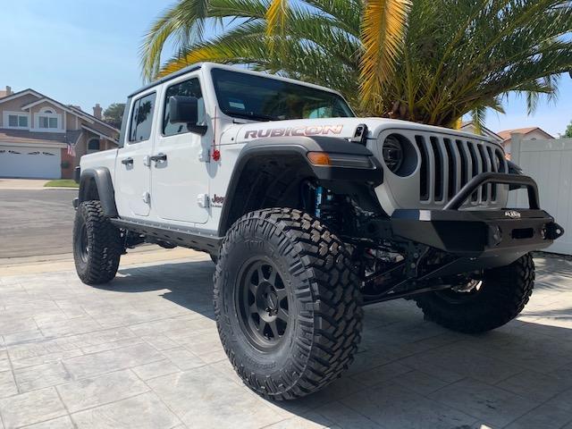

Got the evo kit installed this weekend. Stoked with the result.
Jeep Gladiator Which 4.5" lift kit... Rebel Recon or Evo Fusion? IMG_2211
You like the 37” tires with that lift? (I assume those are 37’s) What’s the total height (highest point) from the ground? 81”? Need to fit in my garage.
danenglish2
danenglish2
Jul 19, 2020
SoCal
Yep. Highest point is around 79-80"
