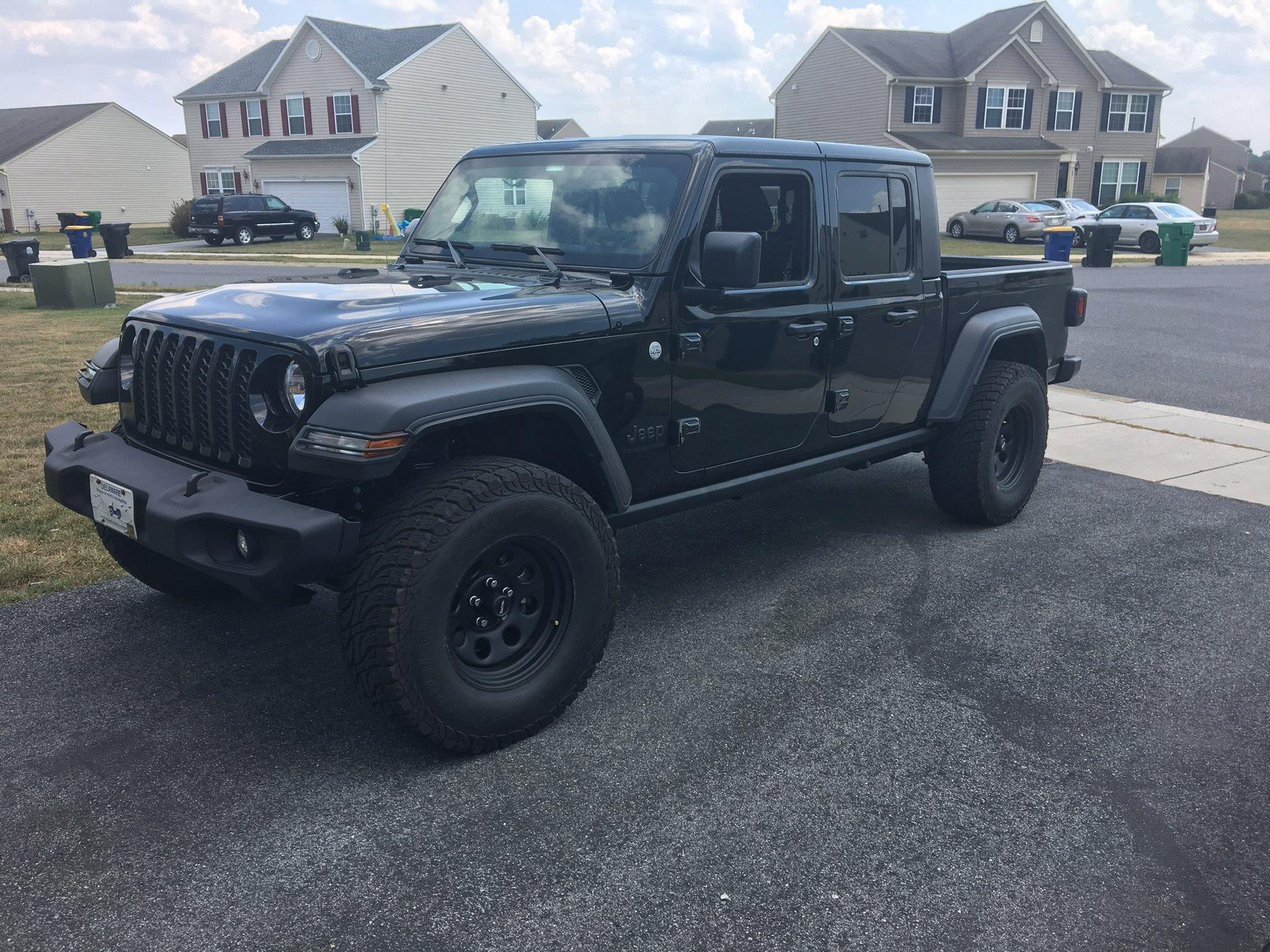

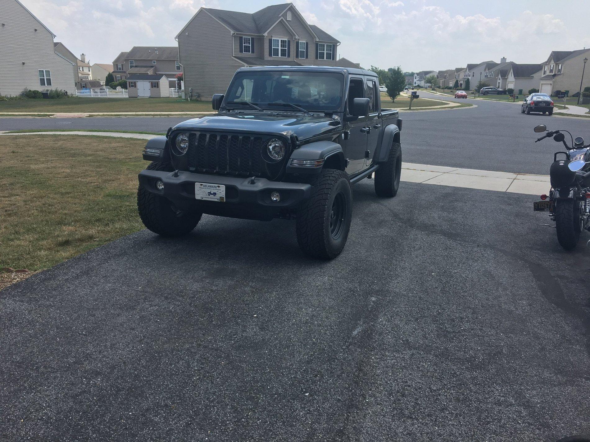

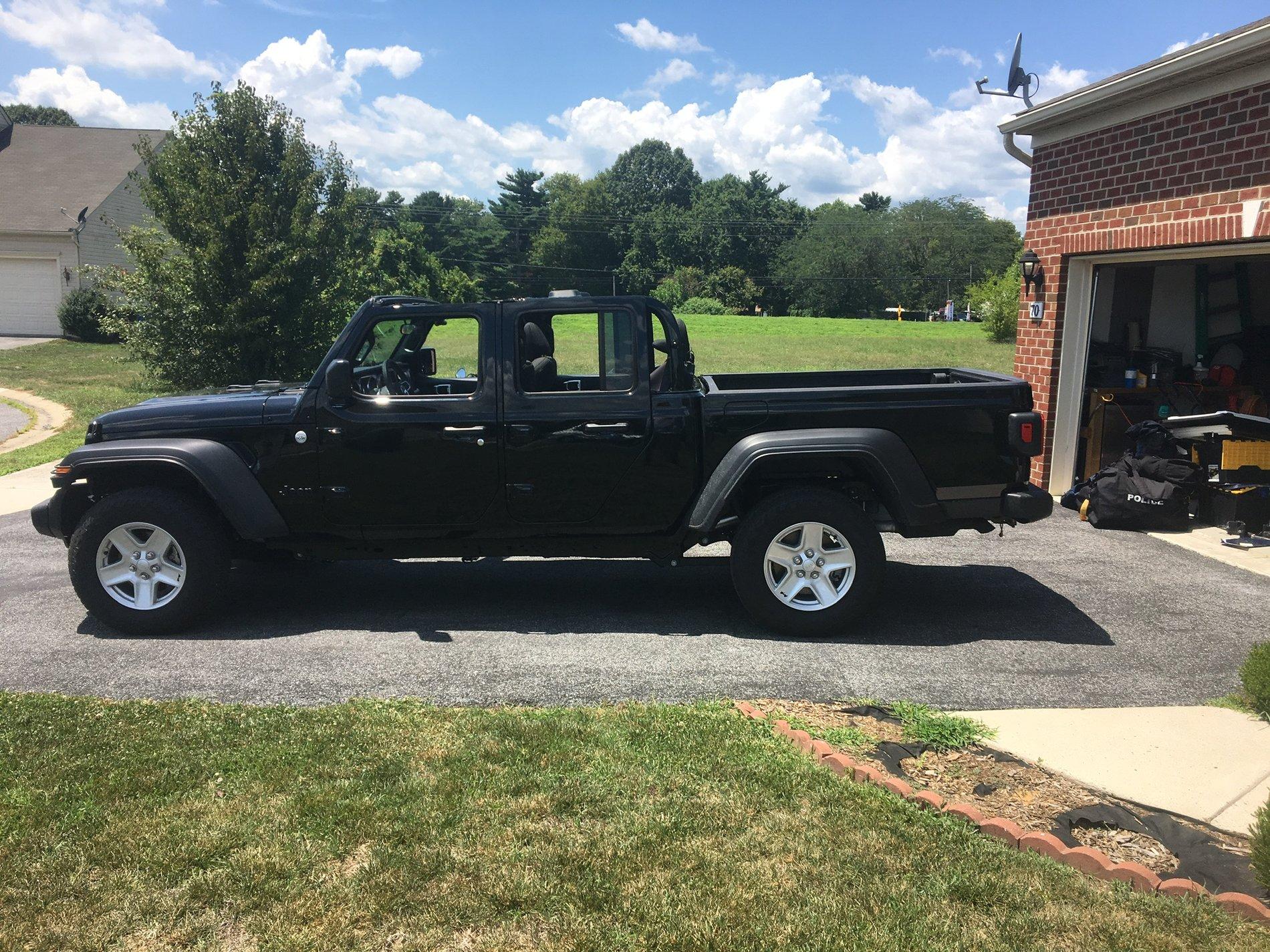

I did alloy usa 1.5” front and daystar 3/4” rear. Maintained the factory ride and fit 35’s after grinding down the euro fender pieces.
Ive since taken the 35’s off because i felt like they negatively impacted performance with very little gain. Ill be getting 33’s and putting them on stock rims.
Topless picture is pre lift

Thank you very much for the info......what was the negative impact you mentioned?
Gren71
Jul 9, 2019
143
4,004
6,342
Magician
It’s entirely subjective info, no verified data to back it up.
I felt like i lost acceleration and breaking distance. Additionally when you up tire size you change the ratio of torque transferred to the road and ultimately decrease towing ability. I intend to tow a trailer and really dont want to be gear searching and barely able to keep up on the highway.
After some research I (literally just me) think that 33’s are the best of both worlds. Ill get the tire look i want and still have the power for towing closer to max load.
The only real data i have is i was averaging 17-18mpg with 35’s and very conservative driving. Now im getting 19-21 with the stock tires and more “regular” driving.
Im going to 285/70/17 on stock rims. I hate the stock rims but its the least expensive option for now.
