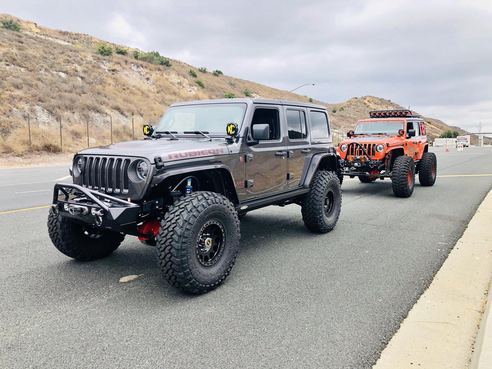

I’m running the rebel kit in my JL and will likely run it in my JT. The quality is top notch. No complaints from me! As mentioned, I also didn’t hesitate running aftermarket axles.

The quality is close to stock. I have a load range “c” on the 40s vs the “d” I had when running 37s which I feel also makes a difference on hwy. The kit is bolt on but requires cutting off the bumpstop w a sawzall. For my JL, I’m running a LongArm setup and that requires welding. If you will run a short/mid arm setup, than the install will be much easier since NO welding is required.
