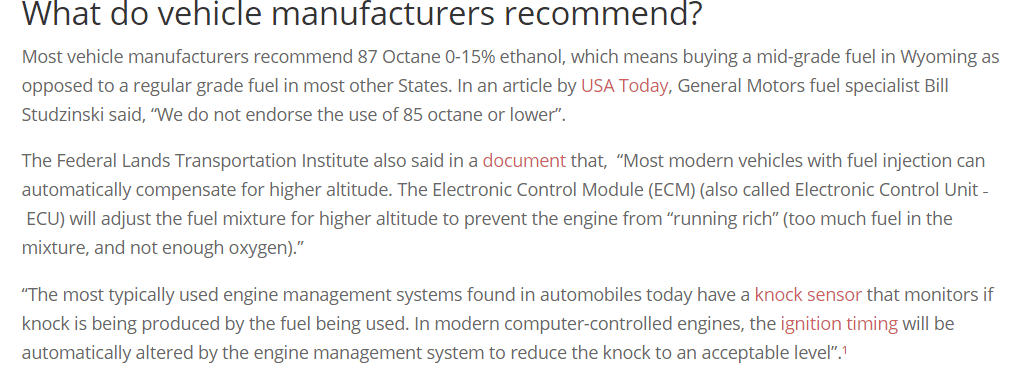

Again, this is just my thought process, and certainty does not align with the accepted wisdom that has been around since the carbureted days. That said, here is what a GM engineer has to say about it.
Jeep Gladiator Which Octane in Colorado? 1602774355158

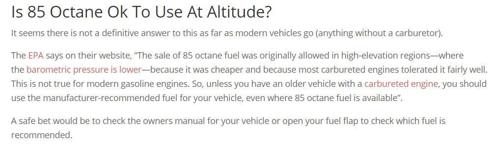

and more from the EPA
Jeep Gladiator Which Octane in Colorado? 1602774383779
