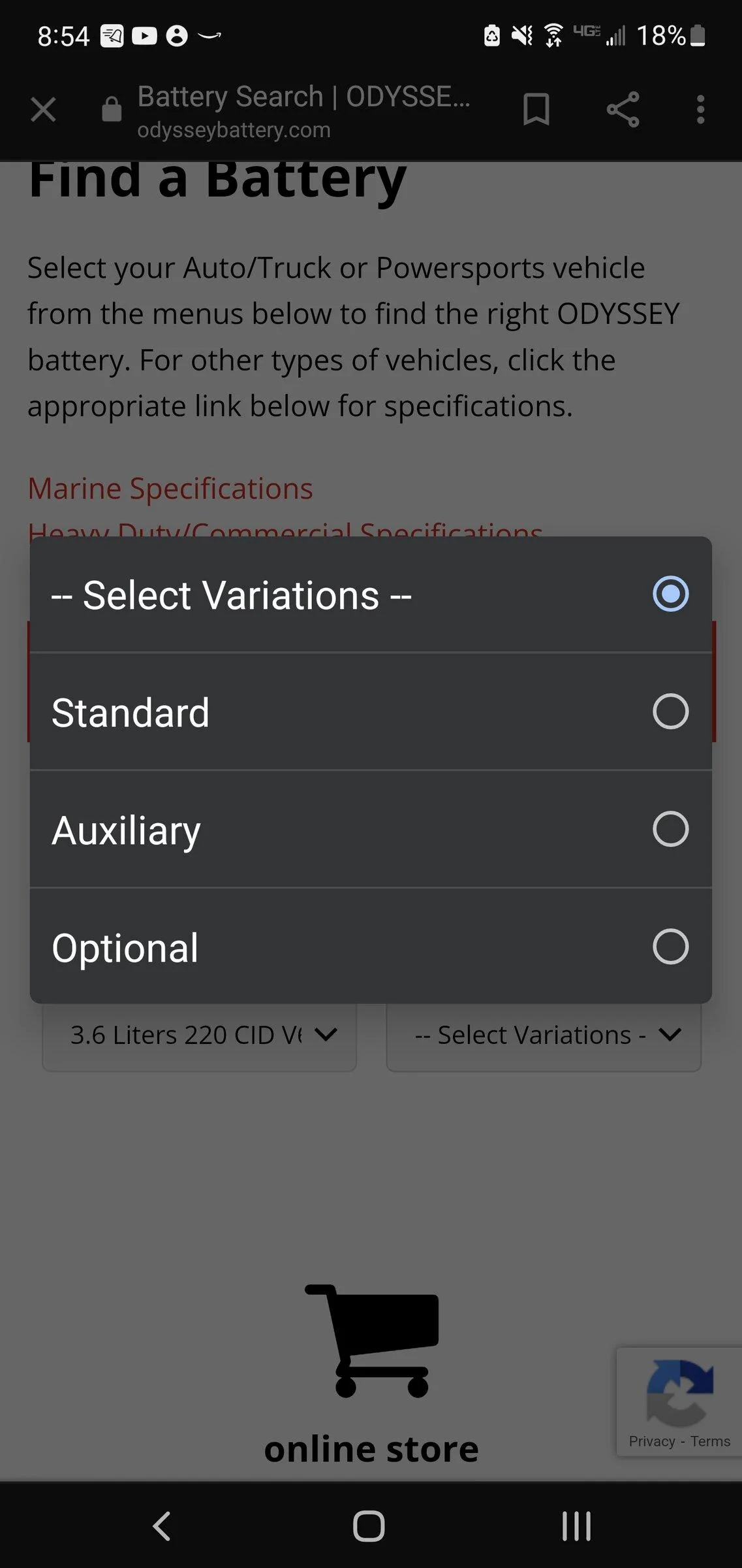

You must have seen this popup then:
Odyssey also asks you specify which battery. The 48 is the smallest, weakest one. The 94 fits in any JT. When spending over $300 for a battery, you buy the 94 which in Odysseys case is the ODP-AGM94R H7 L4.

Ah yes, and I selected Standard. I guess I should have picked Optional.
