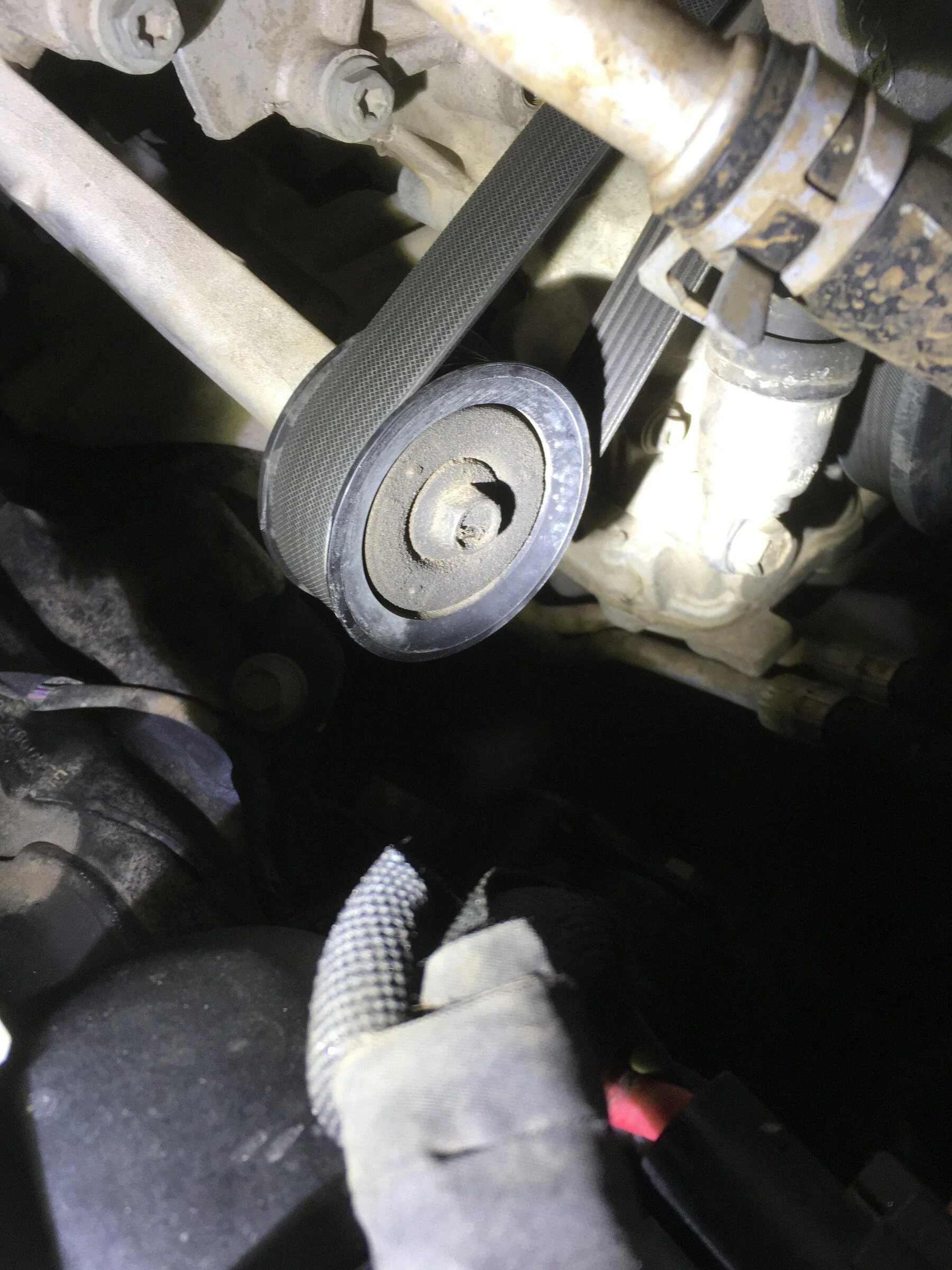

(UPDATED Short story: Idler Pully Wheel was defective and bearing seal was eliminating grease. Was replaced but whine continues as before)

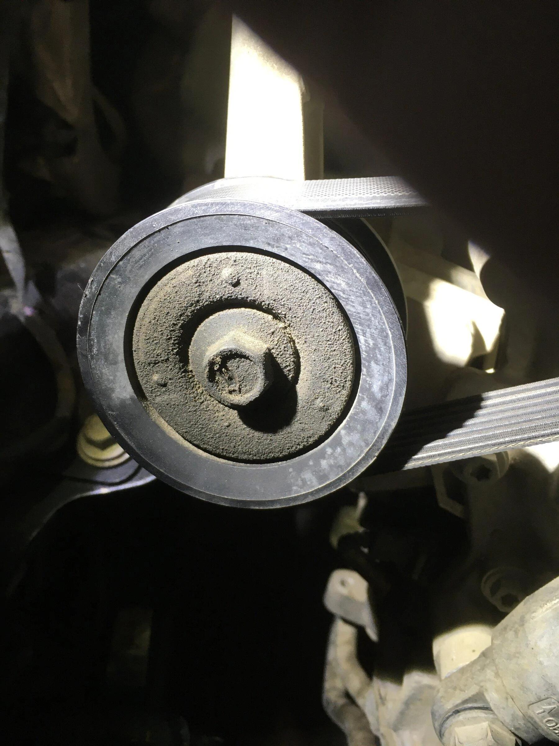

The whine is the Idler Pulley wheel! Saw the bearing had blown its seal.
Put the stethoscope on it and it was just screaming with the rpm’s.
Sent pics in to the dealership and they are ordering the part!

Pulley arrived and install on Monday morning!

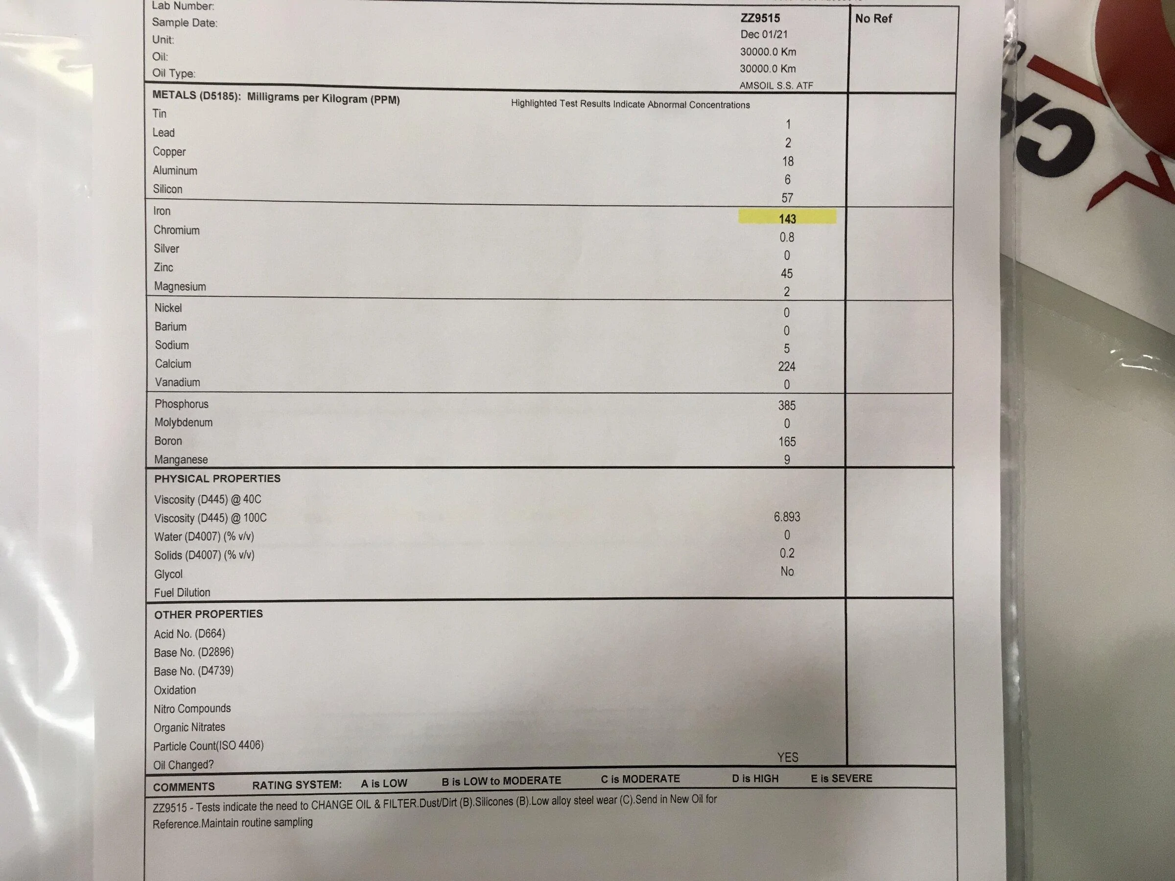

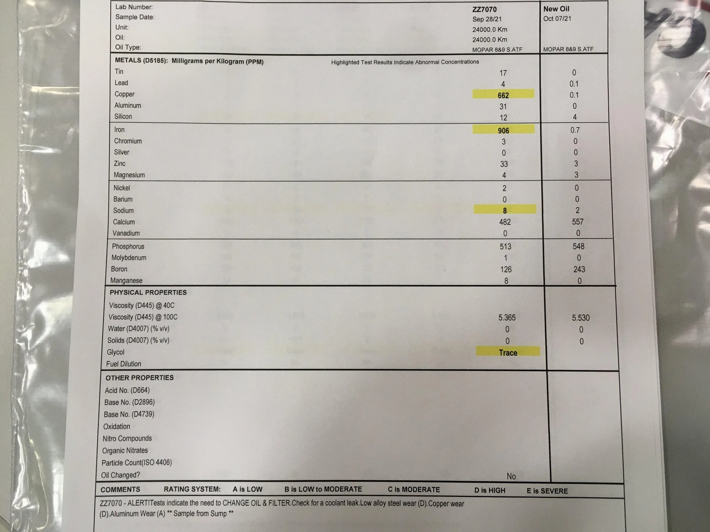

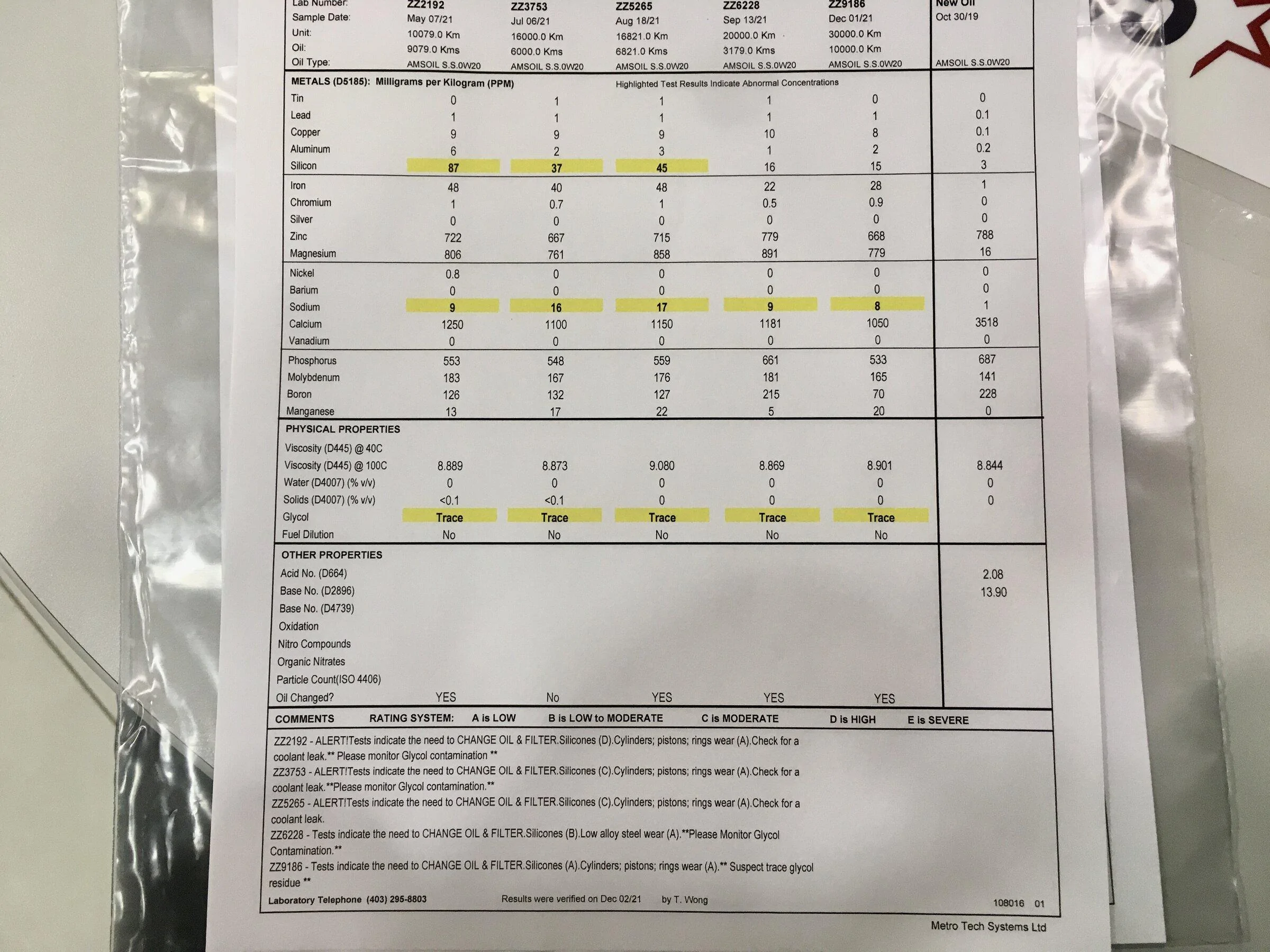

Sitting here at the dealership waiting for the idler pulley wheel to be replaced. Now that we know the whine isn’t the transfer case, here is food for thought to think about. ….
I changed the oil in the transfer case at 30k KMS, just a couple days before coming in last week to have the tech try and find the whine. The service advisor commented that the transfer case oil was good so it didn’t need changing and asked if I wanted to be notified at 47k kms for that service. I said I had already changed the oil and do all my own oil services on everything, including the transmission. I told her a sample of the oils are always sent to the lab for analysis. She asked why would I change the oil before the 47k service?? She was very curious what the lab would find with the transfer case. My concern with the whine was that it was the T case and the lab results would bring clarity to the health of the unit.
So now we know it’s the idler pulley wheel.
Coming in this morning, I showed her the lab result on the T case, engine and transmission. She was blown away with the data it shows. She was a bit speechless as people don’t take this step.
Lab results indicate highlights to “abnormal concentrations”.
T case:

UPDATE:
Arrrrggggg! Whine is still there. The pulley wheel was defective and replaced but made no difference in the whine.
Back to the drawing board.
