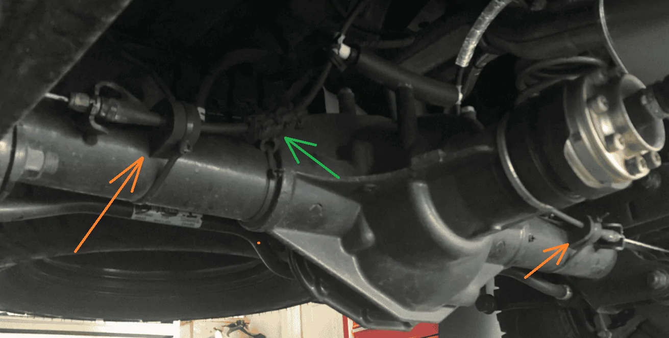

I also added rubber 'dampeners' to the cables. One near each end (orange arrows), made from 1" thick rubber, and attached with heavy duty Ty-Raps, and also where the cables contact the center section (green arrow):
