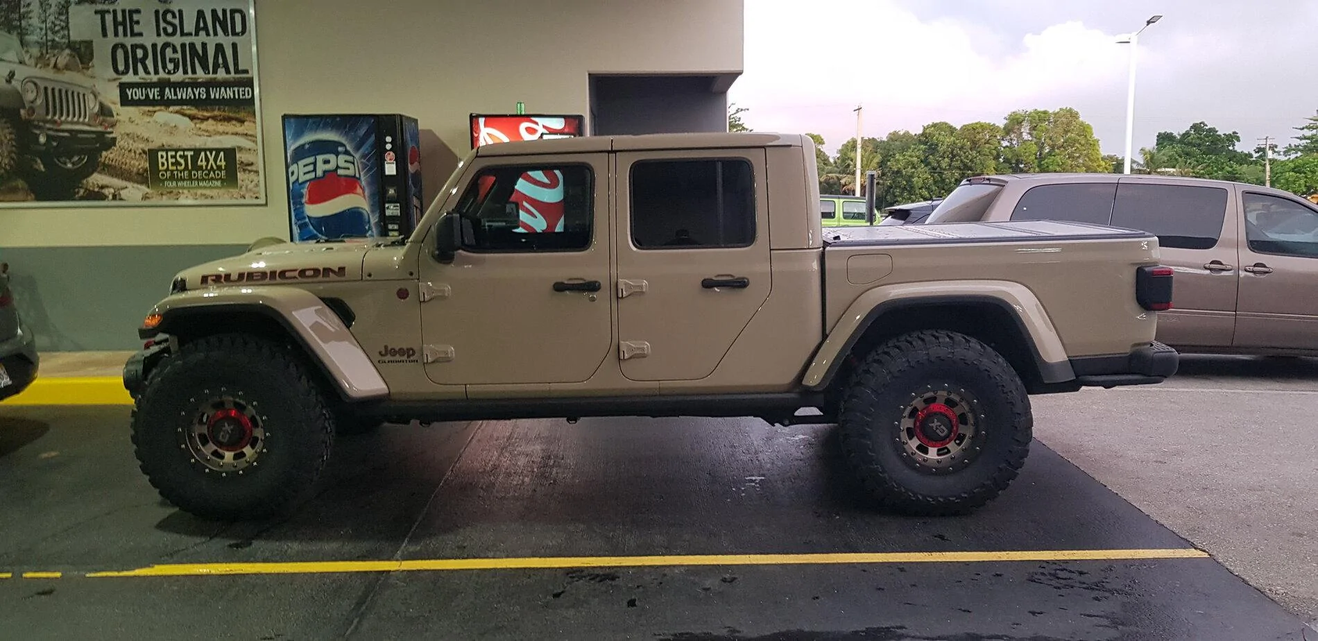

I have Rubi as well. I haven't installed my Clayton 2.5" Overland+ yet. I installed my Toyo Open Country MTR 37x12.5R17 on my new wheels that have 4.5BS and -12 Offset. I've been running on it for almost 2 weeks now with no lift and no Rub and can make U-Turns.

Any pictures of the 4.5BS and -12 offset from the front/rear. Trying to decide on -12 or + 1.
Going to try the same u til I figure out what route to go on my Mojave.

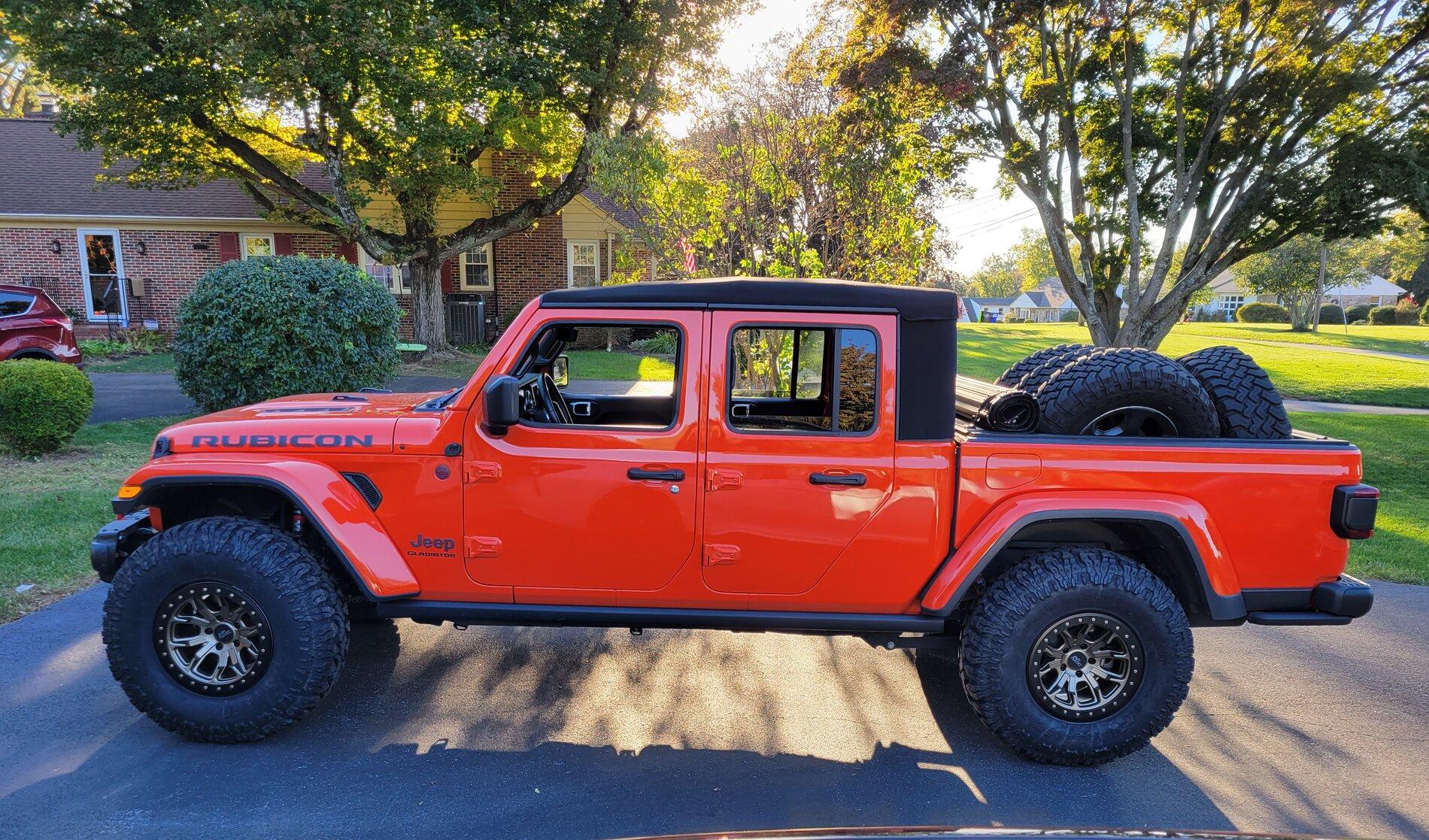

I was able to run 37x13.5 r17 on my Method wheels before I installed my lift.
No rubbing.
