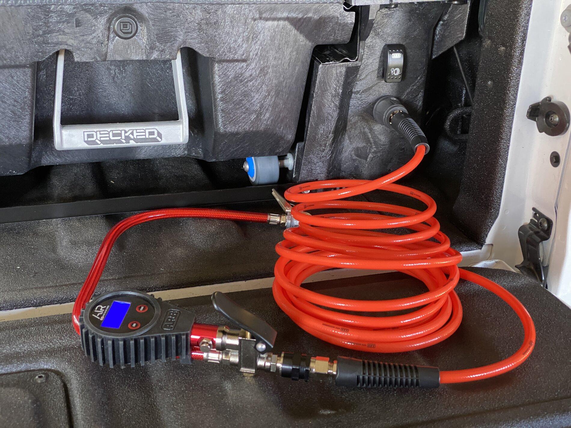

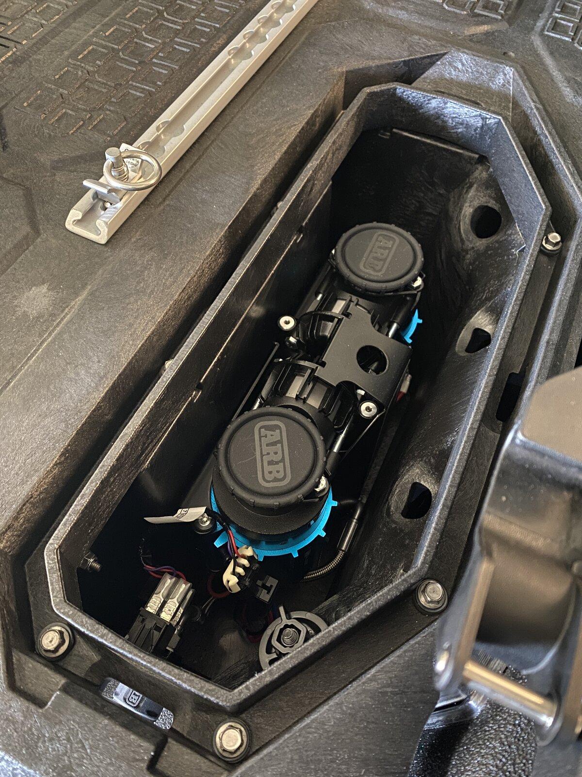

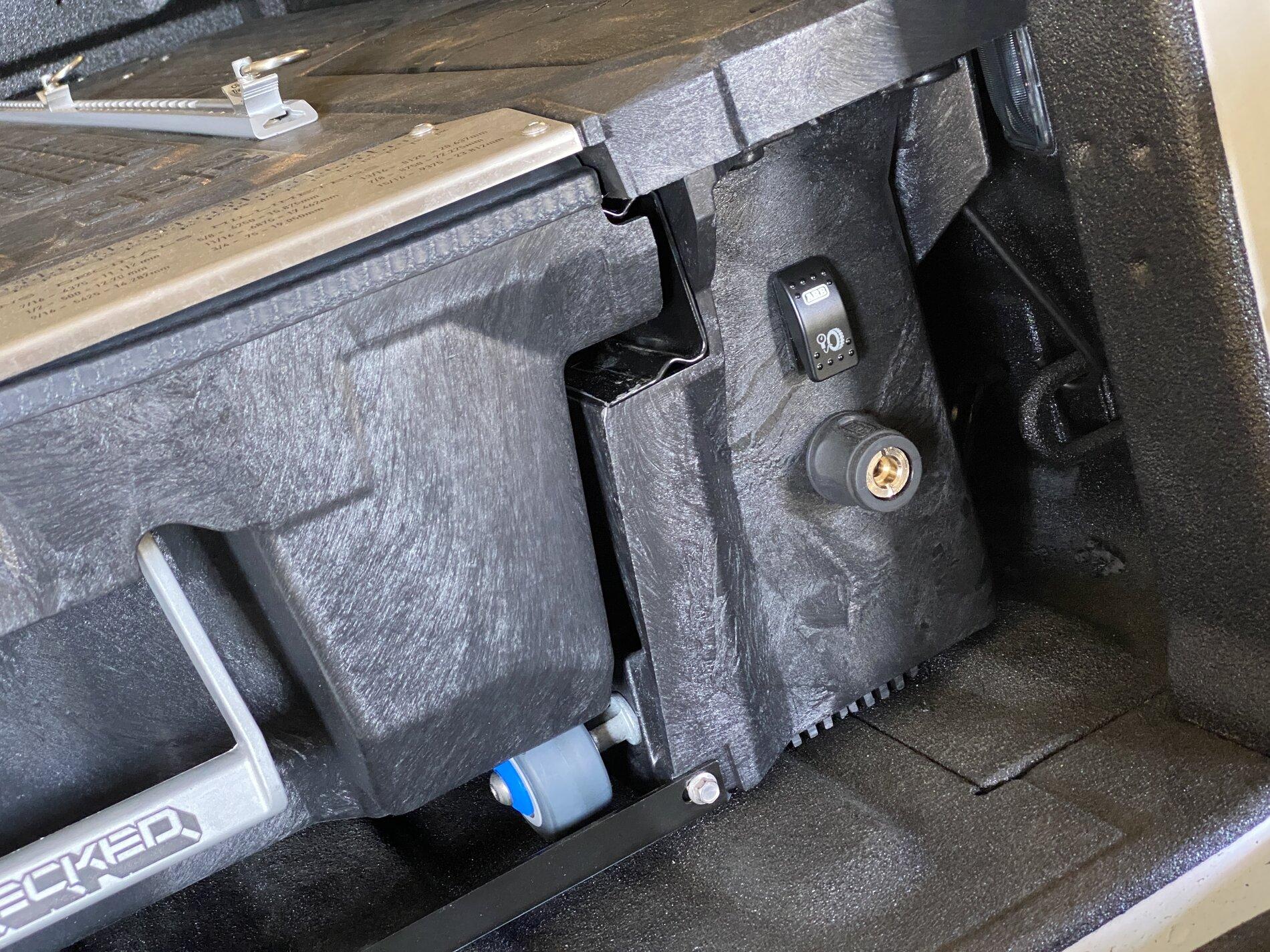

I kinda freaked out when I saw the power wires had two 40amp fuses. So I changed my installation plans and just put a rocker switch near the air chuck. Didn't occur to me that I can extend the rocker switch wires to the axillary switch bank. Anyways, what's done is done, makes more sense to have the switch outside the cab and near the chuck I think.
