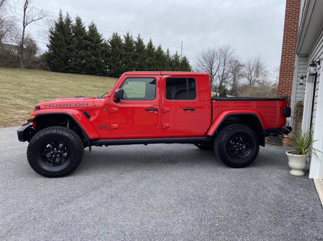

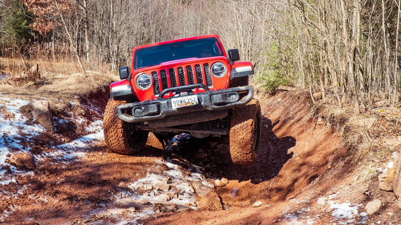

2” mopar and 37 BFG KO2s that measure just over 35 here. we decided to lift and change tires after bottoming alot at jeep week ocean city 2 years ago. this year at OC we had no problems. we have been to a few trails, Peters Mill in Va, Rausch Creek and AOAA.
Green trails are no problem, as well as most blues. Crawler Ridge was easy with a Offroad Consulting guide. Crawldaddy, no way i was gonna try it. too many trees right up next to the trail. the crawlin for cops trail is tight! but doable
rides great on the road, tazer calibrated tire size made shifting smooth again, no need for regear.
heres a couple pix

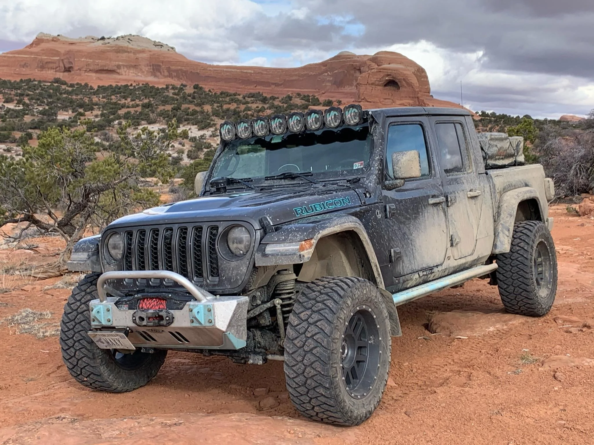

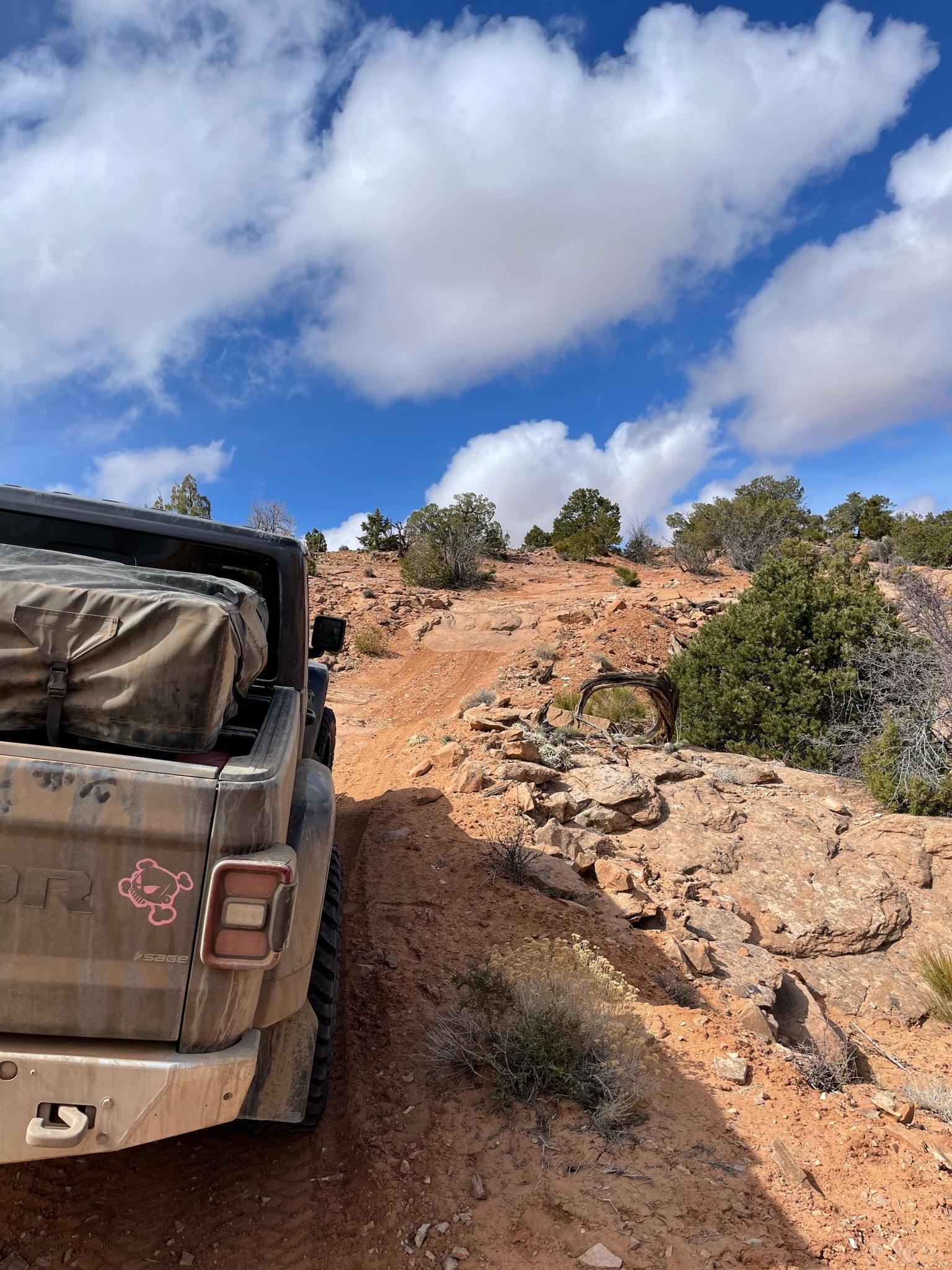

I ran a 3” lift and 35s in Moab, Ozarks, and PA last year. The truck more than capable with minor mods to do 80%+ of trails.
Only recommendation at that height is a hitch skid. It will save you from destroying those poor safety chain eyelets.

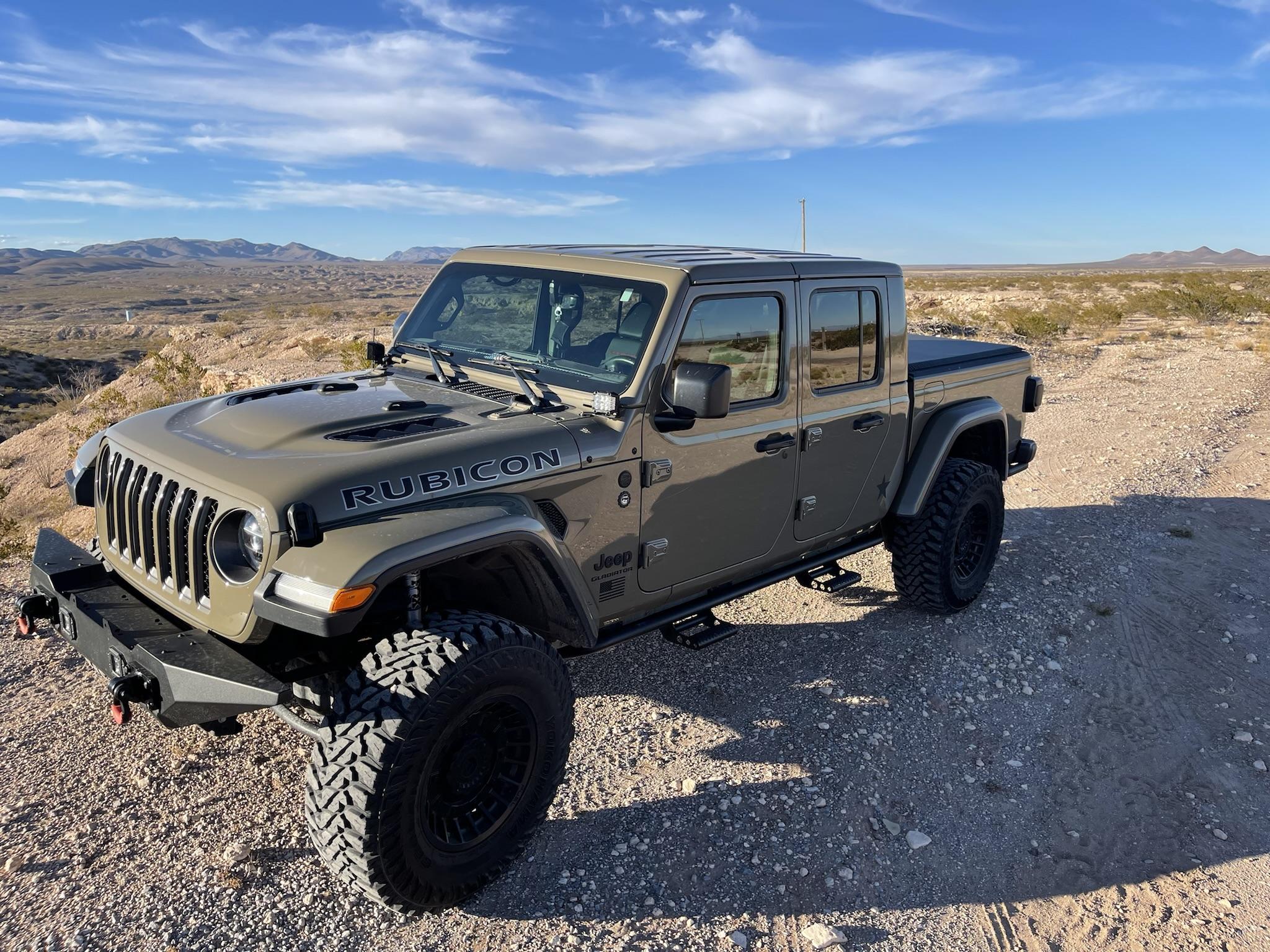

2” Mopar, front/rear track bars, 315/70/17 BFG KO2s and 1.75” wheel spacers.
The extra clearance is nice for mild wheeling, but if you you go out with a club or do more advanced trails you will want 37’s. I brought these over from my Mojave trade in. I’m wanting 37’s so bad, but can’t decide if I will stick with KO2s or switch over to a MT.
