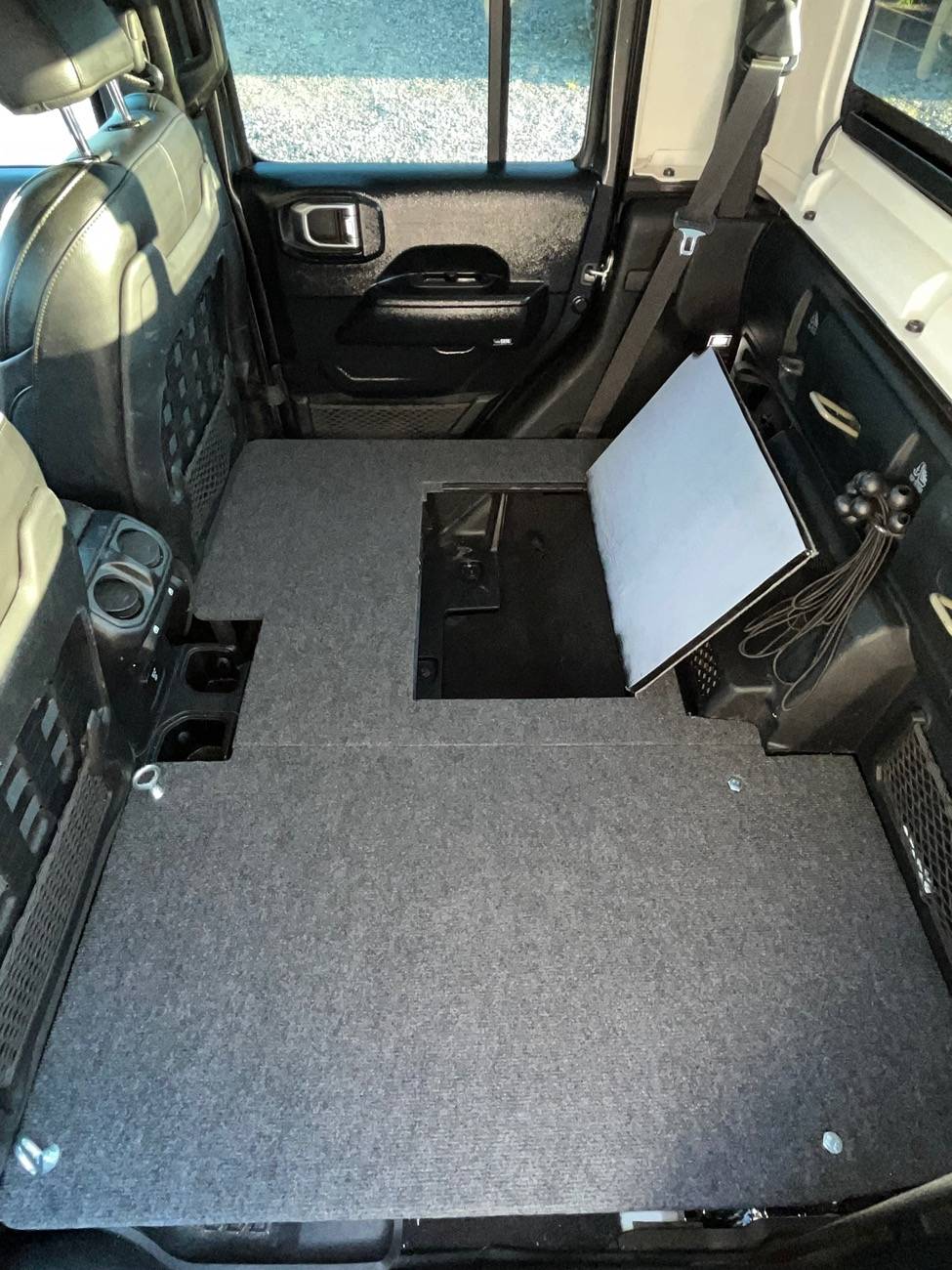

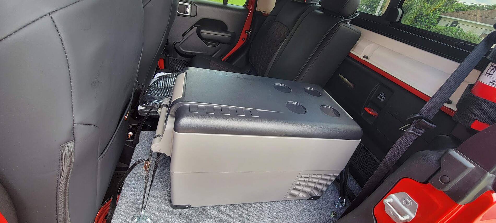

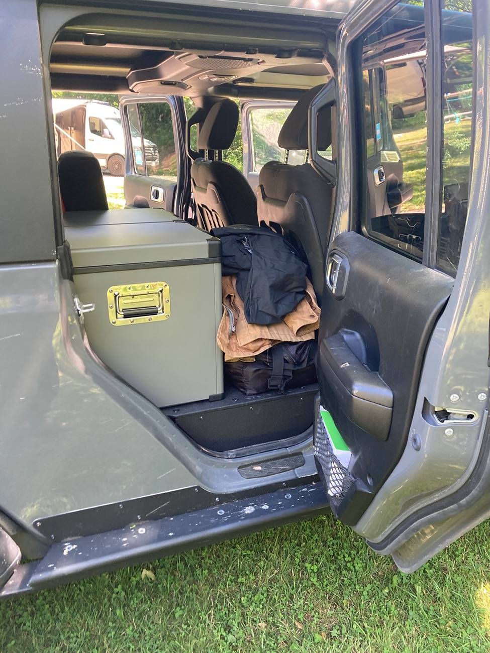

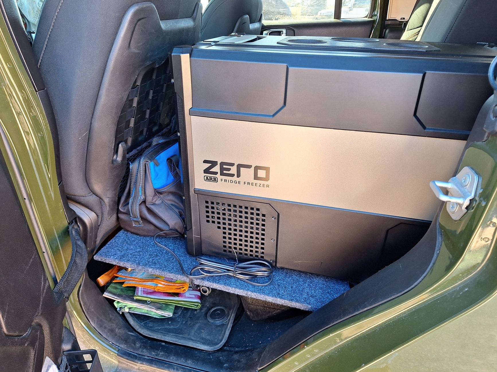

Here is my budget setup: Did a 40% delete with 1/2" plywood covered with outdoor carpet. The fridge is a 37 quart that has carried enough food for a 10 day trip. I like having in the rear seat vs the bed of the truck as I carry a lot of gear and need all the bed space I can get. Having in the rear of the cab it definitely uses less power and holds temps better.
Jeep Gladiator Who's running a fridge in the back seat? 1738182455857-57
Jeep Gladiator Who's running a fridge in the back seat? 1738182411774-j4

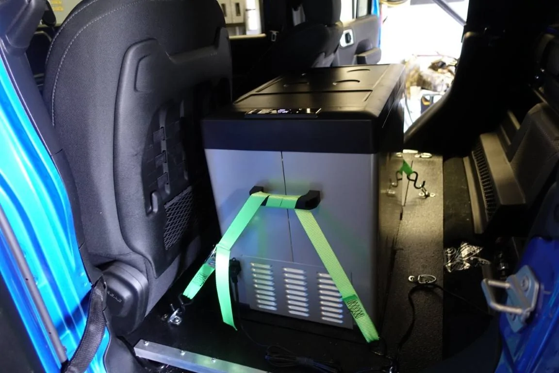

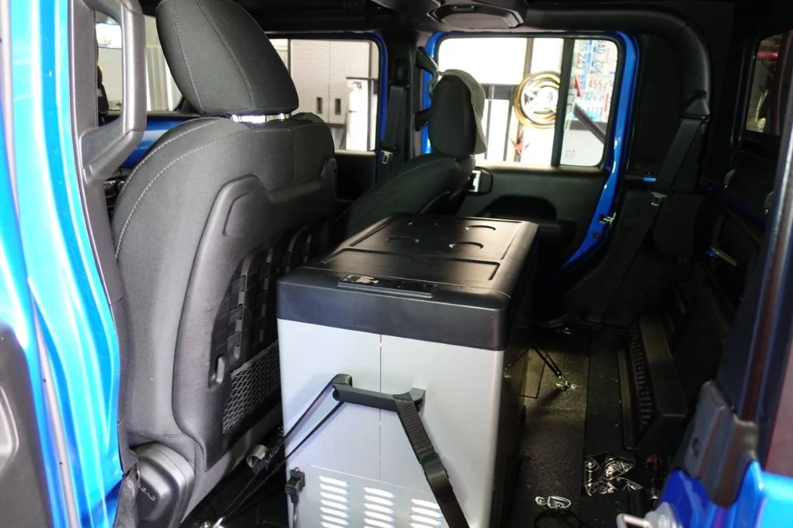

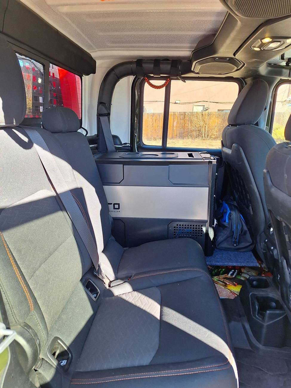

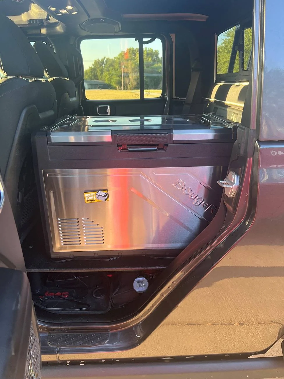

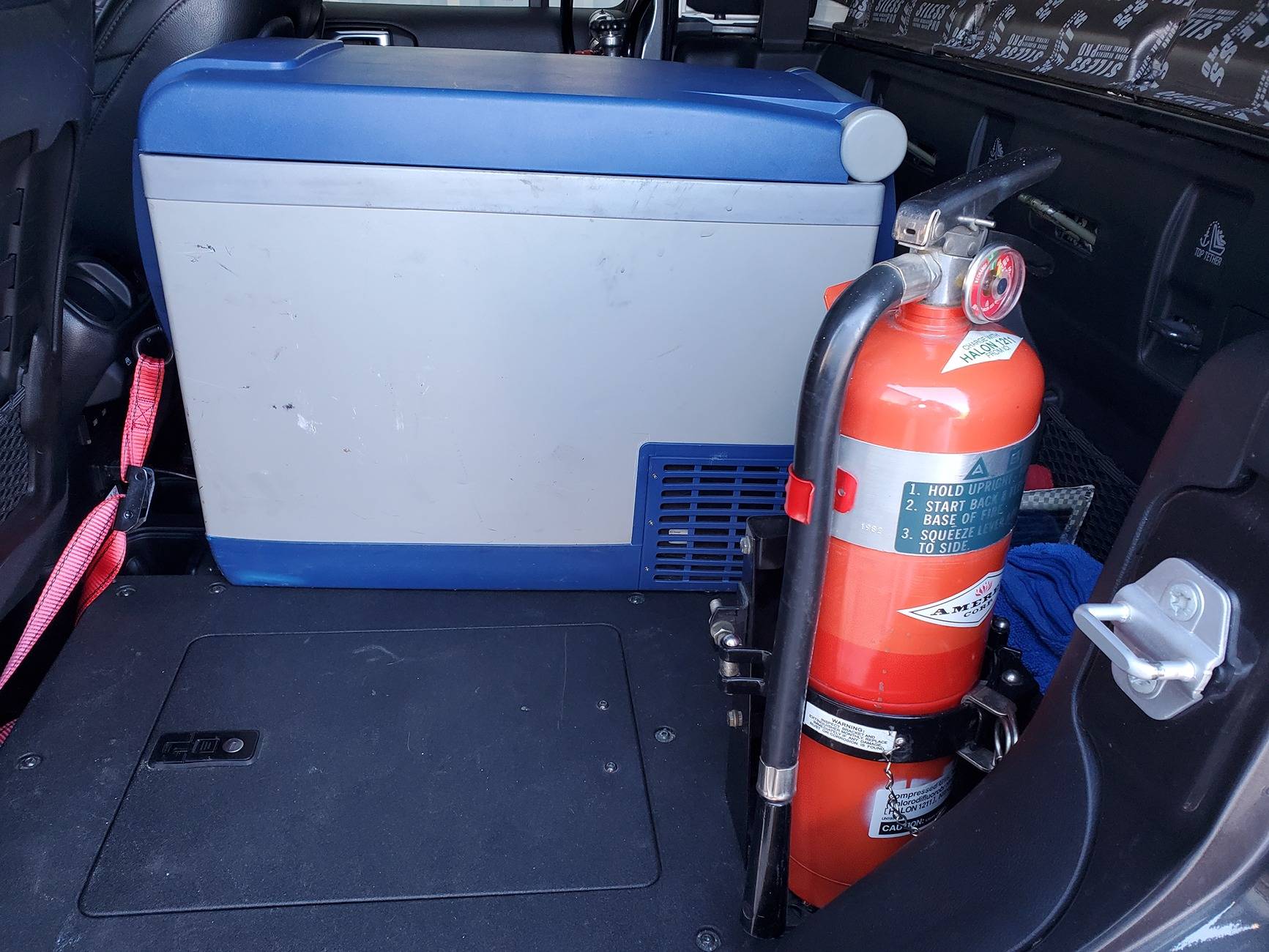

After running one in the bed for some time, I prefer in the back seat. Just for the very reasons you listed. I created my own seat delete with the 1/2" Plywood then a little roll on bed liner. Took the opportunity to install 2-50ah batteries underneath and a 20a DCtoDC charger. I had the batteries from a different vehicle that needed the smaller footprint so I reused them. I have since arranged the fridge across the width rather than front to back, so I can recline my seat more.
Jeep Gladiator Who's running a fridge in the back seat? Fridge

What size fridge is that one? We looked at those but we're unhappy with the inability to switch the sides of the fridge and freezer.

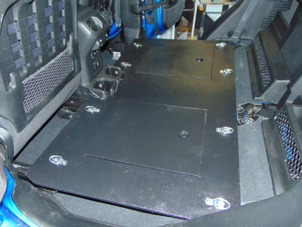

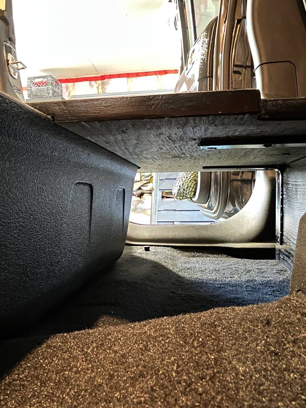

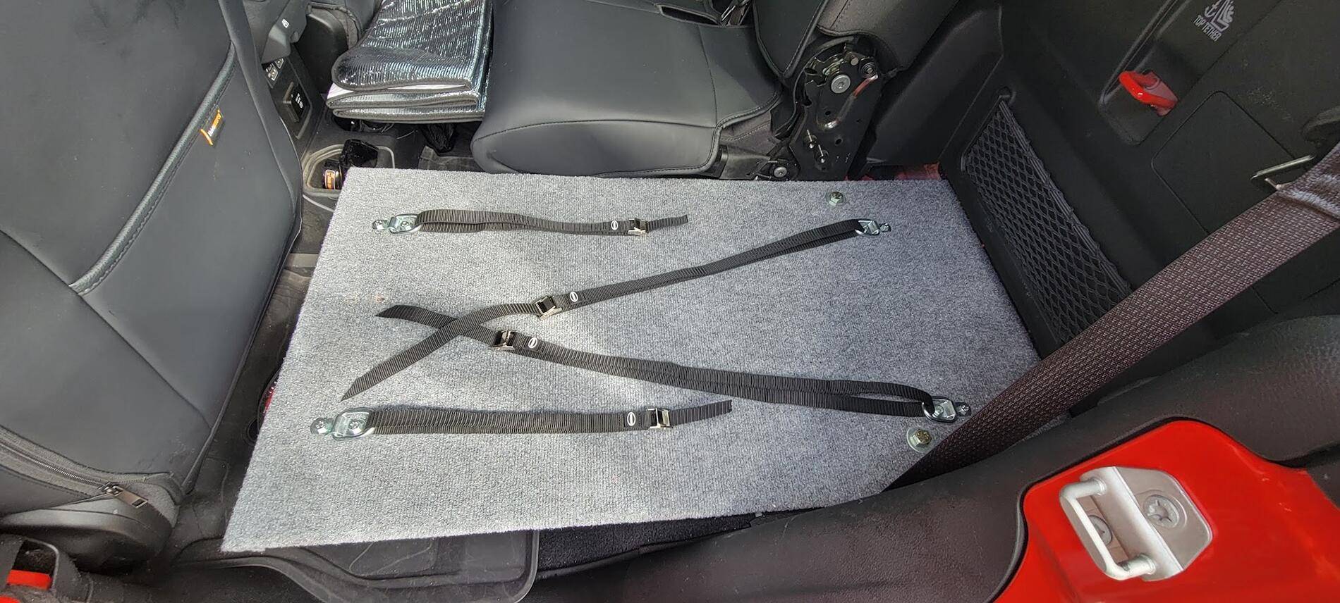

I did my own 40% seat delete because at the time, all the others require the removal of the factory storage tray, which meant stuff would slide out from under the seat on the 60% side. Or you had to remove the fridge to access the space. I also removed the tray behind the seat so that my fridge sits back a little further. I also went with the ARB Zero as the compressor sits in the front so it has better air ventilation. I keep it at 35° and it has been working great for over a year now.

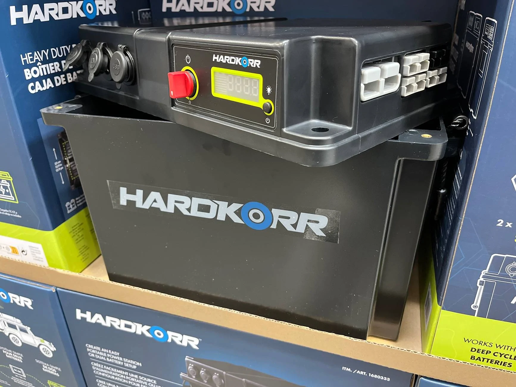

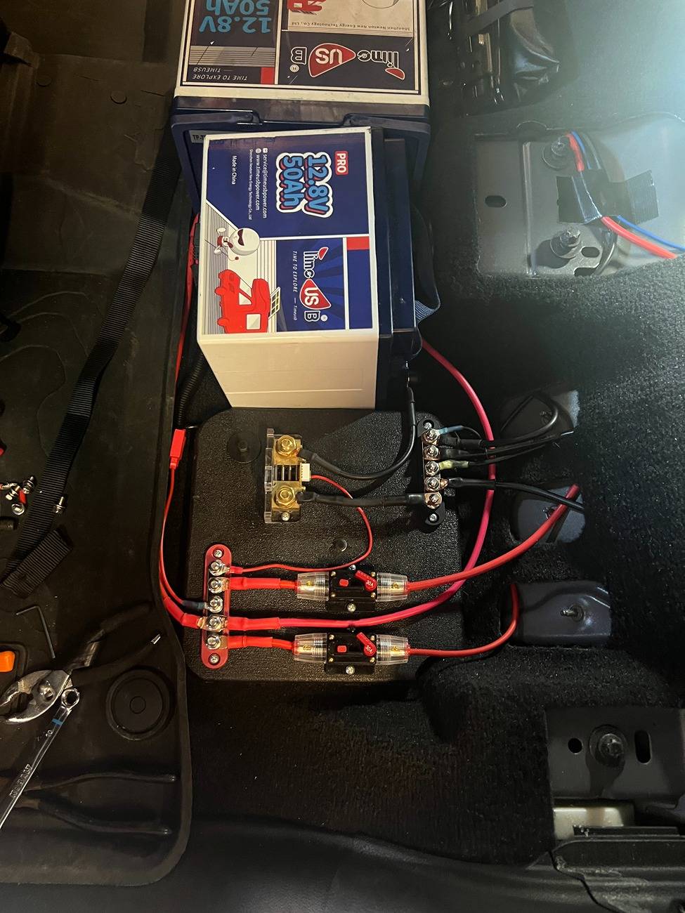

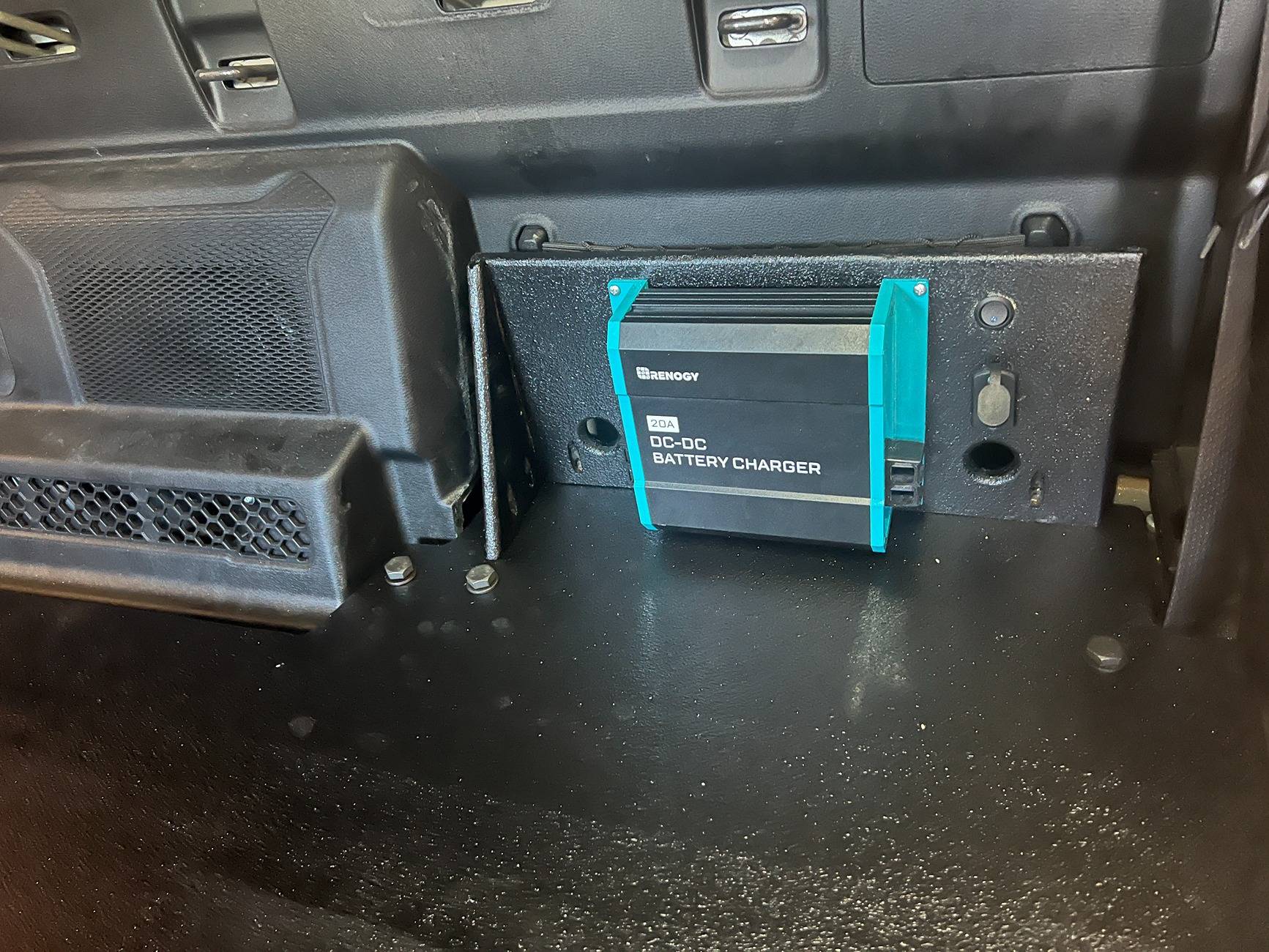

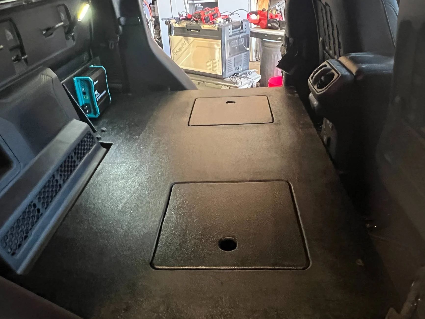

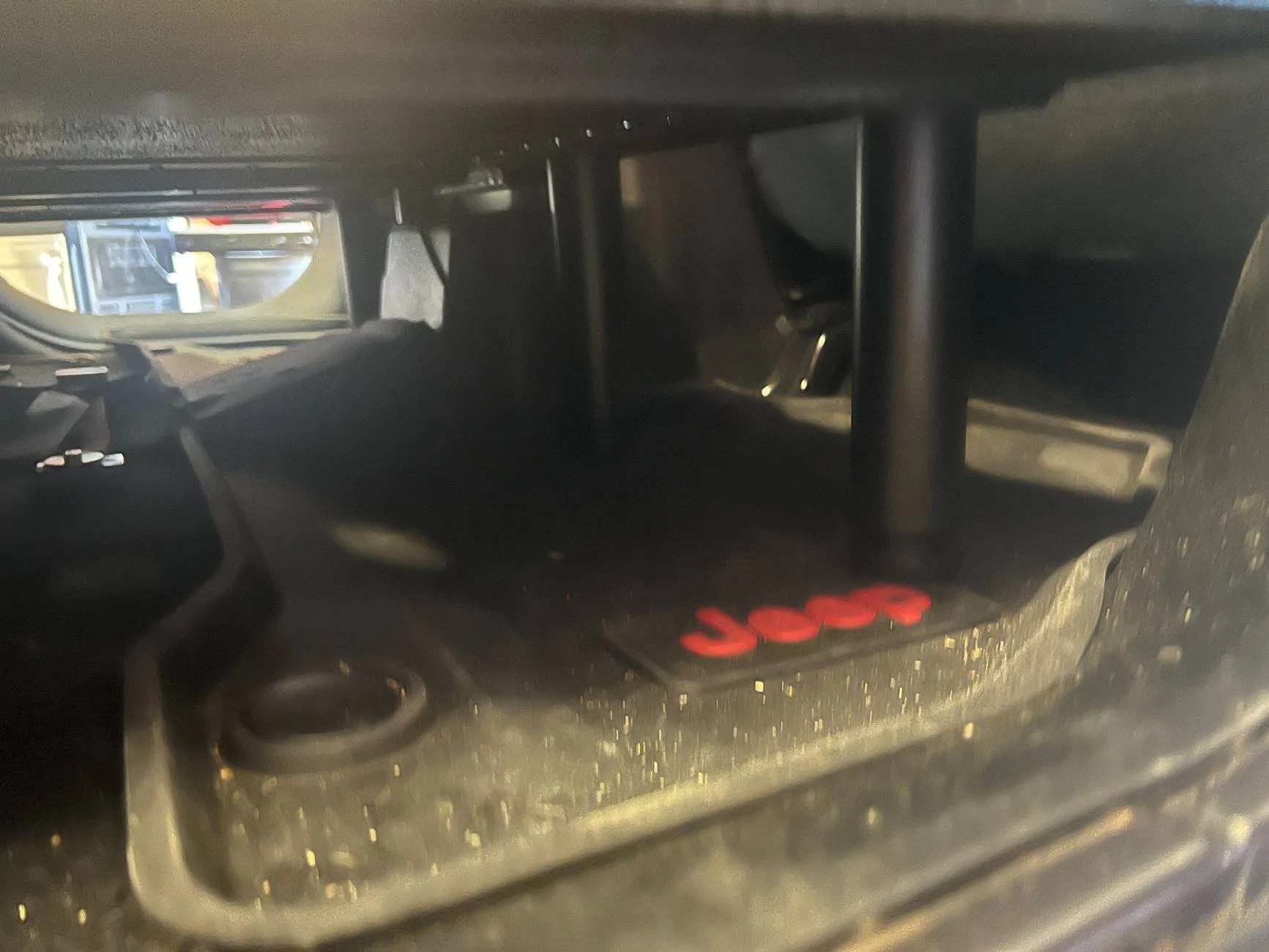

Like most these post. I did a 40% seat delete as well. Made my own platform. I plug a Jackery unit into the truck plug to charge while I drive. I then plug the fridge / freezer into the jackery to keed it cold when outside the jeep exploring the hiking trails and to keep it running during the evening while camping. Hasn’t failed me for the last 3 years.
It’s the 55 qt. Had a 75Dometic and you’re right it’s not as convenient for the freezer. However I’m still quite satisfied. Went from full size truck to the JT and the 75 was way too big. I probably could have went to the 41 qt that Bouge offers. For less than half the cost it was a concession I could work with.

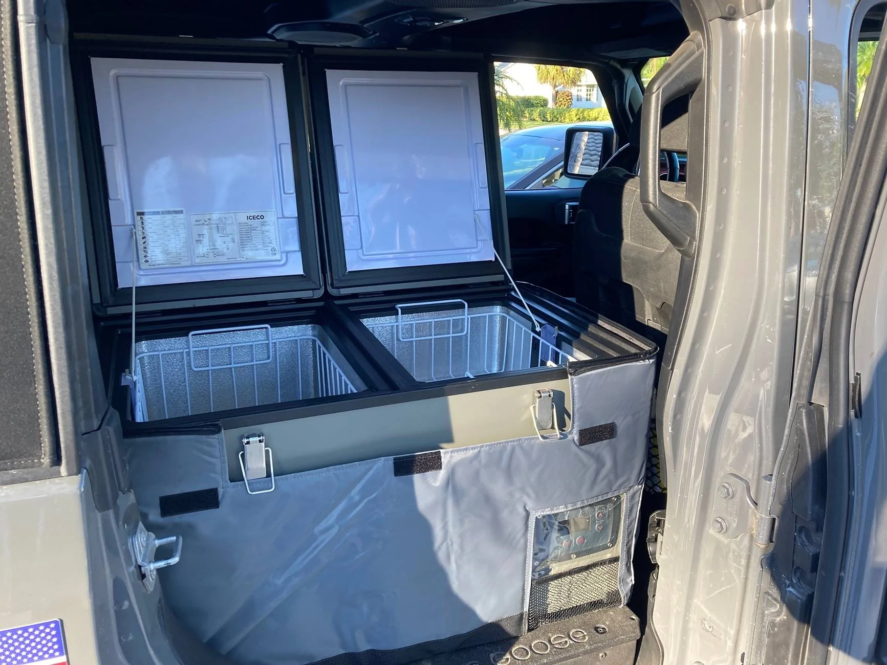

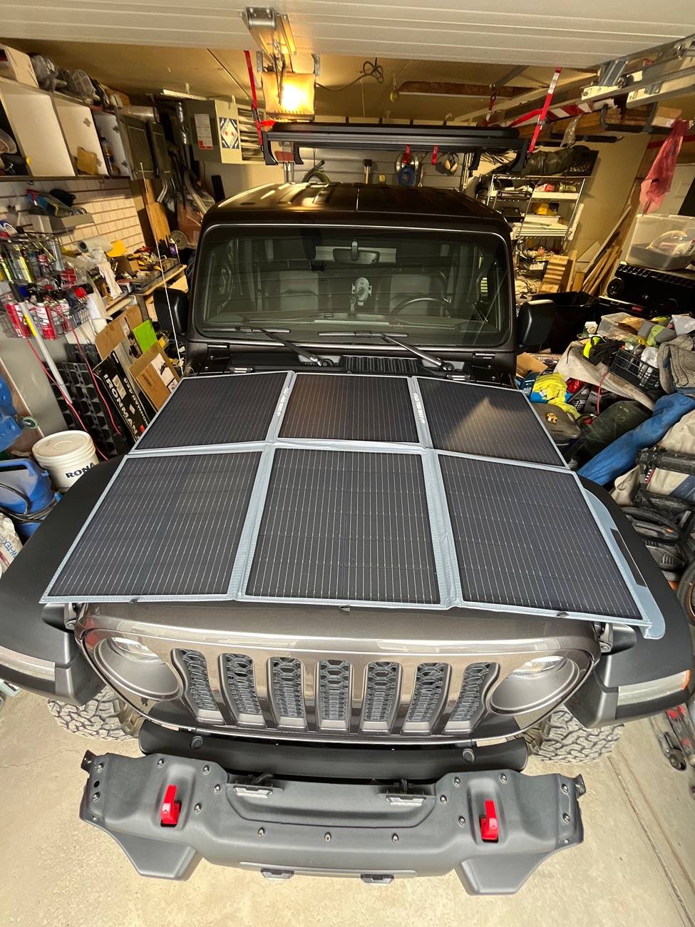

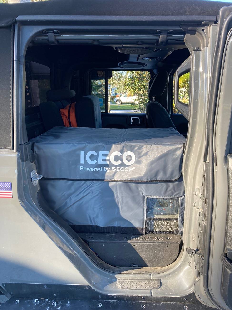

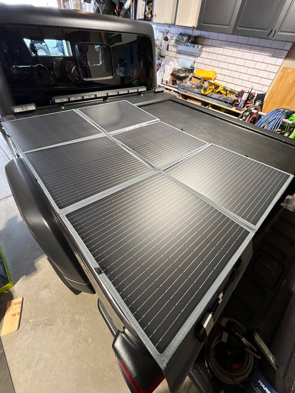

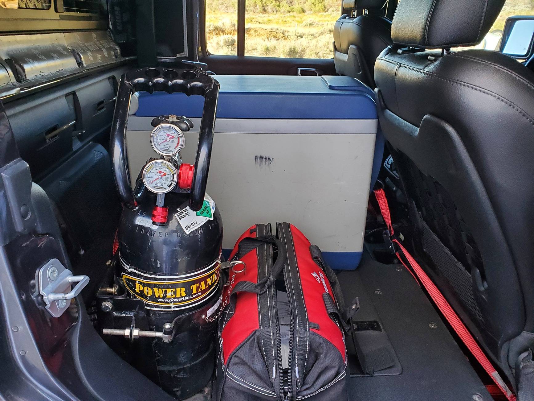

I’ve been running a VL65 on a 60 percent delete for the past two years. I go lengthwise if there’s a passenger. Front to back if no passenger so the front seat can be pushed forward a bit. Power is from a EcoFlow that charges off the inverter while running and solar panels (2x110W) when at camp.
I like the fridge. Temperature can be a little all over the place (usually colder than you target) and power consumption starts to spike when air temps top 90, but it’s been a good piece of gear overall. Definitely get the insulated cover for it. Protects the fridge and keep the temps a bit more steady.
There’s more about power and use in my build thread here, with a use update here.
Here’s a few pics.
Jeep Gladiator Who's running a fridge in the back seat? IMG_3494
Jeep Gladiator Who's running a fridge in the back seat? IMG_3490
Jeep Gladiator Who's running a fridge in the back seat? IMG_1973

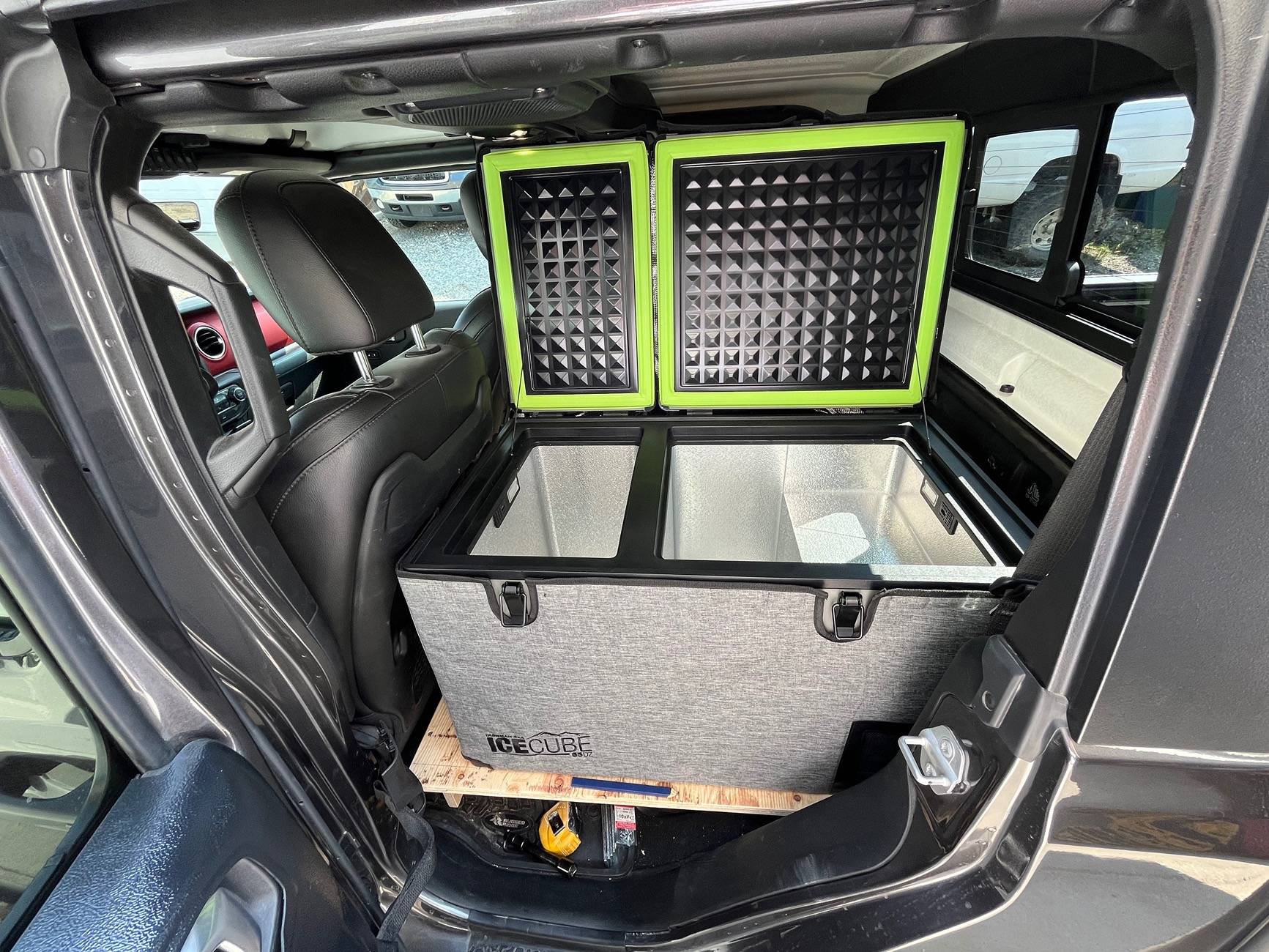

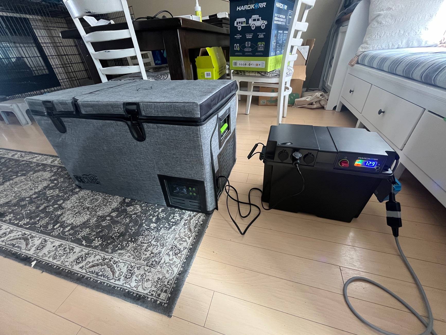

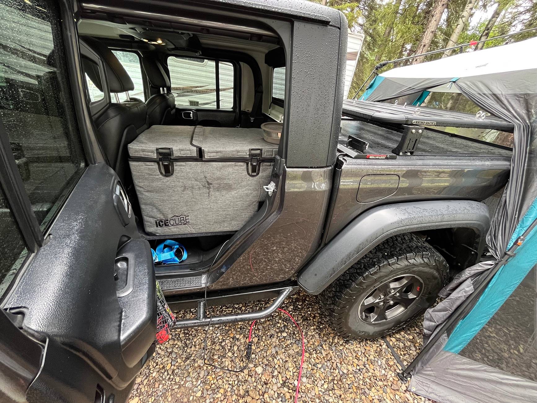

All great reasons you’ve listed. We went with the 60/40 split plywood floor with full storage access in the 60% side. The fridge/freezer is the 65L that fits behind the driver, front to back.
https://www.partsengine.ca/IFRIDGE65K-vp-ironman-4x4-2580.aspx
I’m 6’ and the driver seat is all the way back and I sit quite nice, no issues. The storage tray at the back wall is removed to fit the fridge. This fridge/freezer is zoned, one compartment is larger than the other so you decide which one you want as the freezer.
Before we head out, the fridge/freezer is plugged in at home to get it to temp, then moved out to the truck and is plugged in to the plug jack at the back seat. It’s switched to run in economy mode and stays at temp from there. At the site, it is either plugged in to 110 provided or can run off battery/solar.
We also have a Great Dane which takes up the 60% side.

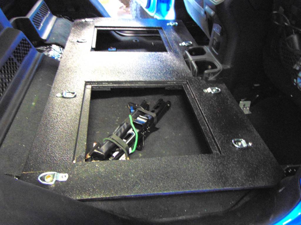

My back seats are gone, found a used Goose Gear platform. ARB so I or passanger can access cold ones or food, I do need to loosen straps to access the large floor lid but its got gear in it that I hope never to need so not really a issue.
