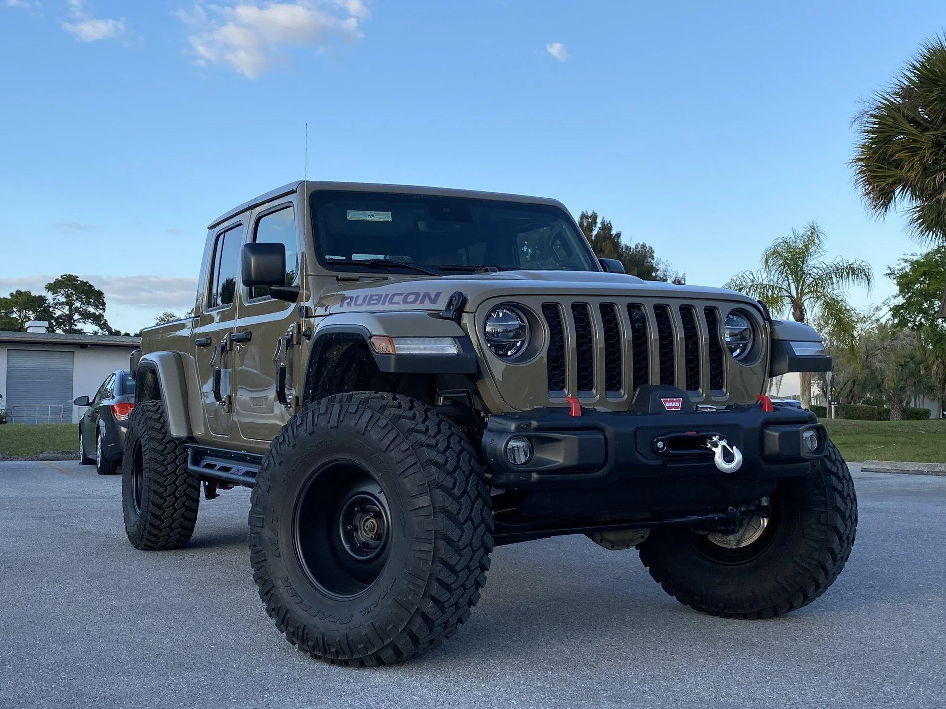

Good reference for wheel offset and backspacing are the AEV wheels, they are 8.5" wide with correct backspacing. You see lots of Jeeps running wheels that make the tires extend well beyond the fenders, IMO that is a bro dozer looks and functionally has no benefit.
Depends on what you mean by "well beyond". Adding wider tires and a lift that may require a certain backspace will give you some poke. My Metalcloak GC 3.5" requires a 4.5" backspace (I went 4.25" for margin of error). I have 37 x 12.5" tires on 17 x 9" wheels. They stick out about 3.5" That is purely due to a functional reason. Although I actually like a little poke myself.
