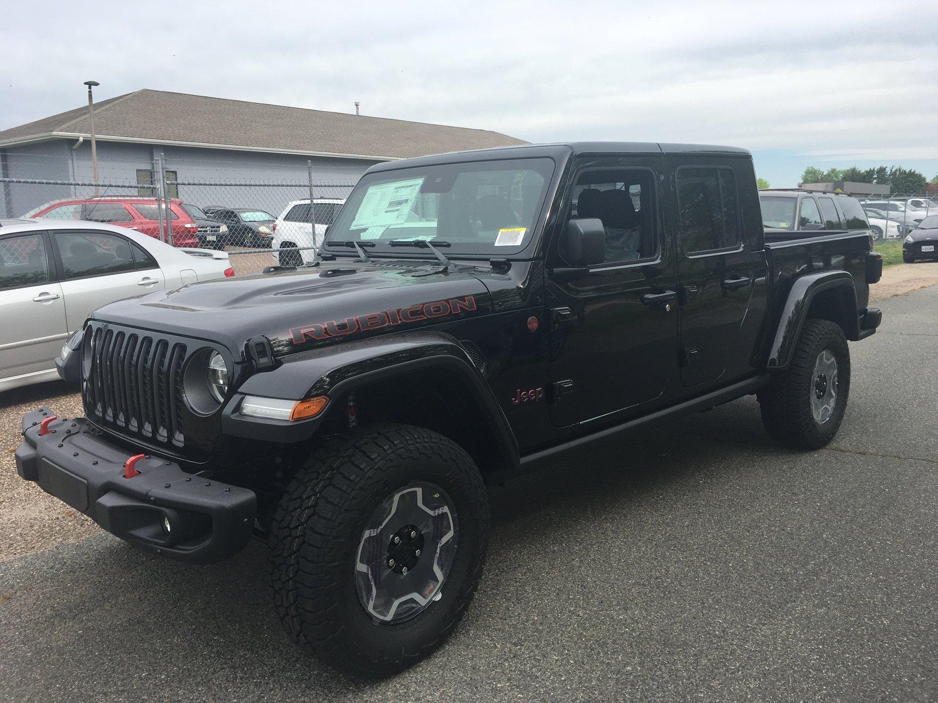

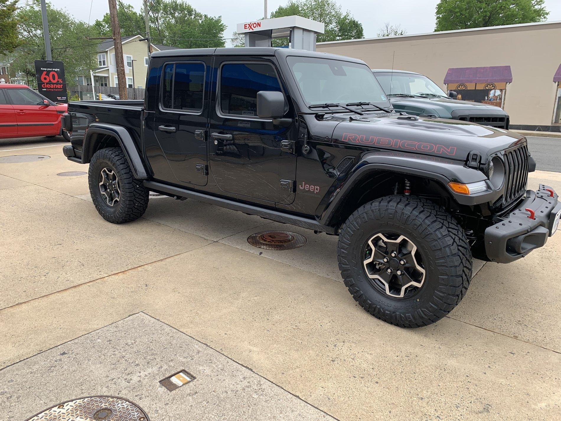

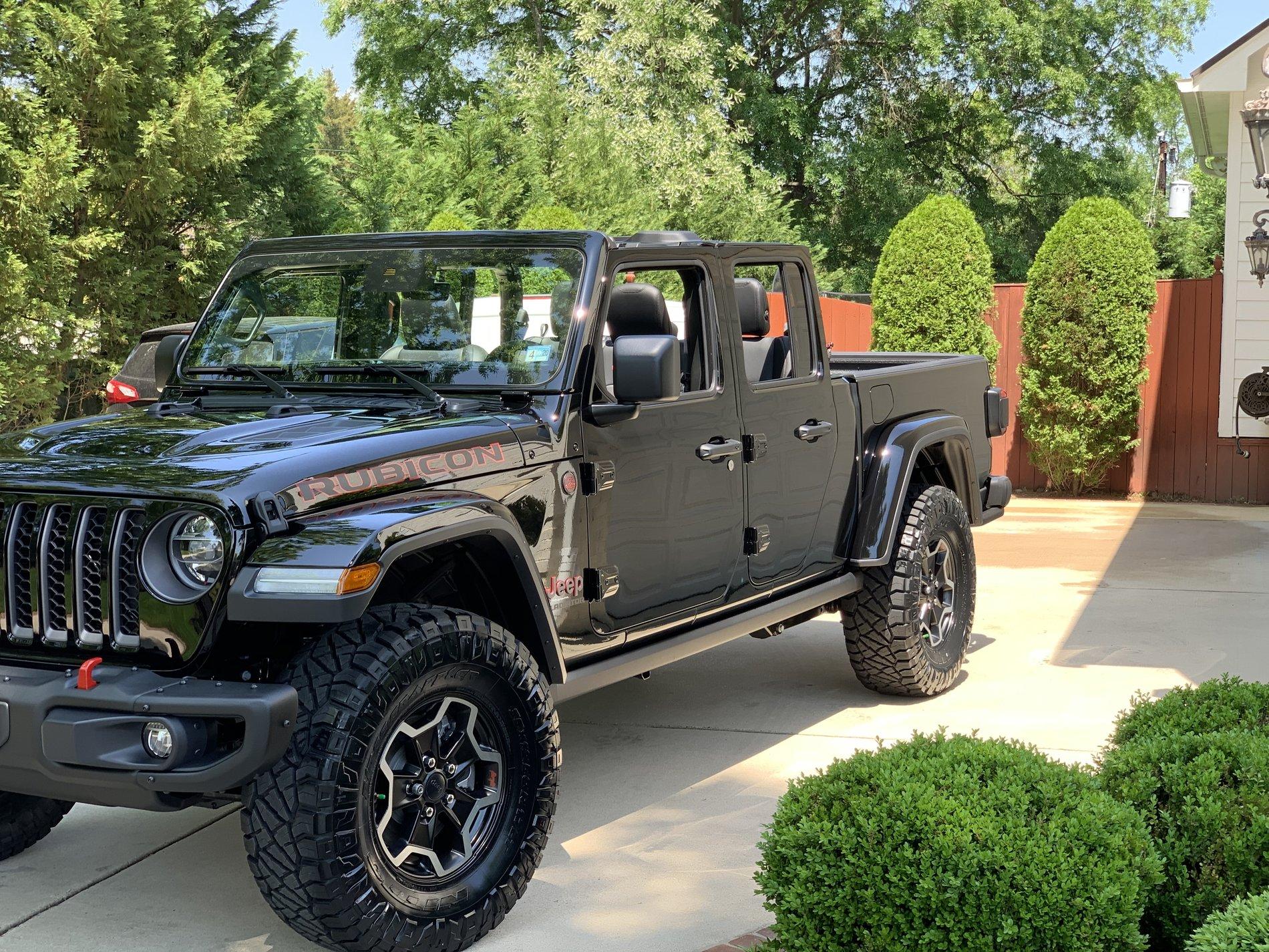

I only have one pic of before which was at the dealership, the first one, the second two are after. Hope there helpful

OMFG!!! That looks SOOO HOT!!!
Honestly man, I know you'll love the lift and the 37s, but these 35s were made for this truck. Holy cow that is one sexy beast. Congratulations. I am very peanut-butter and jealous right now. Especially since I'm probably at least a month or two out from seeing mine.
