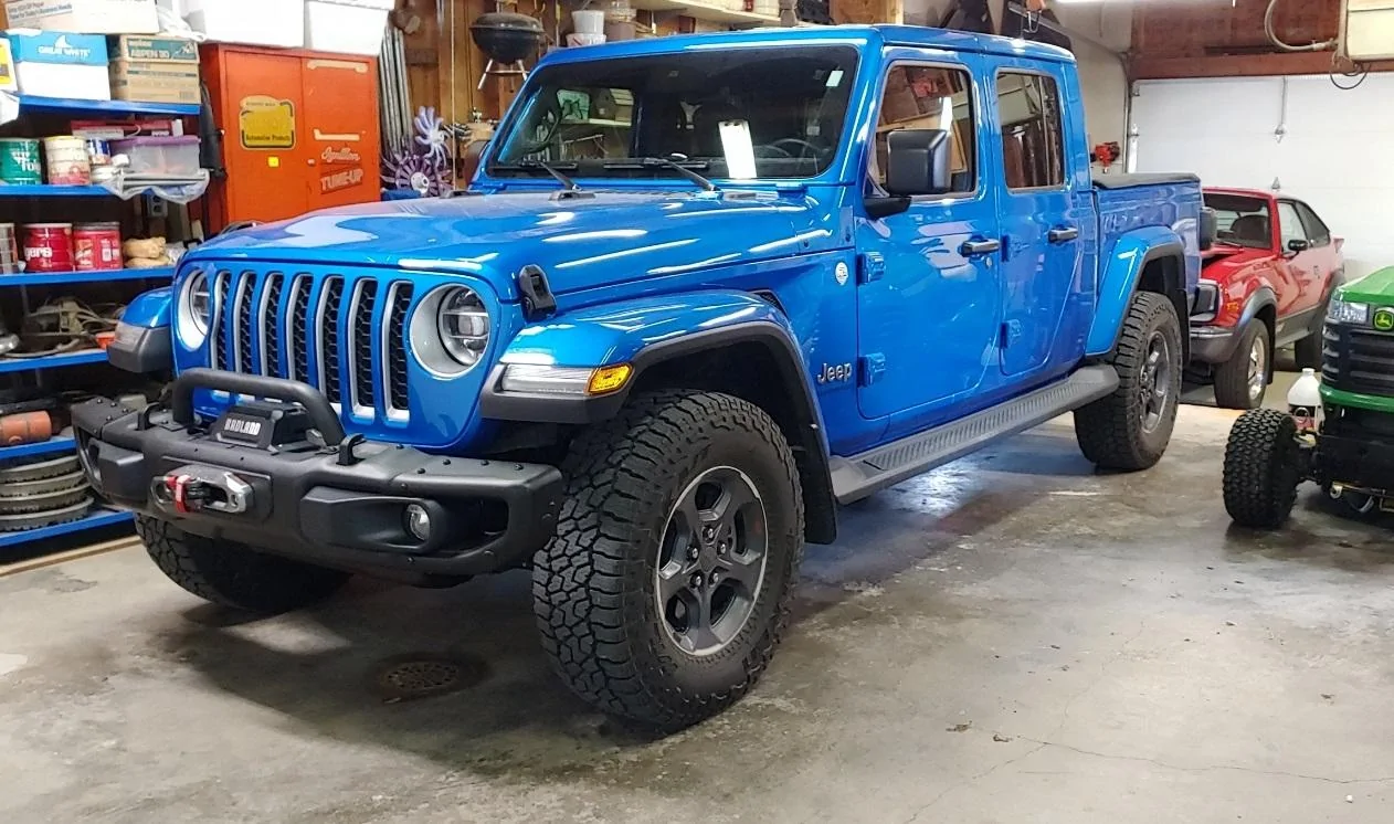

I'd never go over 35 on my Overland without regearing! It's bad enough in hills as it is, especially with any load like a trailer behind it. I don't care if they'd fit and look great, 37 means deeper gears for sure. There's guys that will regear a Rubicon with 37s, no way to put them on a stock Overland without never again seeing 7th or 8th gear (or 6th in a manual)
You could put Daystar 3/4" spacers under it and be cool. IMO, 33's fill my wheel openings fine. I don't need it to look out of proportion.
These are "33s" under my Overland which has 3/4" Daystar spring spacers.

If I recall, do you also have Rubicon takeoff suspension? or is it just the tires/wheels?
180
29,491
35,096
Front springs from Rubicon. But the winch, bumper and skid plate took .5" off of the gain.
Front Rubicon springs added about 7/8"
Winch and other stuff took .5" off of that - leaving 3/8" gain from those springs.
So I put 3/4" spacers in - giving back the loss plus 1/4".
