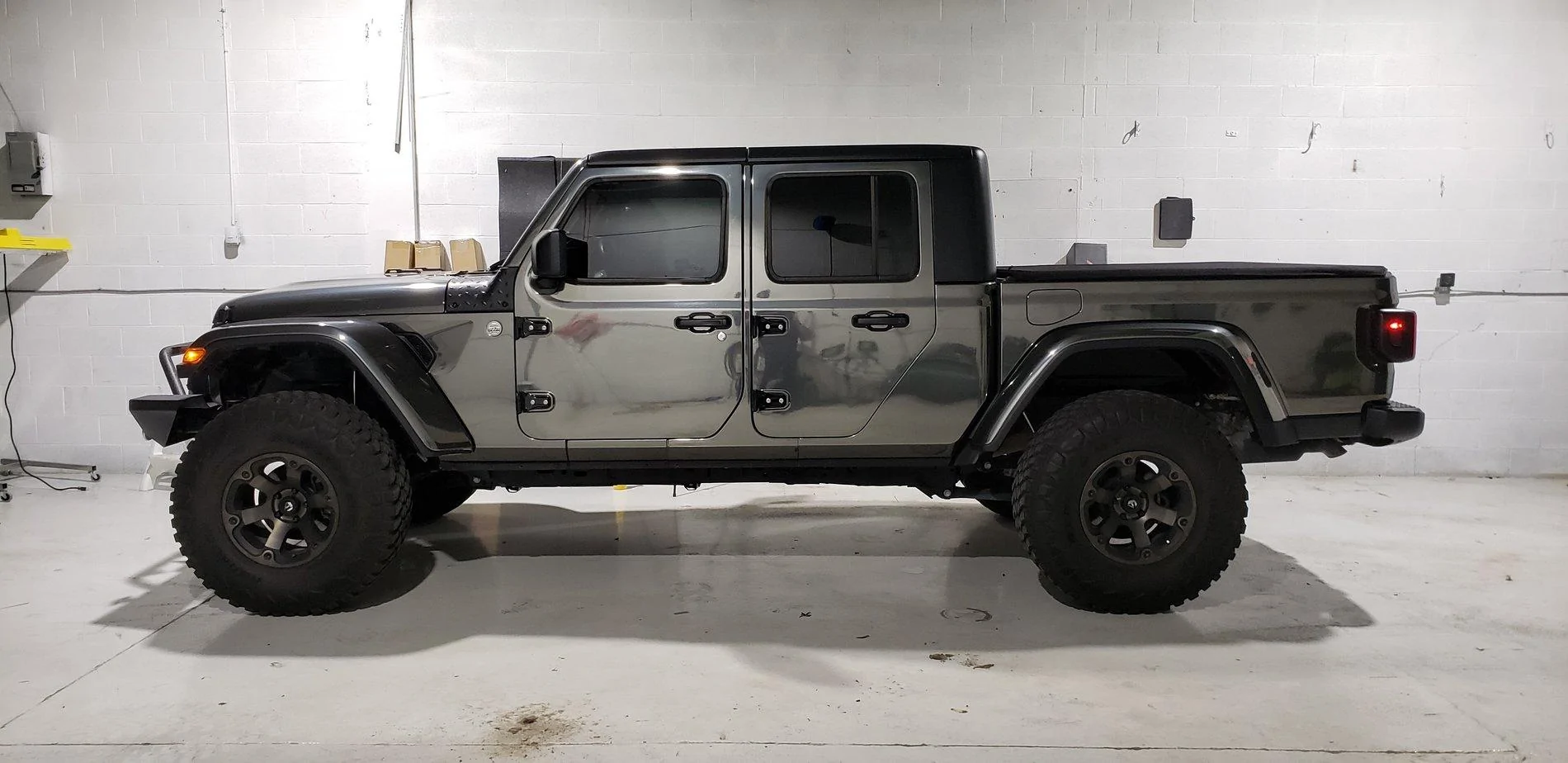

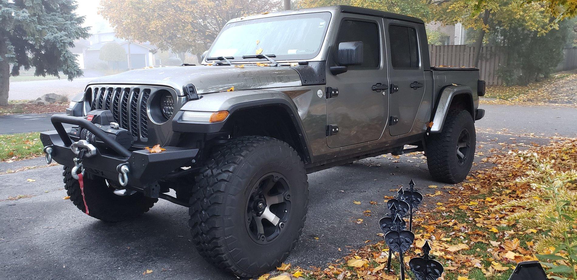

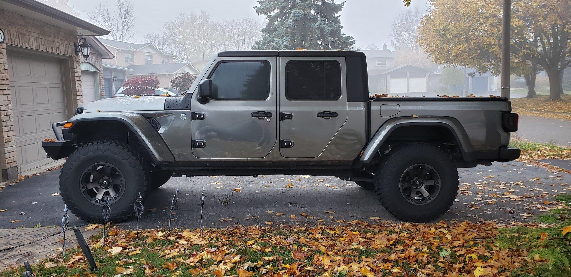

Yes, I have the Rubicon fenders and led indicators now installed on my Sport and it raises clearance by 2". Needed the Tazer mini to get the indicator lights working. Tried flashing the ECU at the dealership but they couldn't get it to work.

Wow!! That thing looks sharp!! Where did u get the fenders?

Thank you, I ordered them from the dealership
