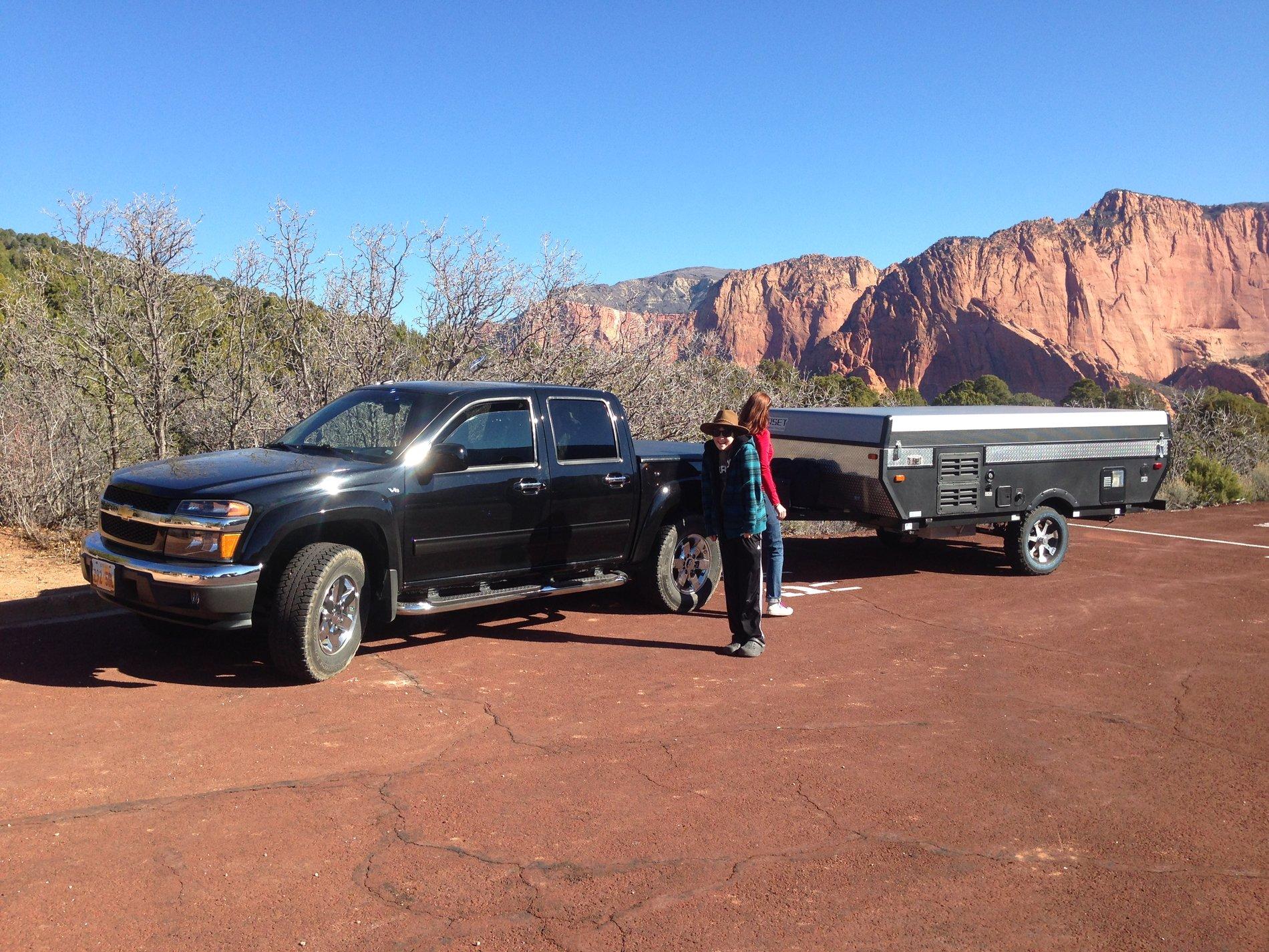

Had a soft top Land Rover D90. Always need a pickup. I would love to have the best of both worlds in one vehicle. I’m currently using a V8 Colorado to pull a 4600 pound off road (Evolution E3) . The 5.3 V8 does a fine job. Doing the same task with a 3.6 V6 might be asking too much in the western mountains. A Gladiator would most likely be used for five or so towing trips a year. The rest would be mostly in town light city driving. Hate waiting for a diesel but I’ve never had a Pentastar V6 before. Is a Gladiator really a good idea? I really want one.

Believe it or not, that trailer crosses the scales at 4,600 lbs. Two 6 volt batteries, 51 gallons of water plus 7.5 reserve. The Colorado has 70psi in the air bags in this shot to achieve level. Yep.. It’s more than double the weight of our previous pop up.
That’s my concern. Especially when they’re saying the manual holds you to 4,500 lbs.
