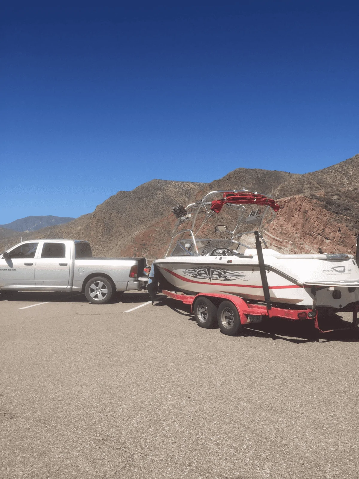

I am thinking about buying a 2021 Jeep Gladiator Rubicon with the Diesel in it. I will get the tow package. I am worried if it will comfortably be able to tow my boat or not. I have not weighed the boat, but the owner's manual says it weighs 3,190 lbs. I am assuming this is without the trailer. I tow my boat to the lake about once a week with a round trip here in Arizona of about 100 miles from my house to Bartlett Lake. My boat is a 2006 Correct Craft Super Air Nautique 210. Does anyone tow a similar boat with their diesel Gladiator Rubicon? I currently drive a 2012 Ram 1500 with the 5.7L which tows the boat great.
Please let me know before I make a mistake. From what I read and see on YouTube I think it should be fine, but I am not 100% sure. Any advice would be appreciated.
Thanks!

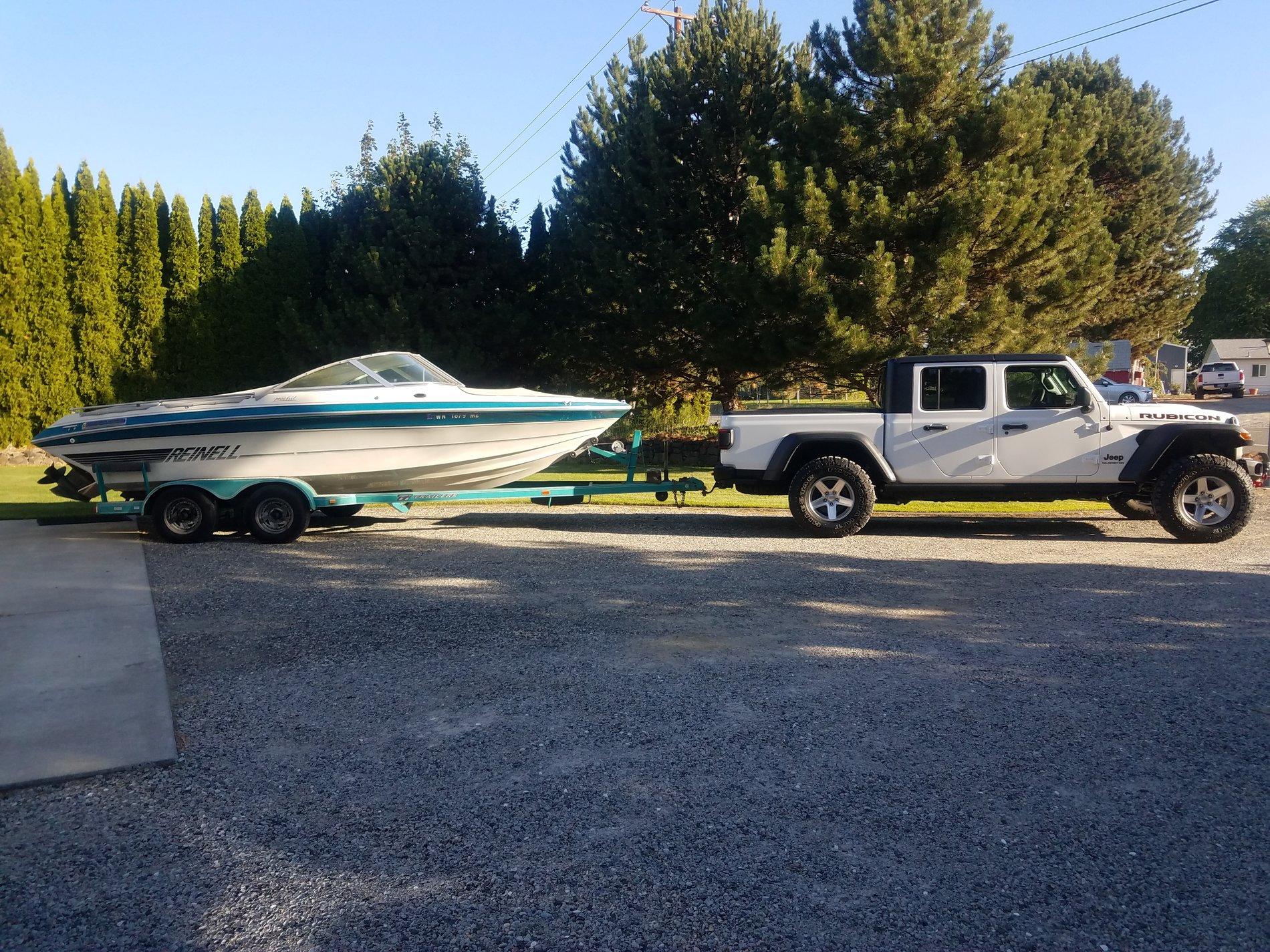

I tow our older 20' open bow with our gas powered JTR. I'm not sure exactly what the boat weighs, but it's a big fat pig with a 5.0 liter V8 in it. I can definitely feel it back there, but it tows it fine. I actually like towing it better than the 2001 F250 Powerstroke I sold. Maneuvering around the boat launch and backing it down the side of the house is so much easier. Now towing it with 37" tires, and I can't tell the difference from the 35's in the picture.
Jeep Gladiator Will it Tow My Boat? jeepnboat

The owner's manual probably gave the weight bare, without the gymnasium you have mounted as well as any other options you may have elected. By the location of the trailer wheels I assume that is a straight inboard. They are making some models with a V-Drive and the wheels have to be farther back. Is that a single exhaust in the middle of the stern I see? What powers it?
Anyways I like your boat. I've had three Nautiques and one Master Raft.
