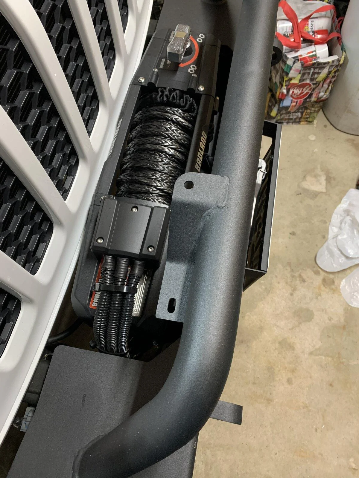

Does someone make a bracket to move the winch controller? I have a smittybuild winch and the bracket that came with it mounts it offset to the left of the winch. I monkeyed with it so that it is somewhat centered, I would like to just hide it behind the skidplate or in the engine bay.. anyone have some ideas?

as stated I messed around with the controller bracket to mount it centered rather then over the left side of the winch.. I just dont like it visable.. someone else mentioned phantom winch and putting the cover back over it.. I like that idea but need to relocate the controller to do so

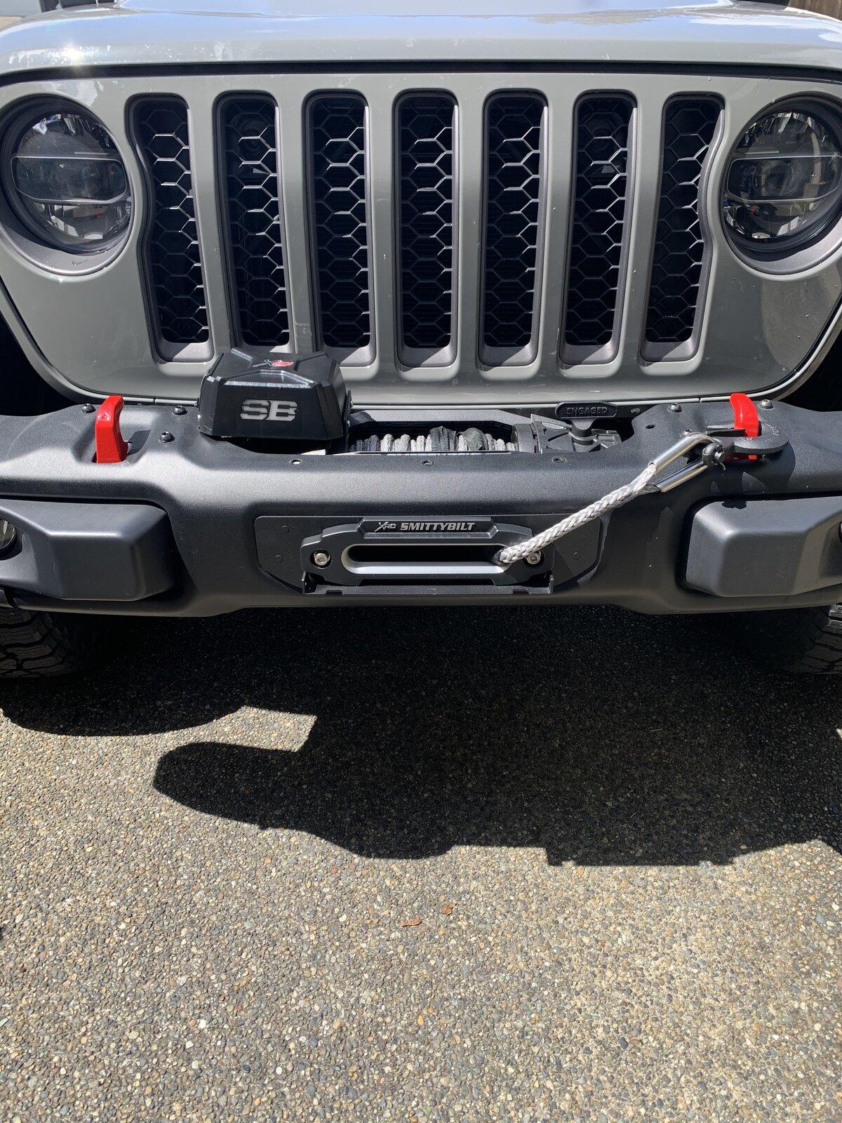

I installed my XRC 9.5k this morning. I agree the mounting of the control box leaves much to be desired. First time doing this, and I was working on a few hours sleep.
1. Instructions were pretty terrible.
2. The flip plate mount I have has to be installed upside down because of the SB marketing (WA requires front plates).
3. There is this ll much space between the winch spreader bars and the grille trim piece. Seriously. Like a 1/32" gap. I have an ATC plate. I would have preferred a little more room.
4. Because of the winch placement, I can't run the control box centered, like my CDO wants me to (that's OCD to most everyone else).
5. The aux power (blue and white) isn't long enough to reach the aux spot in the fuse box. AND they didn't pair it with the positive cable, even though they are supposed to go to the same place.
5b. That blue & white wire? That lights up the SB logo on the controller box... and has to be routed to the AUX block, not the + post, where it would drain the battery. Instructions vs diagram induce confusion.
6. The plastic boots for the power to the winch motor I forgot about, and they aren't mentioned in the instructions (or I glossed over them). So I had to take the winch out and unwire it, put the boots on, and rewire and reinstall the winch.
7. The fairlead bolts only come with 1 flat washer and one lock washer per bolt. Yet the holes are huge, especially on the bumper and the front filler plate. I found some flat washers so I have them on both the outside.
8. The passenger interior bumper nuts are a PITA, but I found I could start the bottom nut with a deep socket, 8" extension, then add a 3" extension, and finally throw a ratchet on it. The top one was similar, but a lot easier. Driver side is easy.
9. For Jeep to think of a lot of things, they missed a really easy one - a vertical conduit for wiring that would be going from the battery to the front bumper.
Now I need to plug the bumper holes (or throw the bolts back in it w/ new nuts); two will be mounts for off road lights. I might look for a better hook setup and get rid of the clevis that came with the winch.
Overall, with hand tools, it took me about 4 hours by myself. It rained last night, so I was dealing with drips. I hate that.
I have a battery disconnect that I'll be adding, so that will allow me to tidy up the hood wiring.

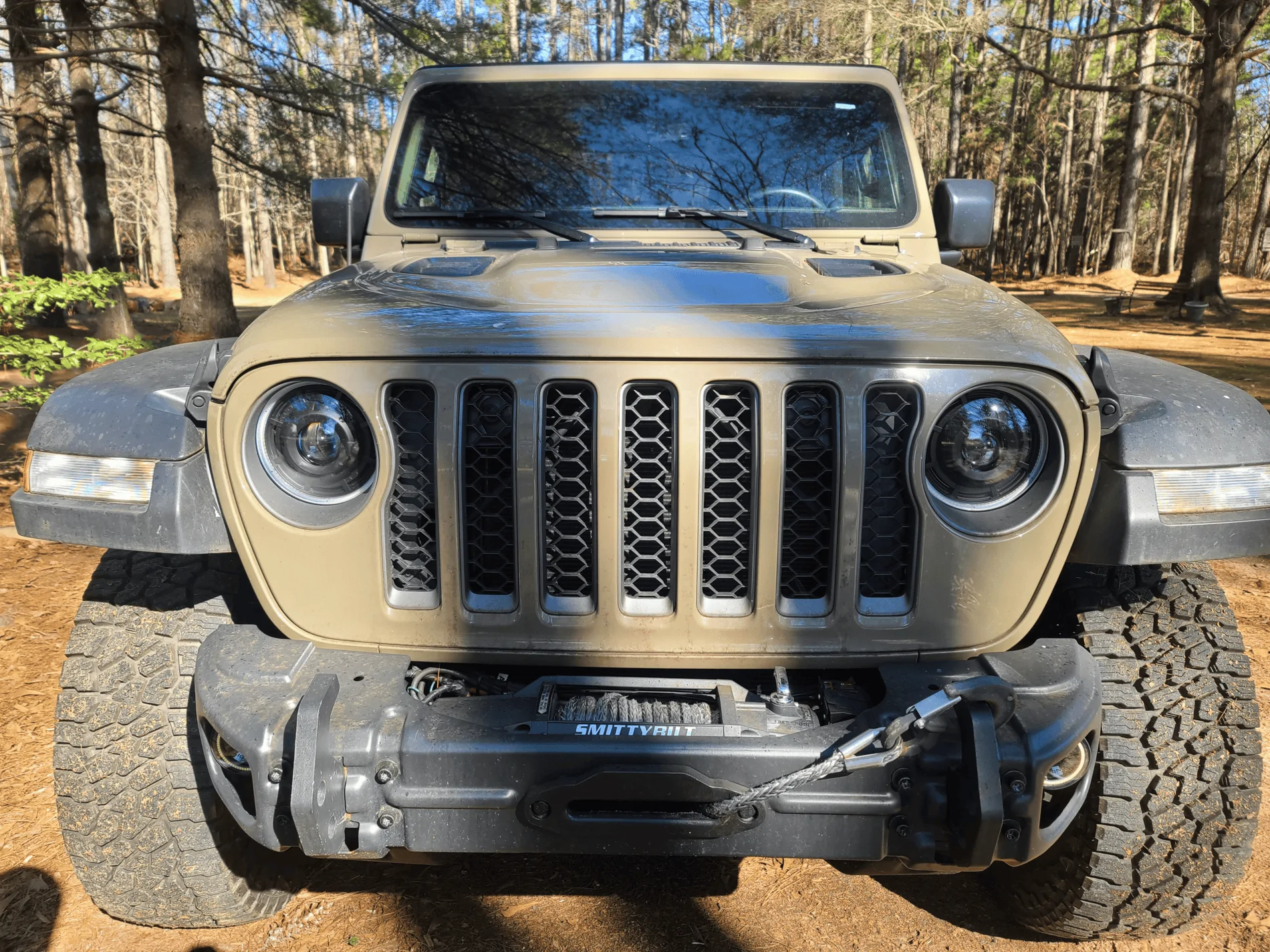

Jeep Gladiator winch controller relocate 1620661042877

Yep I moved the box on mine to the right of it inside the bumper since I had space. I made my own bracket, most expensive part was the wire I needed to make so I could move it.
you can move it anywhere if you have enough wire really. That think stuff is pricey though.

Is that the 9.5 or 12k gen 3? Trying to figure out what will fit in the same bumper.
Not sure on the gen. I know its a 12k that came with synthetic.
