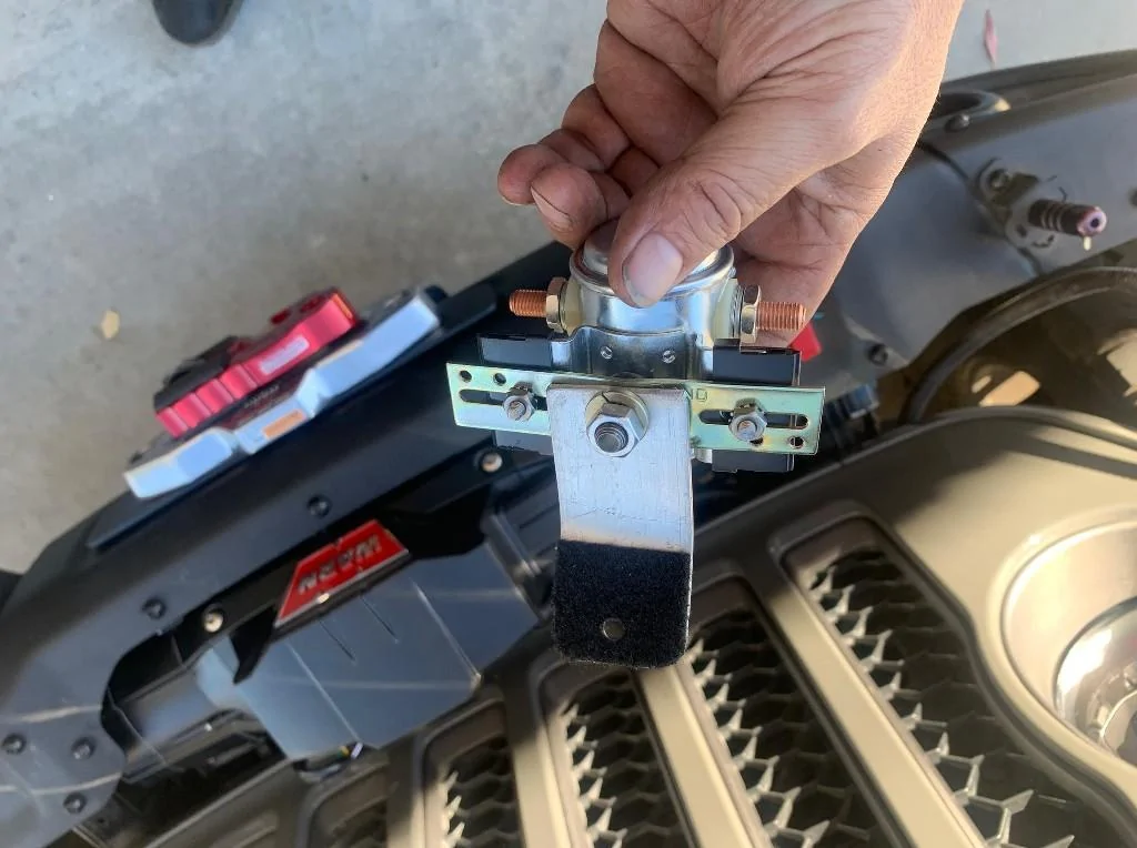

Nice looking Rig ! I just installed my Warn 10s Platinum yesterday with the warn winch plate. I bought the warn power interrupt kit that I plan to run off my Aux switch. It is a solenoid that interrupts power from the battery cable. I plan to do that today before the playoff games start. I am making an aluminum bracket for the solenoid to attach to one of the bolts near the back of the fender. I will attach some pics and outcome tomorrow.

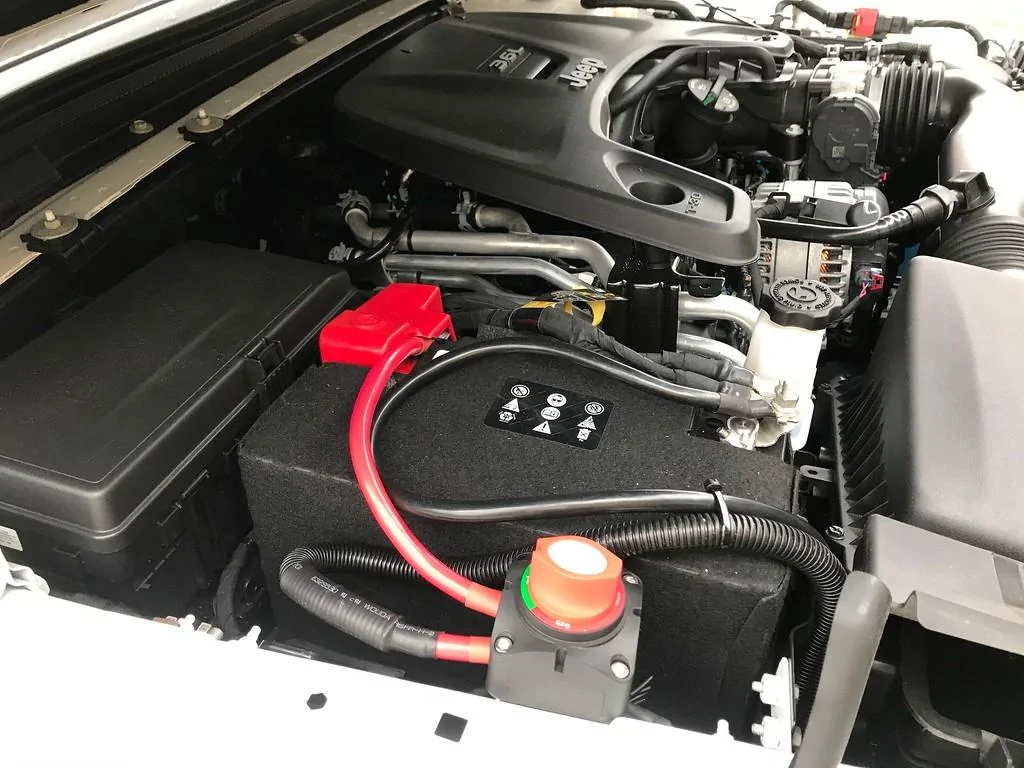

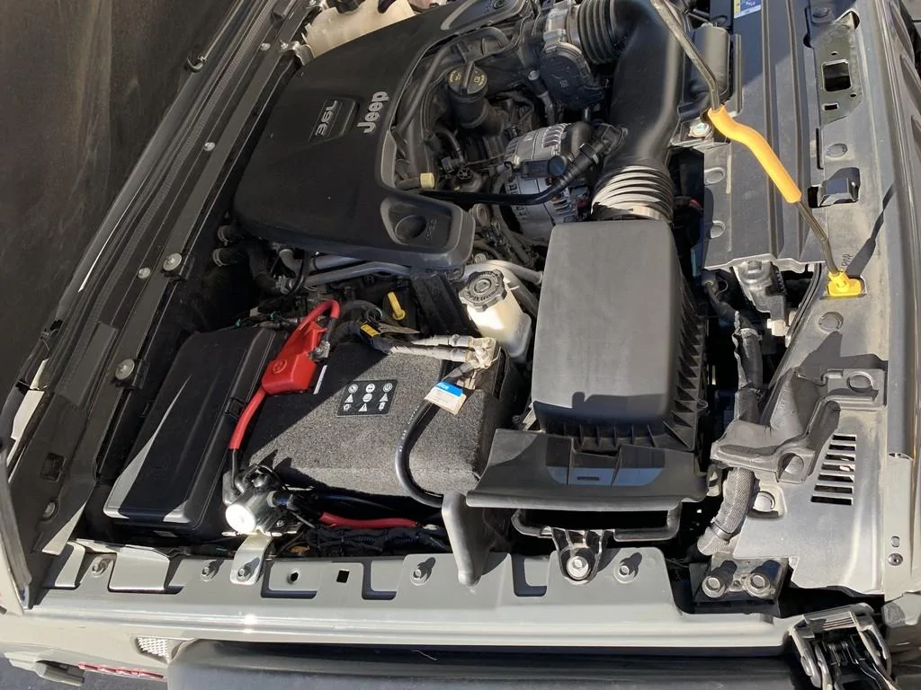

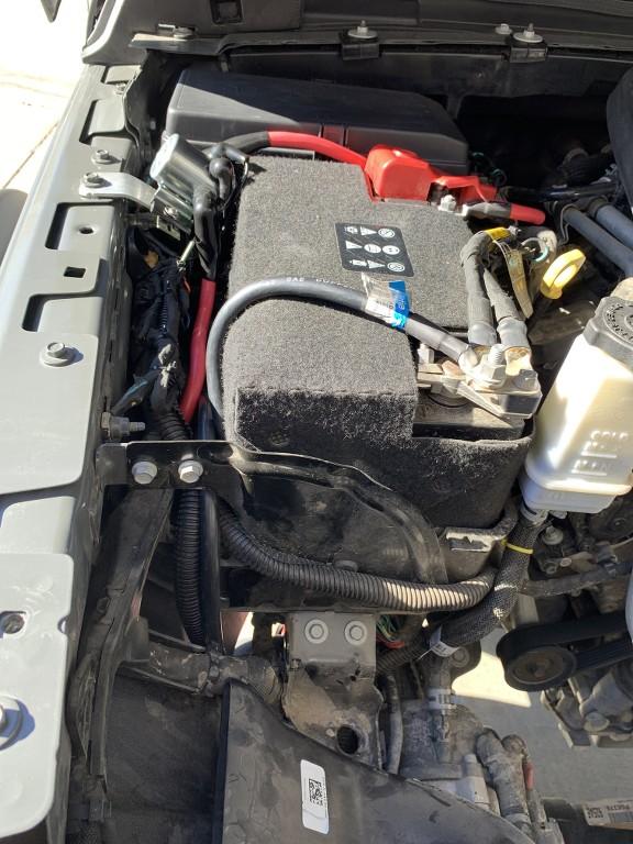

I installed the Warn 10s as well with the Warn interrupt connected to the aux switches. Here is a pic of everything installed. I have a diesel, so the battery is in a different location than the gassers.
Jeep Gladiator Winch disconnect switch 20201121_150019

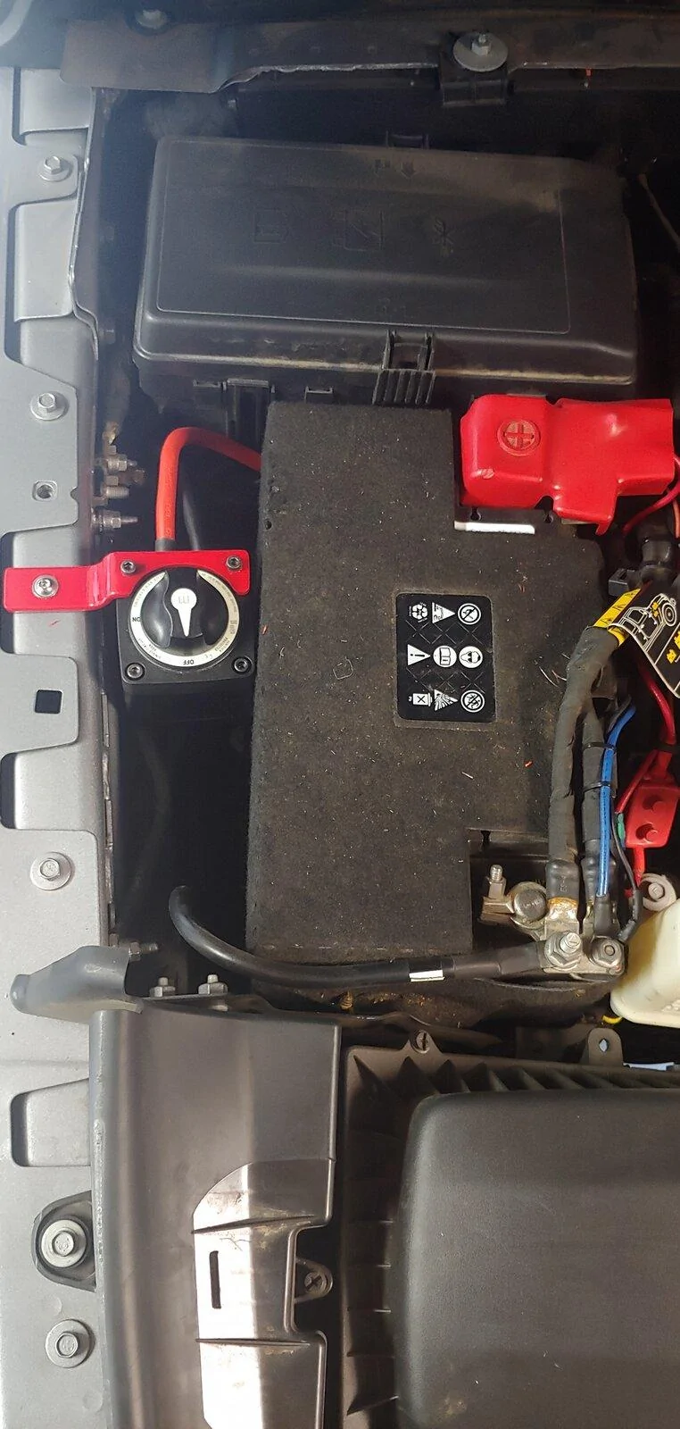

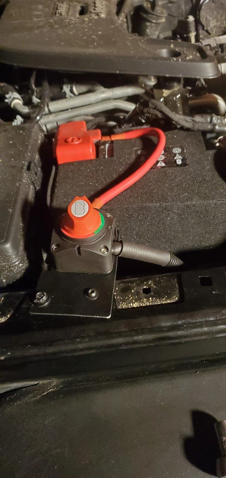

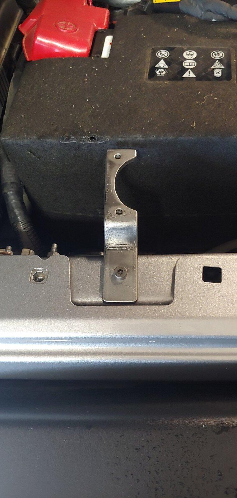

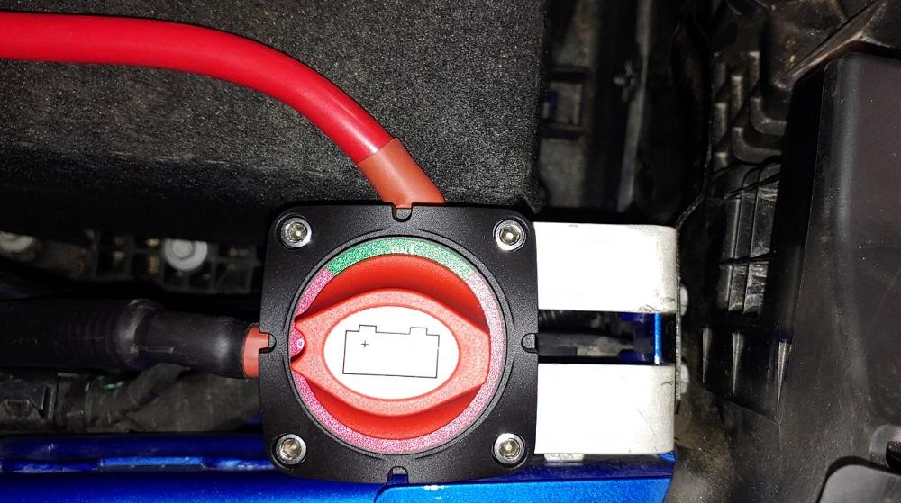

I have argued this point at length, that it is not necessary, but it does protect against accidental or malicious shorting of the terminals. So In the end I installed one.
Blue Sea Systems 500A constant, 900A surge, about $50, and I made the bracket.

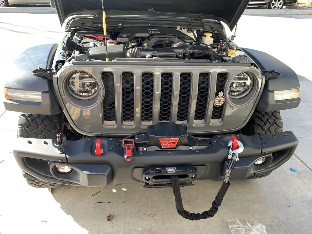

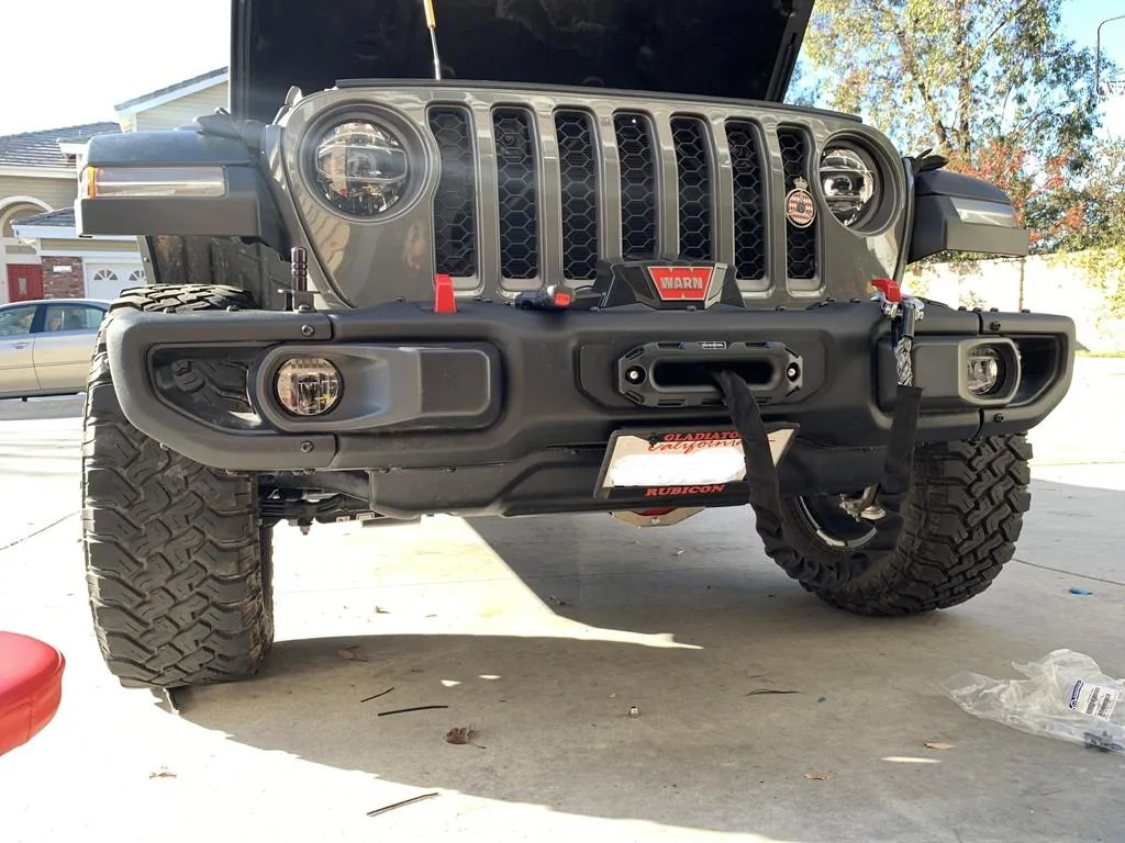

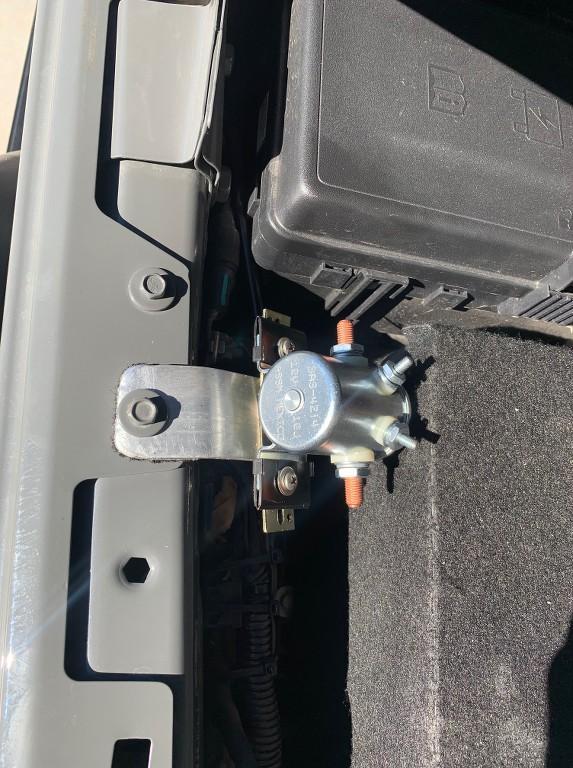

Ok, I got my warn power disconnect kit wired in. I used a piece of aluminum and an after market stereo stabilizer that were both in my garage. I just had to sift through some of my extra parts. This allowed me to slide the solenoid around a little to get a nice fit. I used some velcro fuzz on the bottom of the mount so it will not scratch the paint. The sting grey bolt comes from my fender pinch bolt which I happen to have removed because I just installed my Rock Slide Engineering step sliders which use the fender pinch seam bolt. I hooked up to Aux switch and it works perfectly. Here are some pics of the installation. It seems like a great kit.
PS. I could not get my factory 55 Ultrahook to work with the platinum rope. The end of the rope is just to thick for the ultrahook. I beat it up trying to get it in, but, it will not swivel once I seat it with the winch.... No way. I have to send it back... ugh...
Update: I just heard from Factory 55. The non-fitment happens sometimes. It is in their FAQ. They told me to pound down the thimble on the rope with a hammer to make it fit, and that is what I am going to do.
I also added a Maximus 3 license plate holder and warn epic fairlead
The Mopar low grill guard with my mopar lights will not fit even with spacers with the Warn Platinum winch. The head is too big for it to clear. I have to order the Warn low grill guard to get my mopar lights back on.

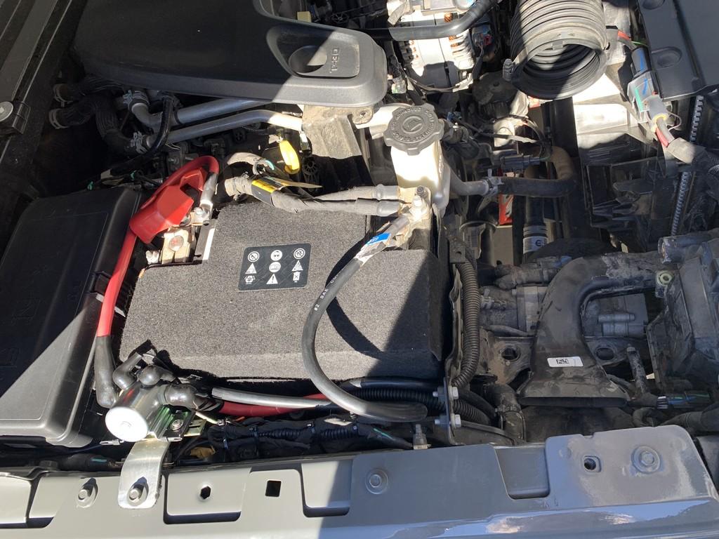

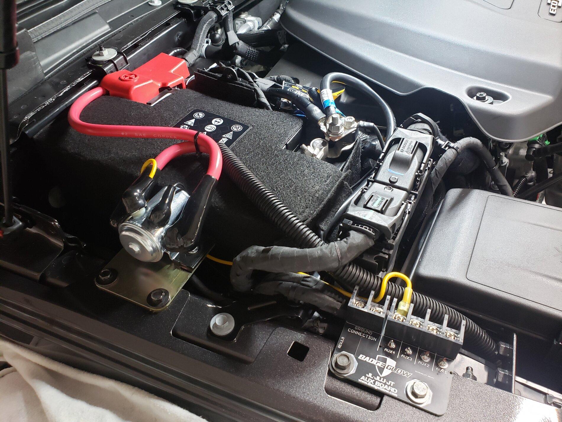

Came with my winch - SO SIMPLE!
Jeep Gladiator Winch disconnect switch 20201017_135923_HDR
Jeep Gladiator Winch disconnect switch 20201017_135945_HDR
180
29,526
35,127
I figure I'm going to have to get out of the truck, get dirty and connect the winch rope to something, and it's 10 seconds to open the hood and turn the switch. This came with the winch, and I don't have aux switches. ;)
I generally work with what I have - so if I had aux switches, I may have done it differently.
