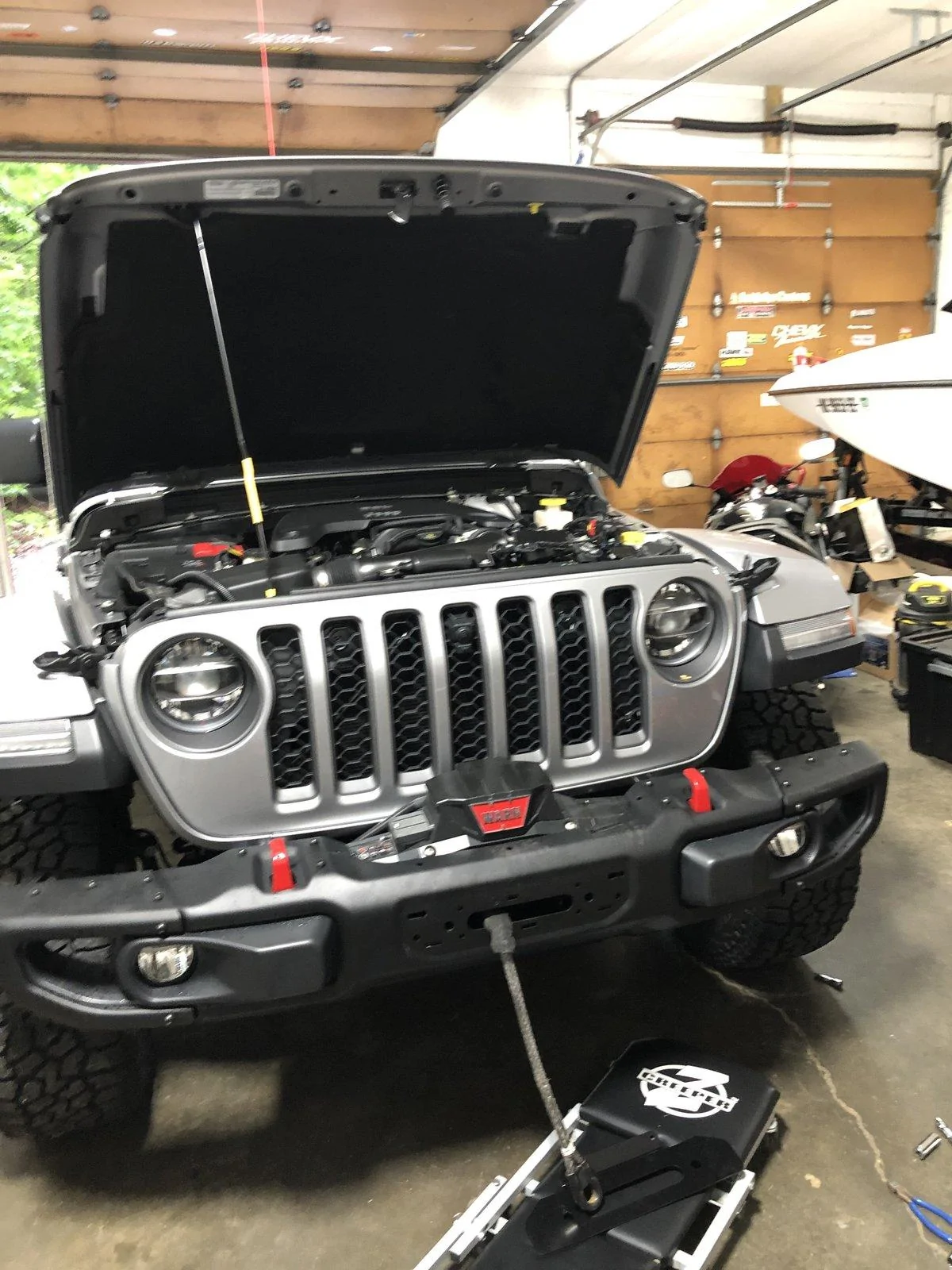

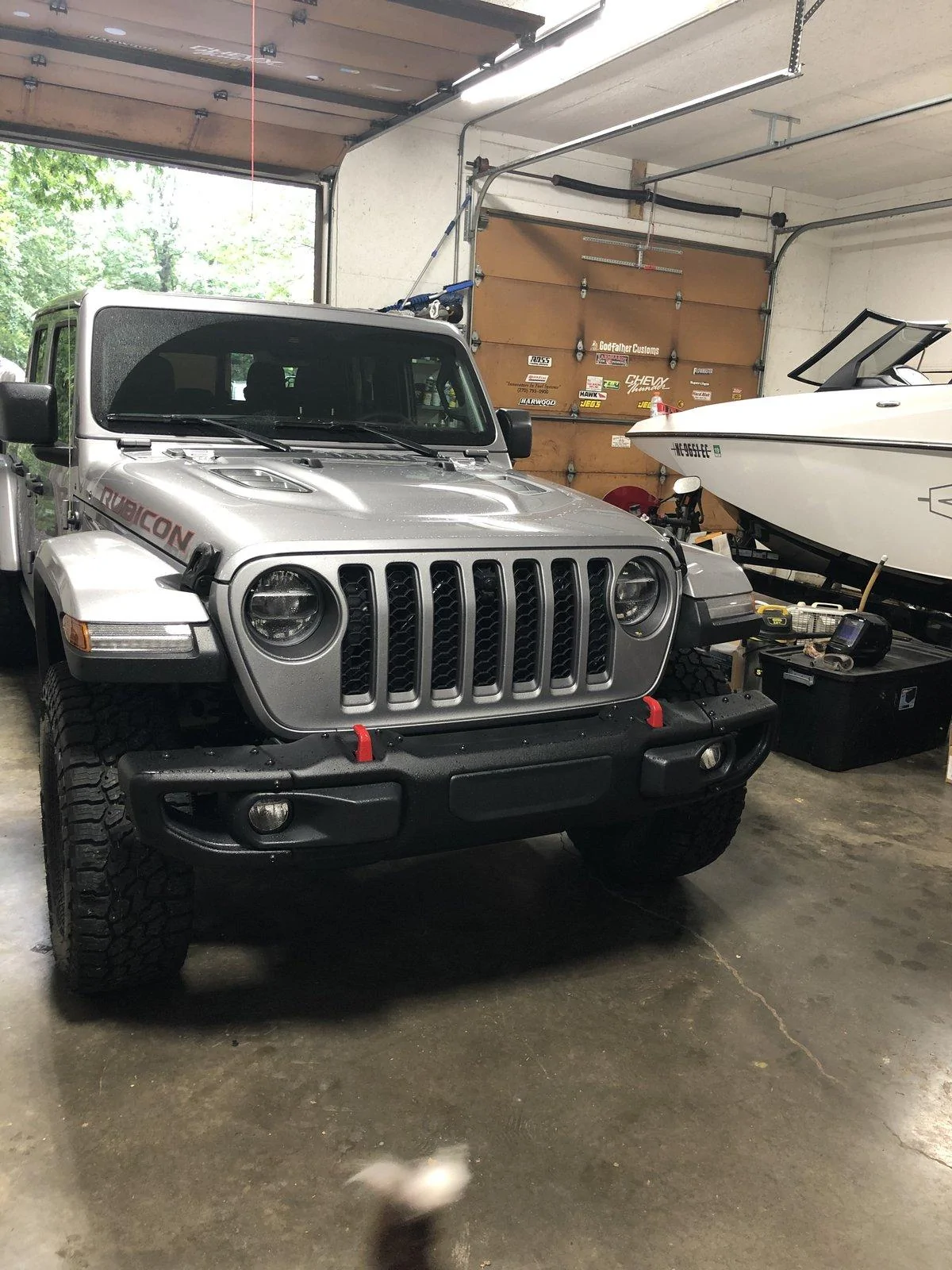

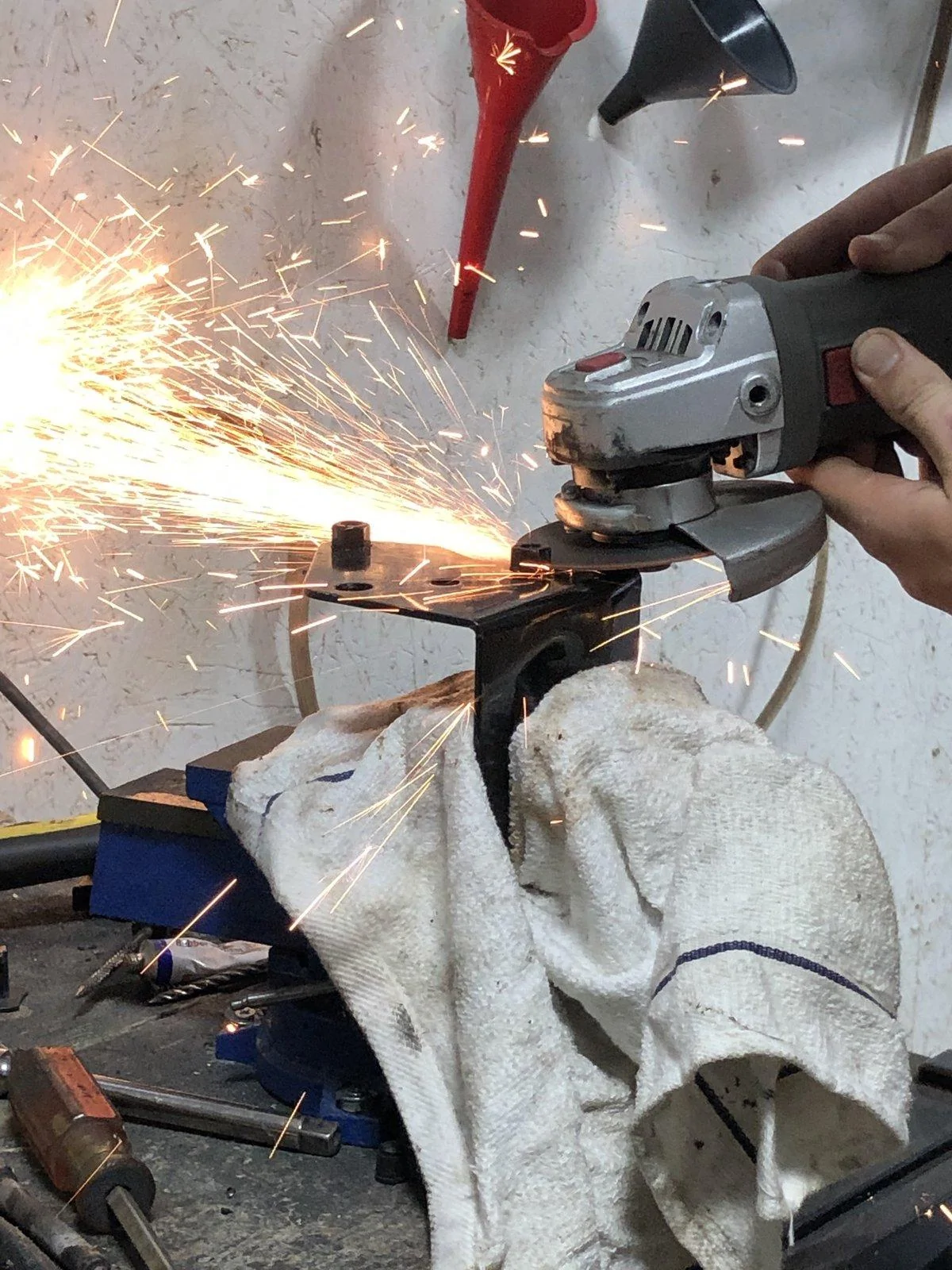

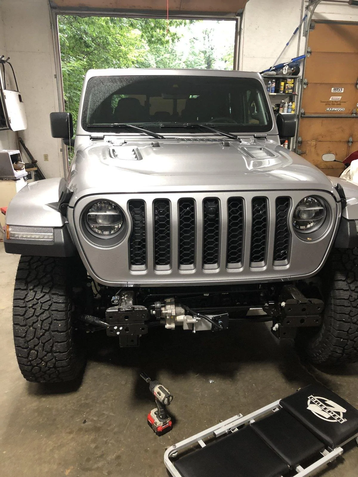

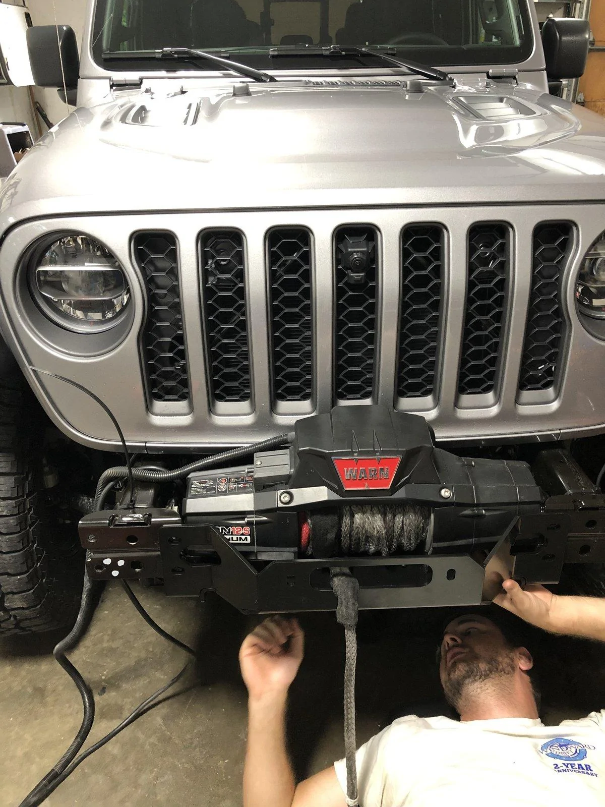

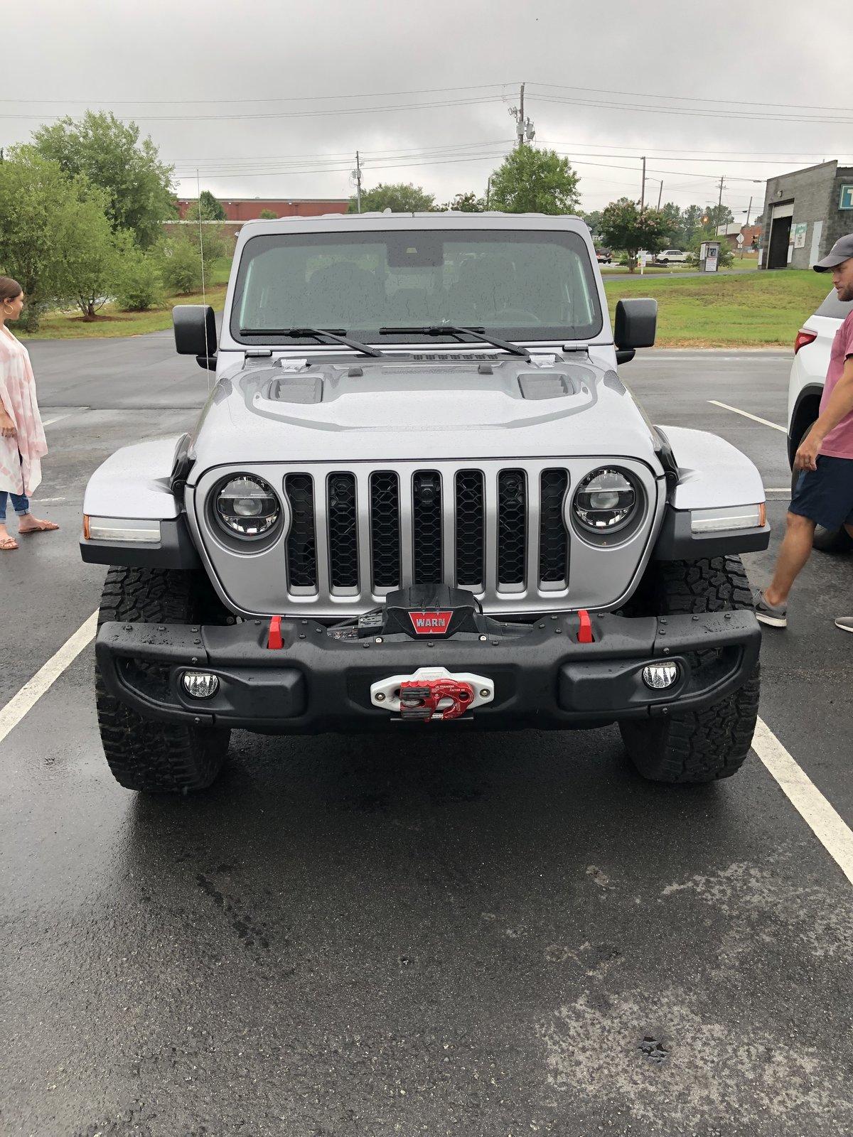

Just received my Gladiator launch edition on Friday and ordered the JL warn winch mount for the JT OEM steel bumper. I can confirm that it fits with a small modification. There is a bracket that has a thread in it for the OEM skid plate under the bumper, that bracket had what appears to be useless Threaded nuts welded to it and i had to cut/grind them off and paint the bracket to get the warn brackets to work.
However, it was a quick fix and everything else lined up. i am running a warn 12-s platinum and it fits.

And I also want to note that the bumpers do appear to be the same for the JL and JT, but there some obvious differences in manufacturing of the gladiator that have minor changes that require changes to make the JL stuff work. In this case it was that small bolt.

JL and JT front bumper area is identical. I bolted the Rugged Ridge JL winch plate from my JLUR with steel bumpers onto my JTR with steel bumper and it fit exactly the same, complete bolt on with no modification needed.
