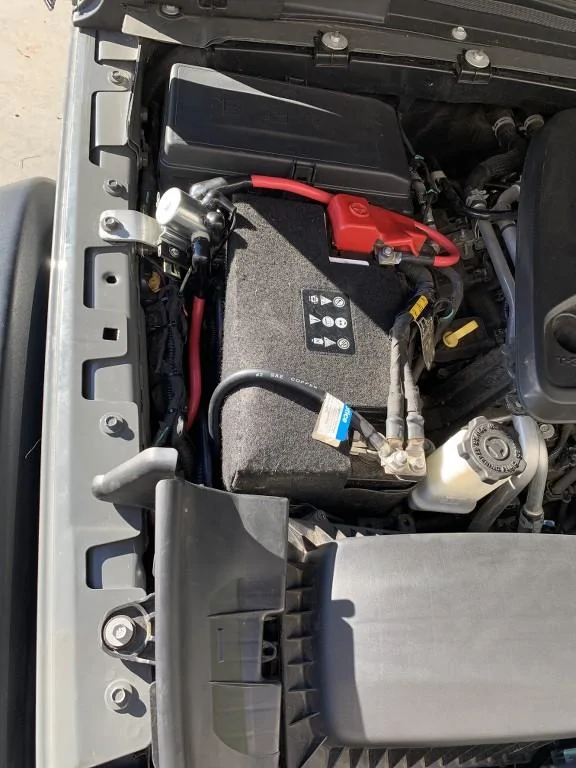

For me, Warn offered a power cutoff solenoid kit, so, I bought it. I hooked it up to my aux switches, so, I do not have to open the hood to power up the winch, like a cutoff switch would require. If the solenoid fails, it is pretty easy to bypass the solenoid. Just a couple of nuts.
Jeep Gladiator Winch Power Interrupts 2VdJve
Appreciate the photo. It looks like it will fit in there the way I plan.
I had the Warn Power Interrupt Kit installed on my last Jeep. It worked very well for the entire 15 years I owned it. The Warn solution works well. I was only hoping to find a solenoid with a more narrow width. I will probably end up with the Warn Kit again, configured as you have done.
