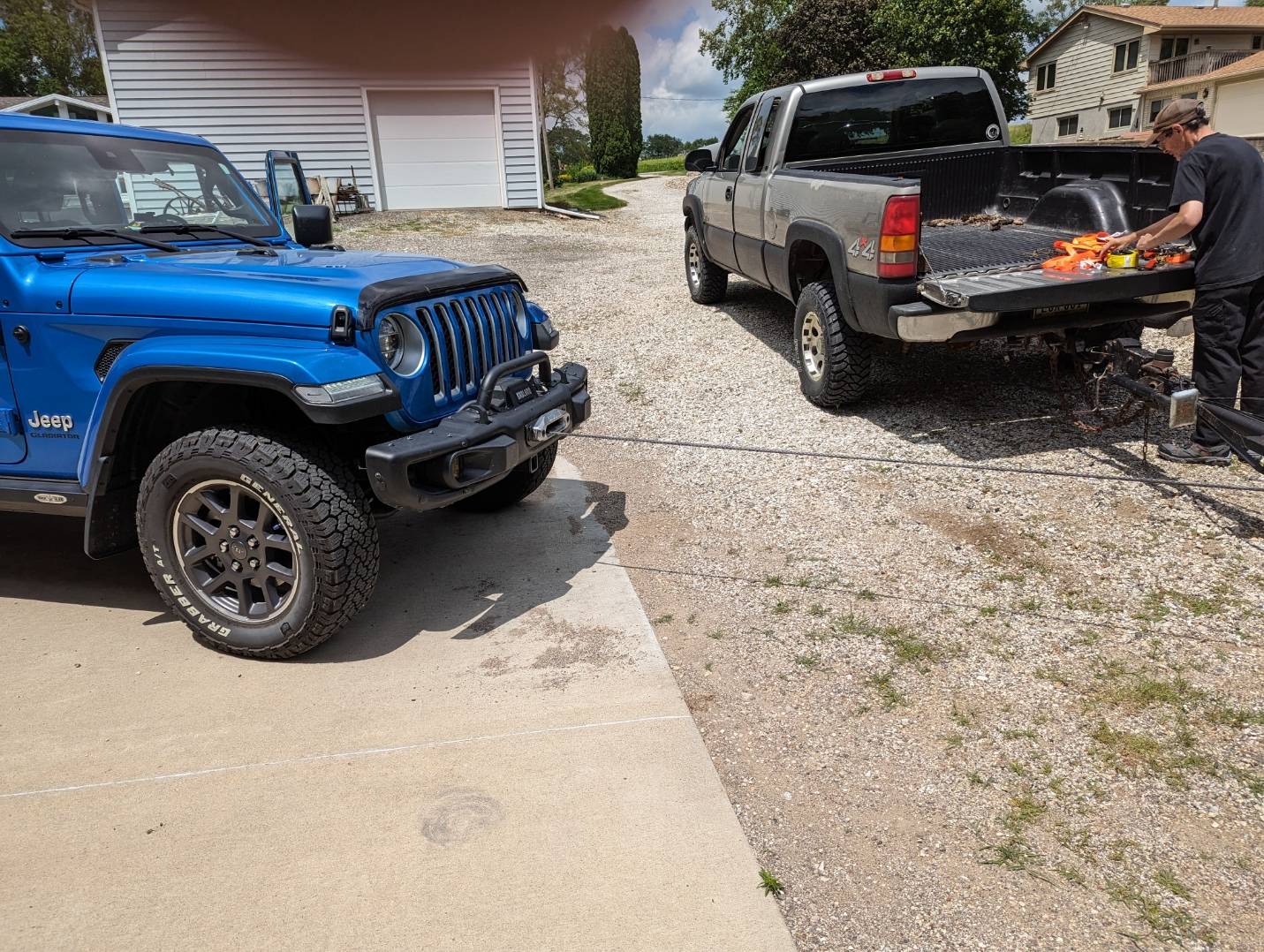

You've shown it's not a jammed rope (I had problems with my first use getting the rope all wound at one end and I almost couldn't unspool it manually, but it DID power out as I pulled)
Nothing to check short of taking it apart.
Same winch as you have....... mine pulls out easily when winch is in neutral.
Only used power out that one time when the rope wasn't spooled up evenly.
Jeep Gladiator Winch will not spool out under power PXL_20230625_192217121
