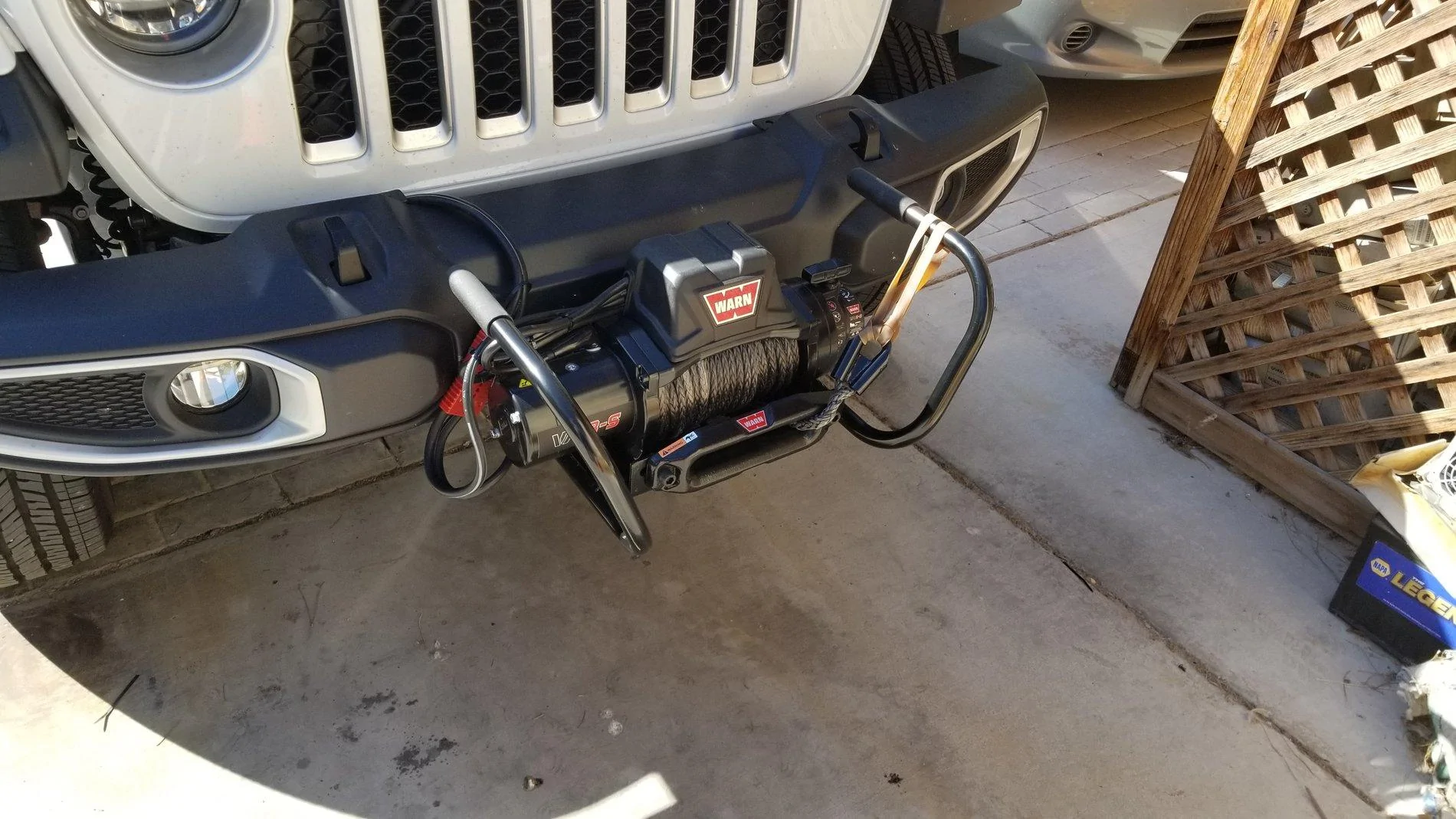

Curt has a front receiver and a winch plate for it. This is the route I went with mine. It took a few hours to install, but was not real difficult. I cut a hole in the plastic air dam to fit around the receiver. I'll be putting it back on after I'm done installing some lights. I'm not done, yet, I still have to connect the power under the hood. I also plan to add an auxiliary battery for the winch. I'm going to attach it to the frame behind the right rear wheel.

The receiver is a Curt 31086 and the winch plate is a Curt 31009. I installed a Warn VR-8S. The Curt receiver is rated for 9000lbs on a direct pull, so I went with a winch rated for 8000lbs. I got the winch with synthetic rope. The VR-8 comes with metal cable is a little bit cheaper.
