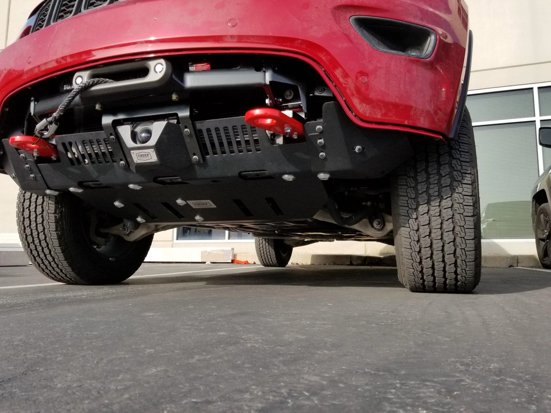

That's the winch i have on my WK2 Trailhawk. I haven't used it to pull anyone or myself out yet but everything works well and I like the option of wireless or wired control.
I like the winch bumper you have. If I were keeping my Wk that would be the route I'd go too. I've bashed my lower lip so many times it just flaps in the wind. That Chief lower lip looks great!

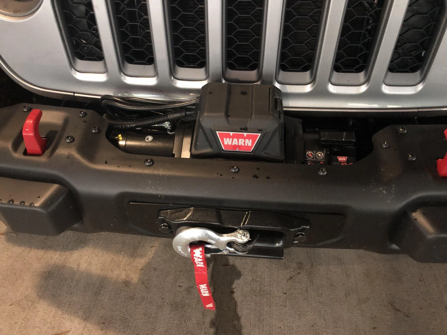

I just had the 12,000 lb Warn put on today. I will post pics. It is not the Zeon though...it's the one below that. This was 1300 installed with all hardware and labor. The zeon was going to be close to 2k. It had some chrome and better feeder plate but not worth the difference in my eyes.

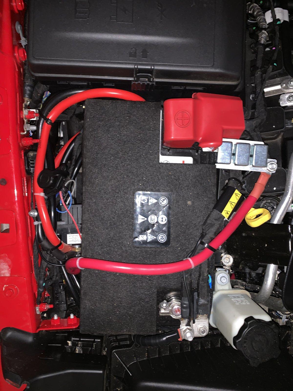

Use the battery inverter cables to move the winch controller under the hood. You will need to disassemble the controller box in order for it to slide between the battery and passenger fender well.

Hey @Sorbs Could I trouble you for a picture of where you stashed it?
I have a sneaking suspicion I probably won’t be able to do the same because of the genesis dual battery kit. It might work, but with a picture, or two, i could figure it out...
Thanks!
I’m going to run the winch wireless controller/hand held controller plug-in into the cab for a cleaner install. As for the winch relay, it is isolated and secured with tie wraps between the battery and fender. No possibilities of arc points either.
Having already done multiple waters crossings the battery platform seems to be water resistant from the bottom as well.
Compared to the “Badland” plastic enclosure, that normally would be mounted on top of the winch, this is more protective having the electronics being under the hood. Also, the Badland relay box doesn’t come with an O-ring so it really doesn’t lend itself to being very water tight.

awesome. thanks. it probably won't fit with the dual battery kit... but I'm sure I could find another spot for it. I do think it's a great idea to get it under the hood, away from that front vulnerable area. It also makes it look way more sleek. I wonder if you could even get some kind of cover to make the winch completely disappear.
