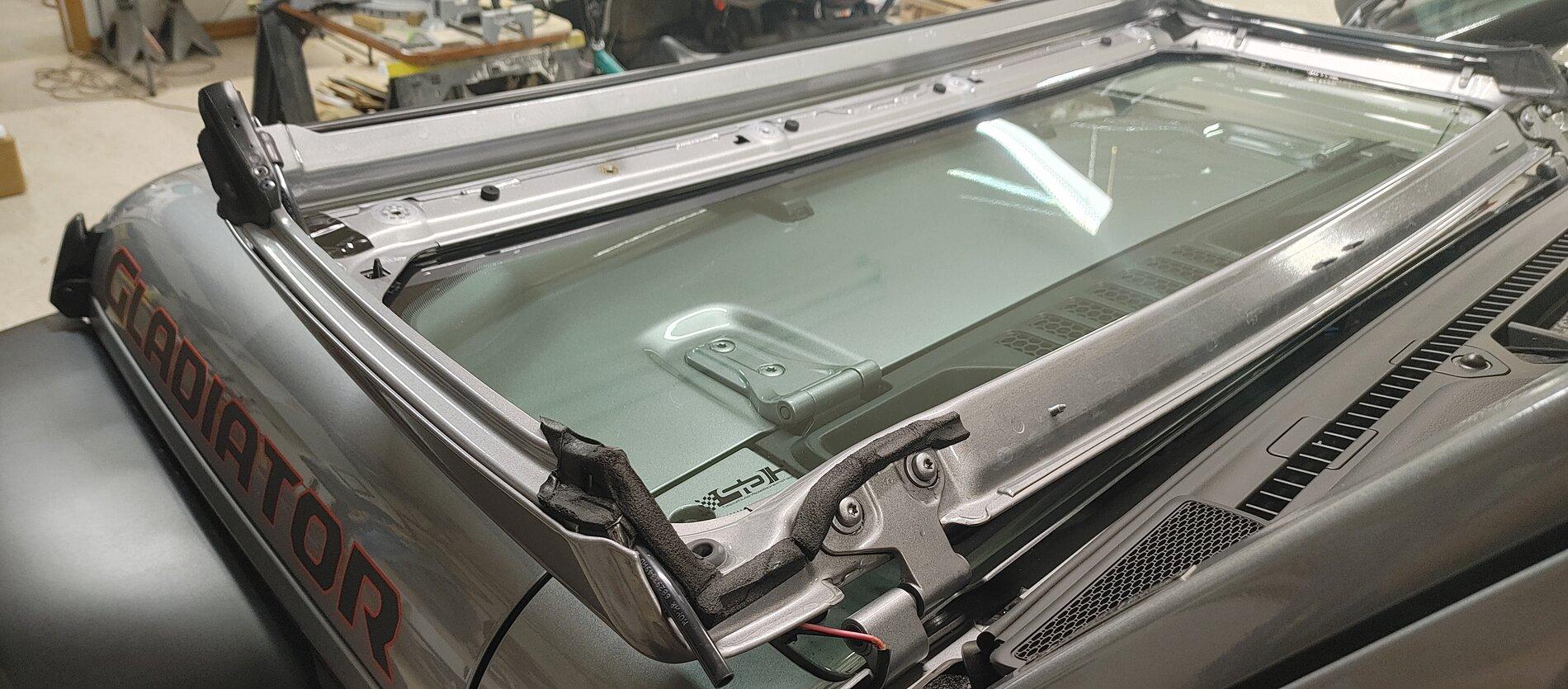

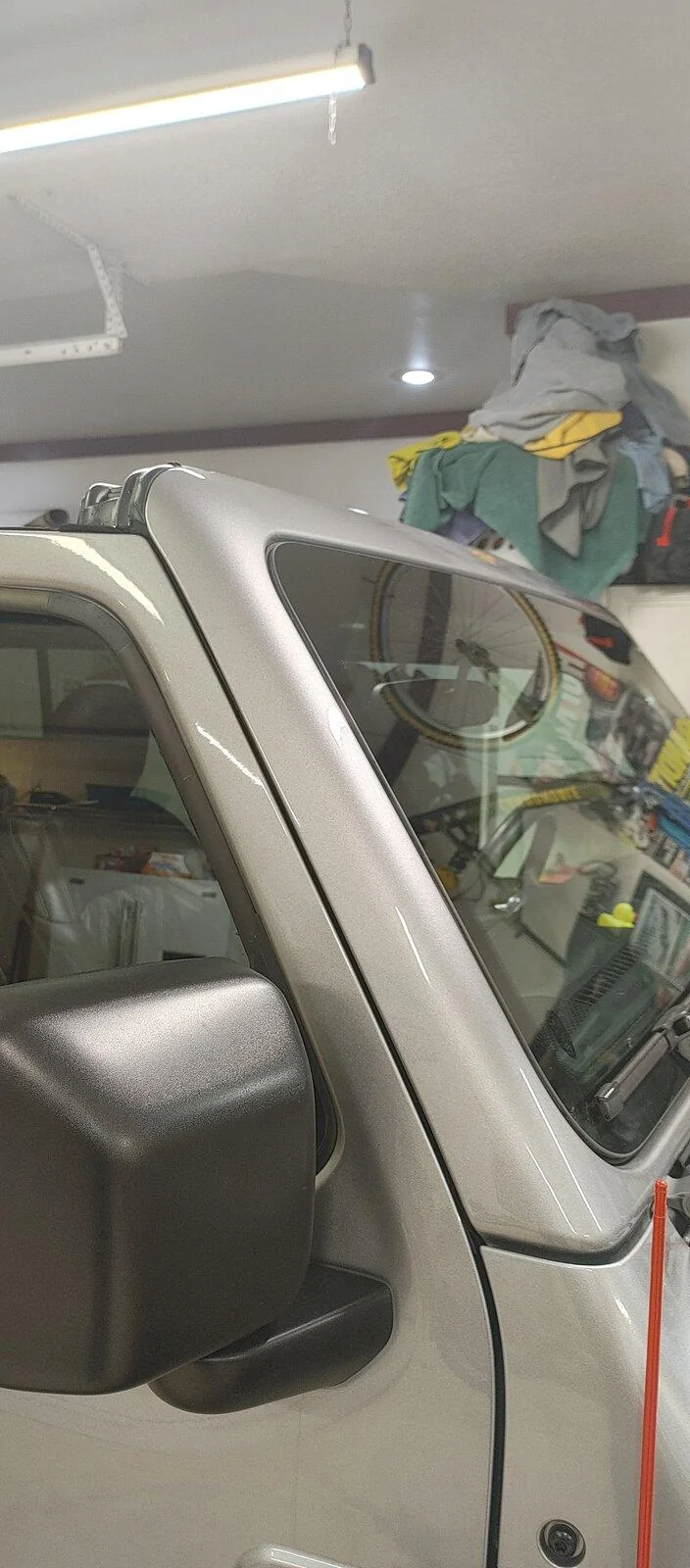

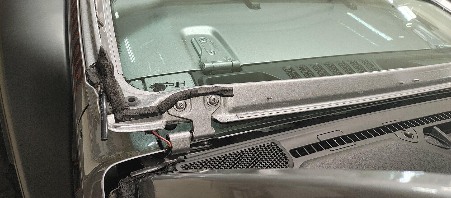

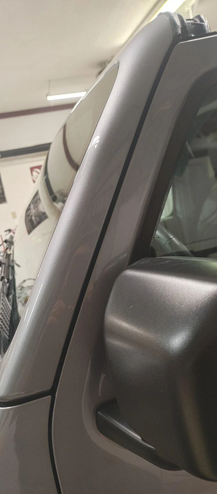

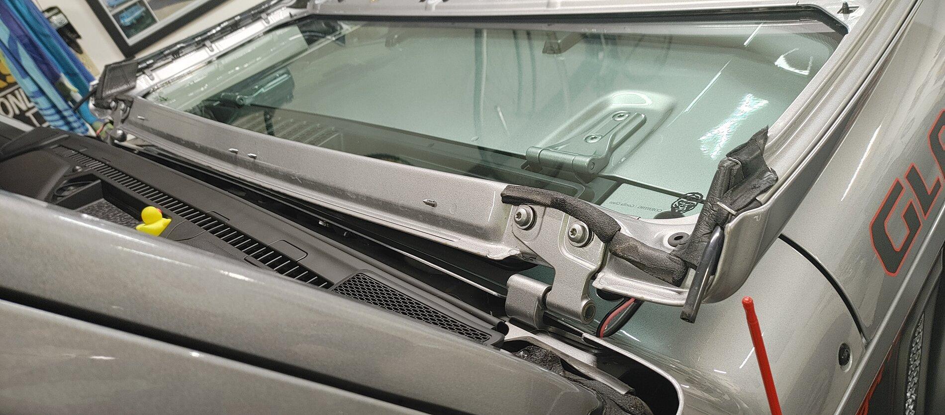

So I was looking around over on the JL forum and came across a post of a person who fixed their wind noise by adjusting their windshield hinges. Well I took a look at mine since I have wind noise. The windshield on my Gladiator was not even close to lined up with the frame. It was a 3/8th of an inch out to the pasenger side and 1/4inch low on the drivers side. There is a ton of play in these hinges. Once adjusted, I am seriously pleased with how quiet it is.

When you say ''play'' were the hinges not tight & able to shift bit, on their own ?

If you loosen the bolts in the picture there is about 3/4" movement up and down and side to side. The hinges them selves have about a 1/4 inch movement side to side. I was able to get my winshield with a good gap top to bottome and an 1/8 th overhang on each side.

You wouldn't happen to have before pictures would you? To show the difference in before and after.

There's a lot of pictures here. Can you specify which bolts you adjusted in order to correct the issue? Thanks.

In the pictures with the windshield laid down. It is the two bolts with the strip of foam over them. There is a set on each hinge.
