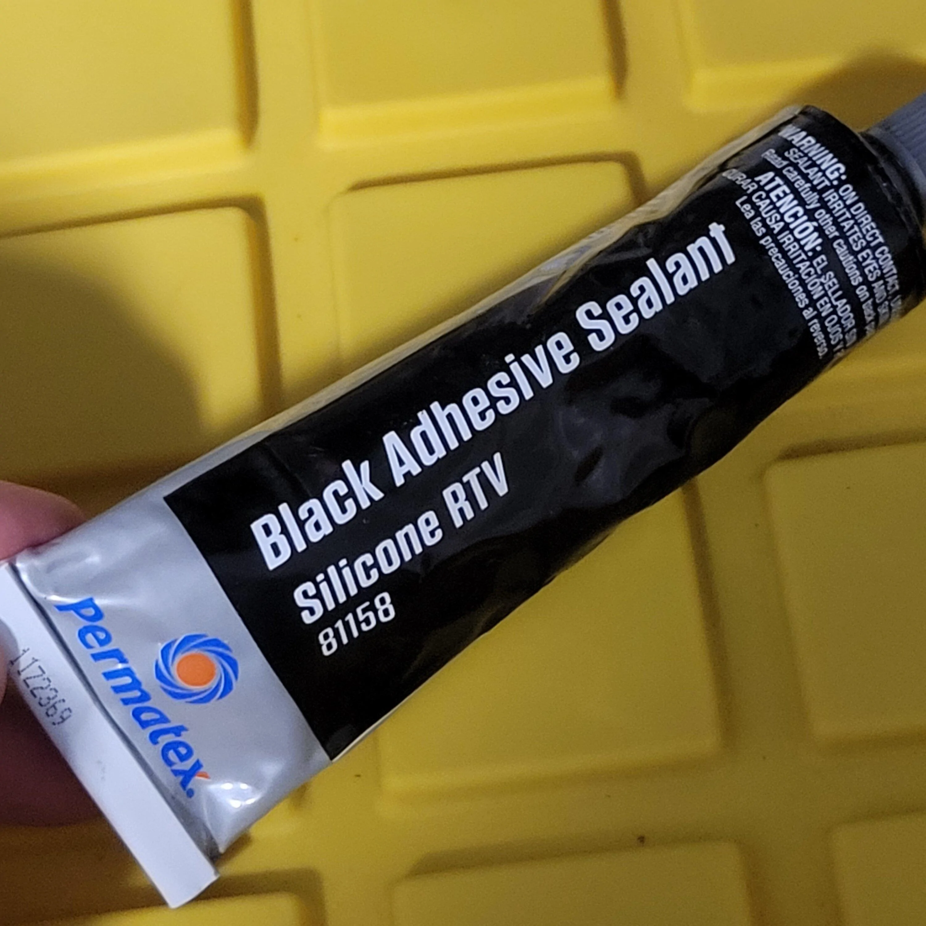

If you end up having to drill, get some of this. It's what you use to seal firewalls after running cables to/from the engine bay and cab.

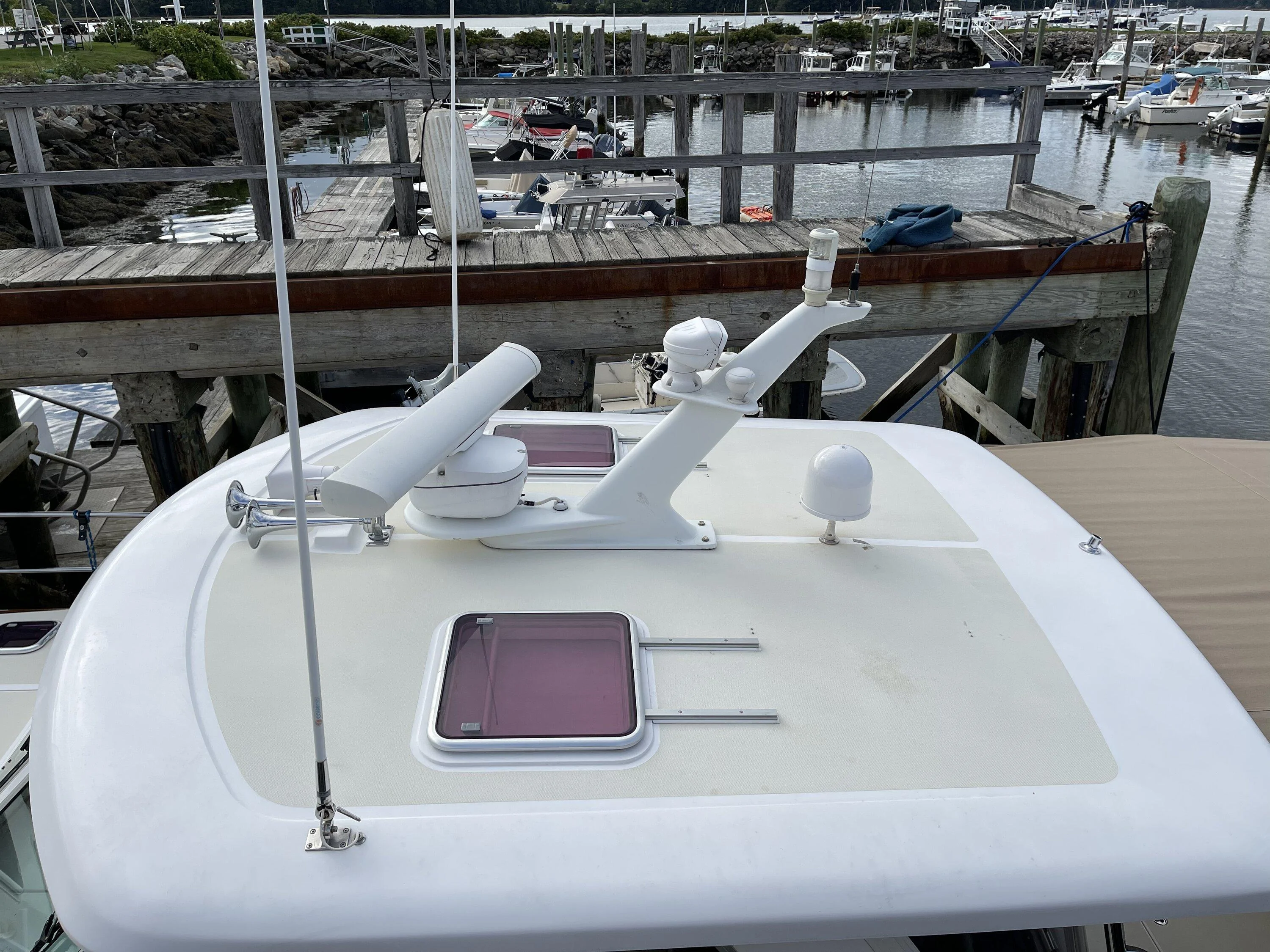

Waterproof through roof fittings are common for boats. These have been on 11 years and no leaks yet
Jeep Gladiator Wire Pass-thru for roof 5F2F360A-AC44-46D0-A28B-8F216DAE6D1F
While that might be the case, I would suggest finding an alternative route that does not involve permanently modifying your roof.
I was actually just looking at a West Marine catalogue. Some possible options there. I've got to drill the fiberglass for the rack regardless.
