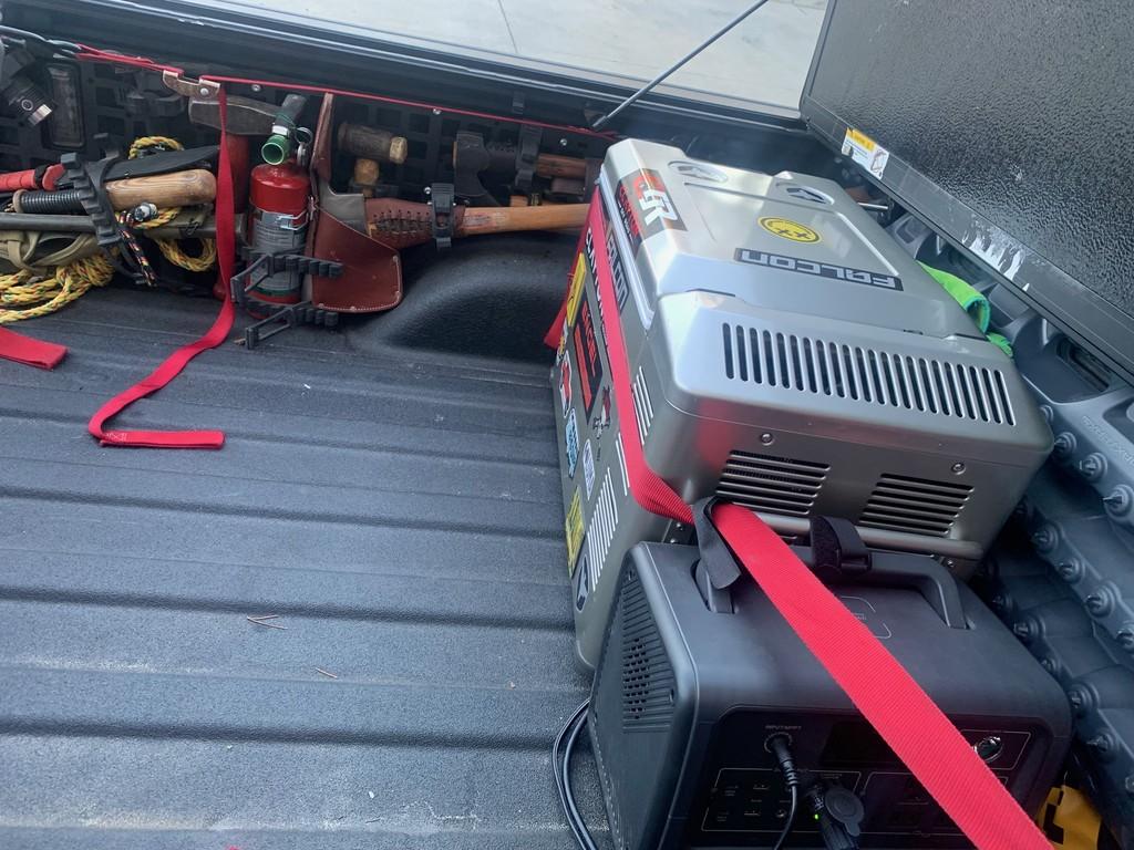

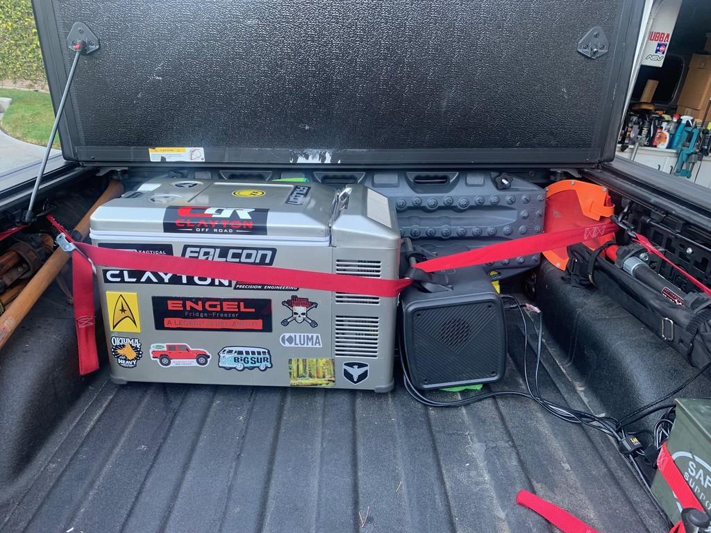

My setup needs to be portable and removable. I am running an Engel 35 with the new BLUETTI Portable Power Station EB70S 800W (Peak 1400W) Solar Generator 716Wh Backup LiFePo4 Battery - 2500 cycles or so. I have the fridge running full time with a portable setup because we still need the full bed once in a while. I plug in both the AC and DC into the Engel - using the AC plug in the bed. When the AC is running in the bed, it runs both the Engel and charges the Bluetti battery (using 200 watts for battery charging and 30 watts or so for the fridge). When the truck shuts off, the Engel switches automatically to DC. I really like the setup and have done some heavy 4wheeling and "badge of honors" with it already. Here are some pics.
Jeep Gladiator Wiring for new fridge 7AaamT
NICE! I like that setup for sure, I'm looking for something removable, too as I don't want to take away the purpose of buying the Gladiator in the first place lol. How has that power station been treating you? What made you decide on that particular model over other brands?
