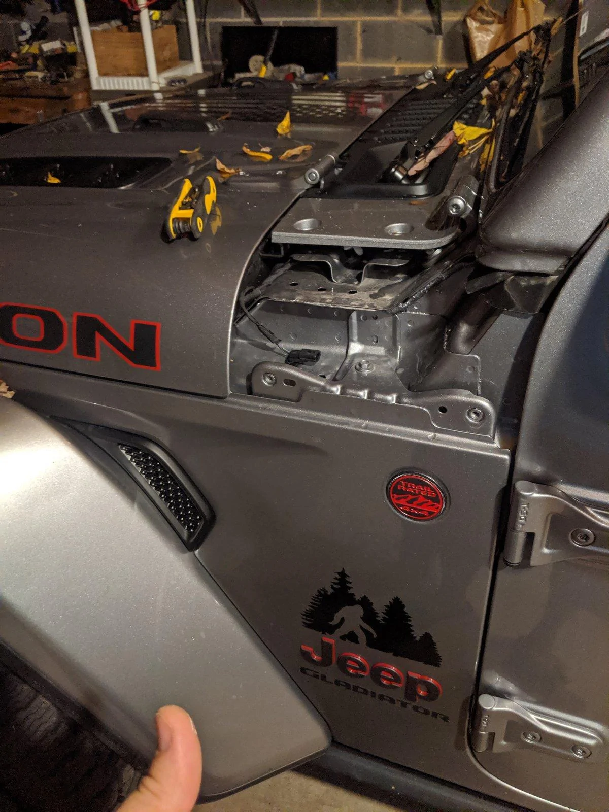

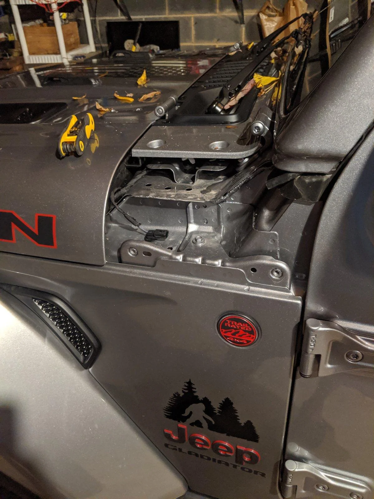

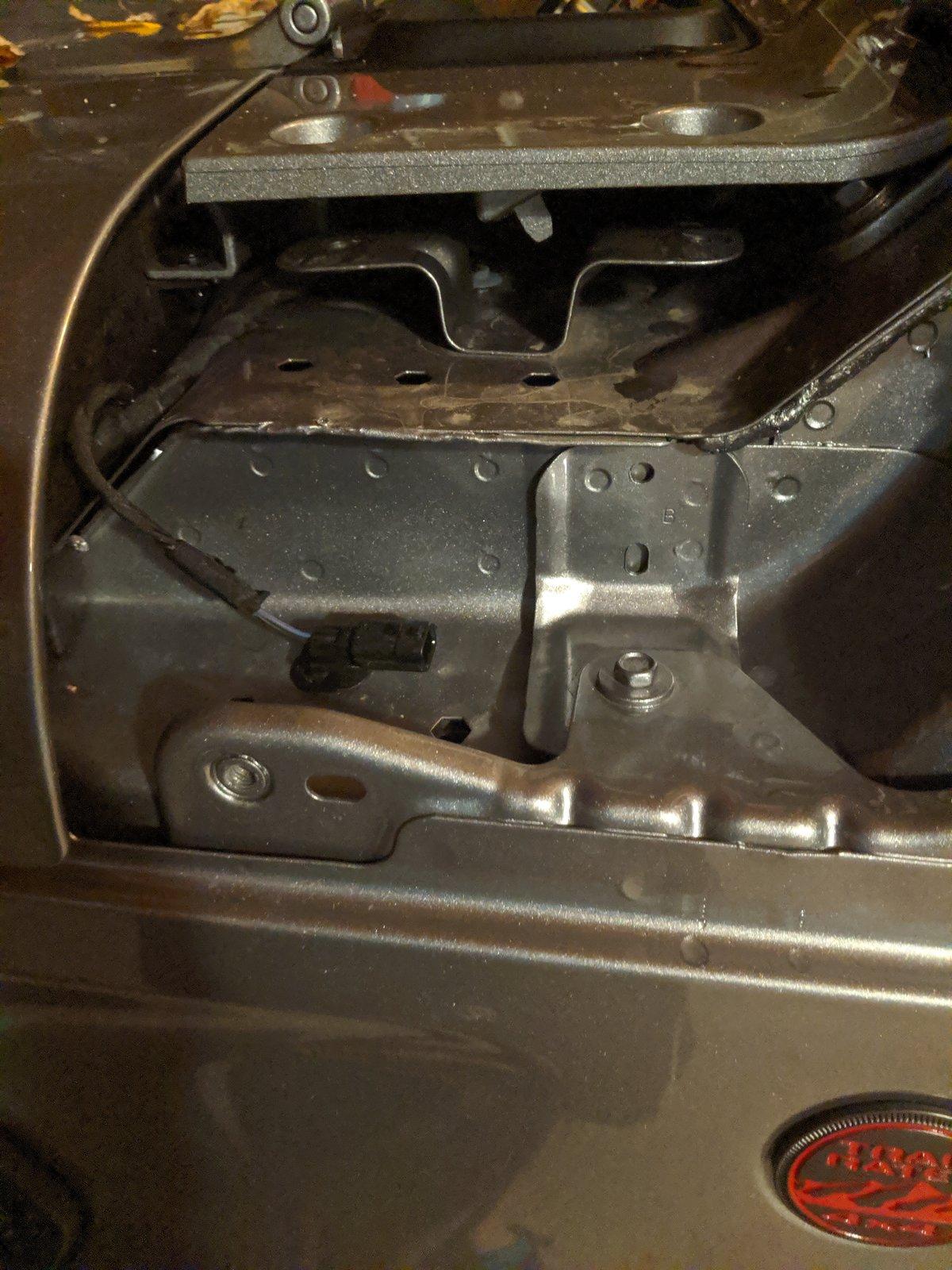

Hello All,
I just got a set of Dee Zee A Pillar Cowl mounting brackets for fog lights on my rubicon. I popped off the driver side cowl to take a look at how I was going to wire up the lights to the aux switch wires that are on the other side of the engine compartment, and WaLaa... There is a wiring harness underneath the driver side cowl with a wire coming into the plug, and no wire coming out of the other side. It looks like it was put there so we could hook up aux lights here on the A pillars easily. am assuming this maybe attached to the aux switches. Does anyone know anything about this wiring harness? What its for and/or where it goes?
I can post some pics if necessary...

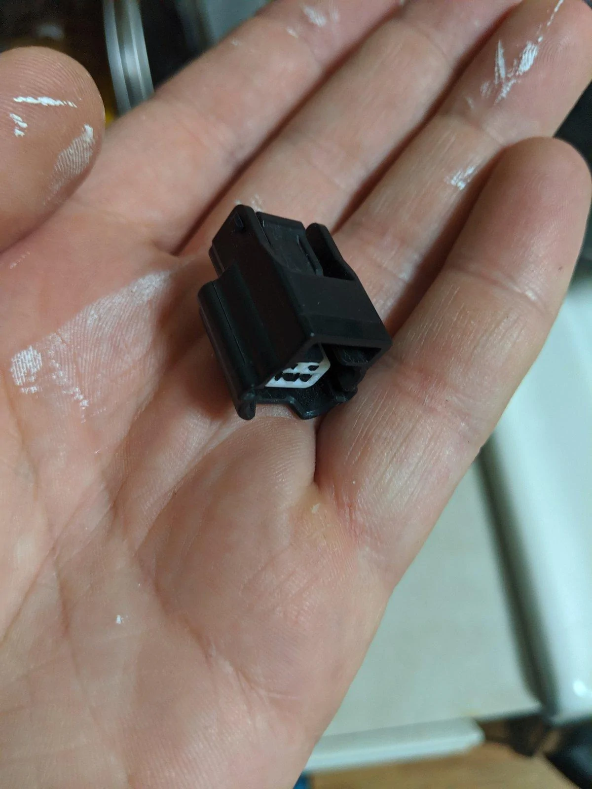

Here are some pics of the harness... And a pic of the other end of the plug that goes into it... It looks like there is one black and one blue/red wire going into it

That plug is for the adaptive cruise that is mounted to the rear wiew mirror on the windshield. If you dont have that option, it is just capped with a plug. Not sure if the power going to that area is alive or not on non- acc equipped jeeps

OK. Awesome. thanks for the info. I thought maybe it was one of the aux switches for A pillar lighting but I checked resistance from it to all the aux wires with no luck... and also had no voltage to the wiring.... I dont have the advanced safety package so it must have something to do with that. I ended up just wiring up my lights to the aux switch 1 wire in the engine compartment... and all is well.
