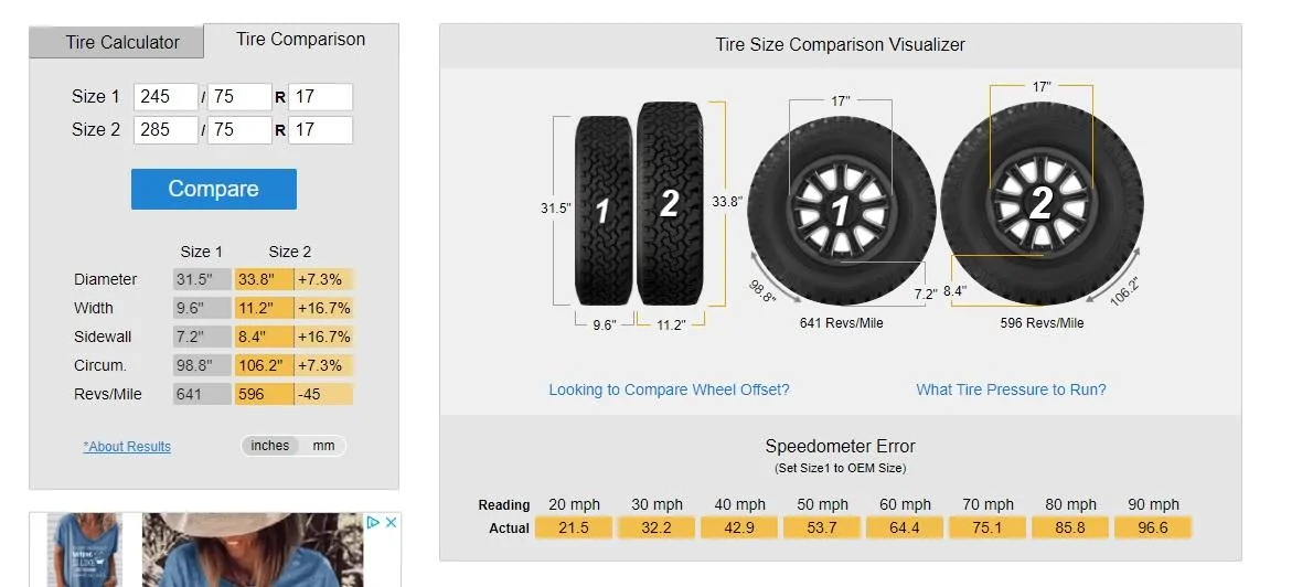

I cant get the idea of going back to stock tires out of my head...Am i just dumb to think this would be worth it?
I keep reading on here, and other places, that the stock tire sizes are best for towing since they maintain the power for the max town and dont add any extra weight or anything. And, after looking at pictures, they dont look awful with the 2in lift and stock tires...
Am i way off here or would there be a benefit to going back to stock tire size?

Just remember that the stock tires on Sport, Overland are flimsy as hell with paper thin sidewalls. Those are not ideal for towing, or really for any other use as they're more prone to flats.
The 32-33 inch size is ideal, but I'd still want a LT-D or LT-E tire personally if I was going to tow (which I do a lot of myself too).
